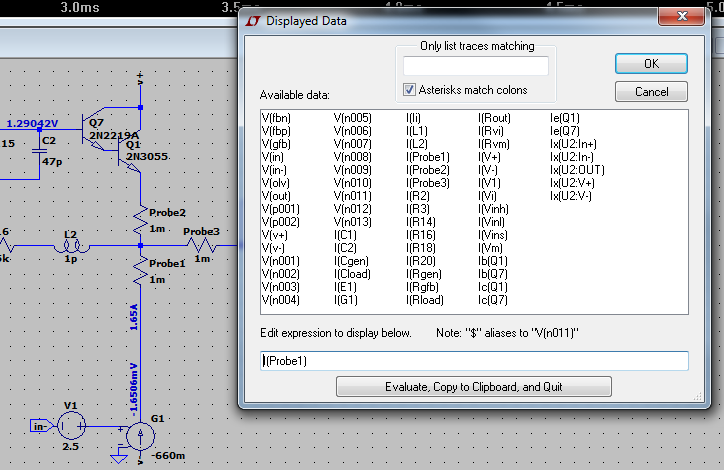

3) the trick on attaching voltage labels by clicking the net in question after a .op run is really neat, thank you for that tip! is there a way of doing the same on current, for example labeling some Ic's and Ib's?
Not that I know of. I even had a look see but couldn't find anything on it.
Worth knowing though is that you can attach voltages dirsectly from a transient analysis run. Having run the sim just right click an empty space on the circuit and navigate to <view> and select <place .op Data Label> which allows you to place a voltage on the diagram.
But currents... I don't think so. The best you can do is just write them down and add them as a text comment on the diagram... of course they are fixed and non dynamic then.
Like this? Right-click the label and edit the item to show, in this case I(Probe1).
Brilliant, thank you 🙂
What FdW is saying is this...
1/ Attach your voltage to the point you actually want to monitor a current. Just as we have already covered before.
2/ Now right click the attached voltage label and enter I(x) where x is the component reference the current would relate to. Here we are changing the voltage on R24 to a current in that line.
3/ When attached, the currents are displayed and these do indeed change dynamically as you alter values and rerun the simulation.
