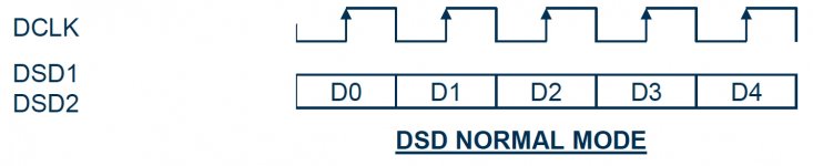

If DPLL bandwidth needs to be set to a high value, it means there is too much jitter from AK4137 and its DSD I2S signals as seen by the dac chip. It is likely also a problem that AK4137 DSD clock is inverted. If you fix those things it will sound much better, and better yet if you do the other things I mentioned.
The easiest way to start making some progress would probably be to either hack into the AK4137 I2C register and invert the DSD clock there, or add a one-bit hardware inverter to do it. That and very very short I2S wires between AK4137 and the dac, each signal with its own ground conductor. Using long wires with clocks and I2S data is probably asking for trouble.
First though, you should verify if AK4137 DSD clock is inverted or not. You will need to use your scope to look at the I2S signals. The DSD clock and one of the DSD data lines should be enough. Please see the attached diagram below. It shows the DSD clock on top and DSD left and right channel data below. What the diagram means is that DSD data changes state from 0 to 1 or from 1 to 0 around when the DSD clock is going from high to low. DSD channel data should be unchanging when the DSD clock goes from low to high. That's what its telling us. Typically, AKM devices default to the channel data changing state when the DSD clock goes from low to high, which is inverted from what ES9018 would be expecting. That could easily cause some problems with DPLL locking in. Noisy/jittery I2S signals from AK4137 would cause similar problems. Look at the waveforms with the probes and probe grounds connected to AK4137 board, then move the probes and probe grounds to the dac board. How do the DSD I2S signals look there as compared to how they looked at the AK4137 board? Probably not very nice looking square waves any more. If I2S signals are distorted, can't have junk like that in dacs and expect good sound.

Mercury is probably DC coupled (I think it uses a servo rather than AVCC/2 or AVCC/x for I/V input offset). Your old output stage may have been AC coupled, not sure.
You could try disconnecting Mercury from the dac and then measure at the analog outputs of the dac chip instead. (Sabre dacs will operate in voltage output mode if no I/V stage is connected.) If you still see a similar offset effect in DSD then my guess would be that BCLK for DSD is being inverted by the AK4137 (AKM default mode), which then might be causing ES9018 outputs to offset in sort of a quirky way. Looking at I2S signals going into the dac chip with a scope should quickly tell if BCLK (DSD_CLK) is inverted, as explained sometime previously.
If the clock is inverted, and if it is causing a dac output offset, then the fix would be to correct the BCLK inversion. Best way would be to go into AK4137 I2C registers and change the DSD BCLK inversion bit. 2nd best way might be to invert BCLK (DSD_CLK) with a hardware logic inverter IC that only is in the circuit for DSD mode (Otherwise the signal would be inverted for PCM and cause other symptoms).
