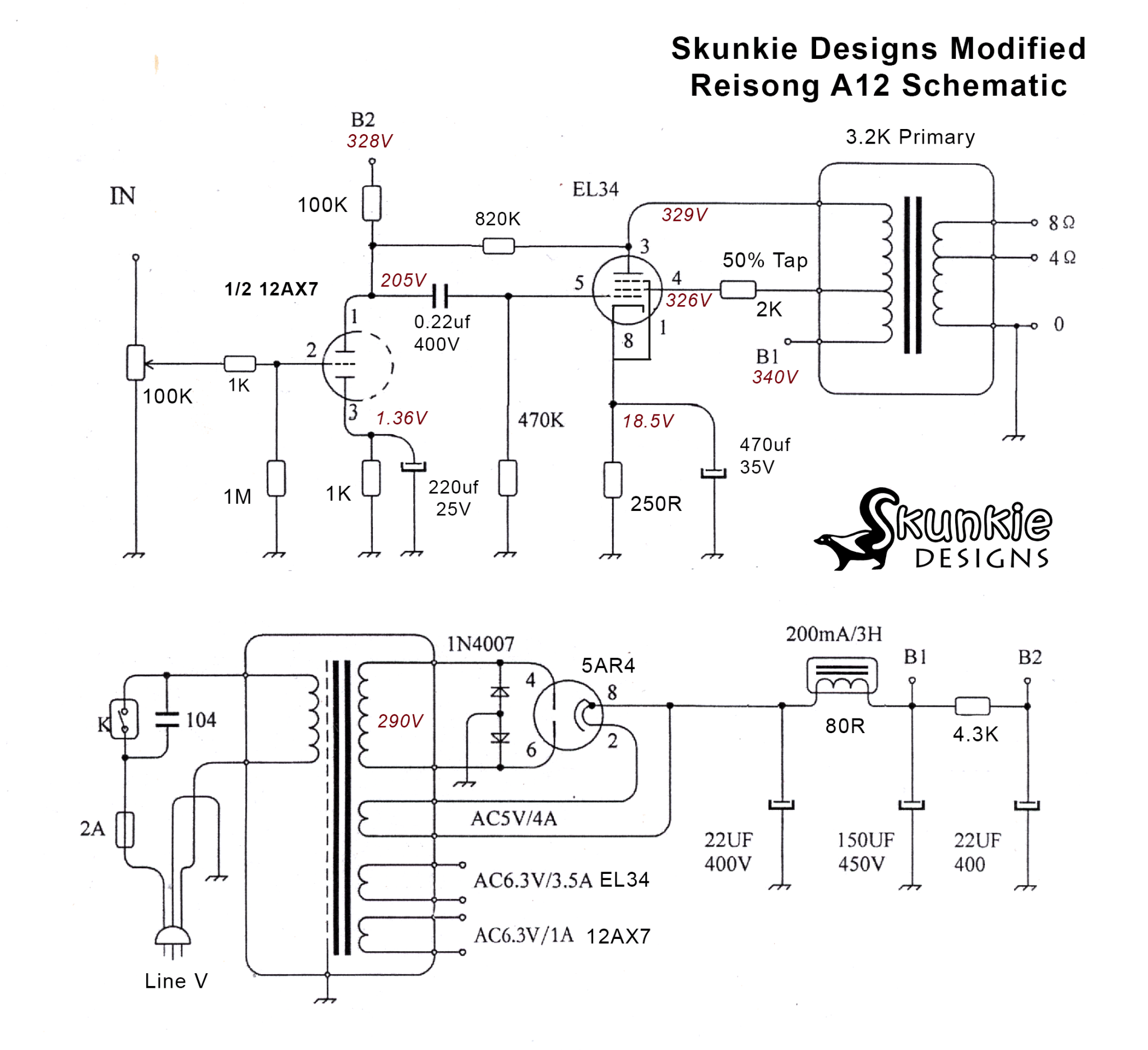

@grovergardner I would appreciate if you can share how to fix this. I've just posted the schematics for the amp. Remember I understand almost nothing about this, so the more specific the better so I can just go and do it.There's no feedback around the output transformer so the damping factor is probably terrible.
How certain are the output plate and screen voltages? If you look at the current flow from B+ to plate, from highest to lowest my expectation would be decreasing voltage from B+ to screen to plate.

Meaning , say, PP EL34, a reasonable OT, at least 20W RMS, overall NFB, etc.
But this SE 5-8 W amp (tops) requires a very efficient speaker (a Klipschorn would be perfect), even with that funky local NFB very important OT is outside the loop, damping will be very poor, it needs a KILLER OT just for reasonable performance.
No surprise it sounds poorly.
Triodes can get away fine with similar designs, but ... A Pentode? ... EL34? ... and no adequate NFB to help it?
Its problems are WAY beyond coupling cap replacement.
Lots of iffy choices in that design.

@JMFahey 🥵. You are most likely right (I don't say 100% because I understood half of your comment, hehe). I just remembered one thing though. No idea if this is important either. When I did the mods, it was specified to use a 5AR4 rectifier tube and I have a 5V4GA in there. Could that be another issue that could fix some of it's problems? Oh, and I'm using Gold Lions KT77 instead of El34s as well.

The amp has local feedback between the output tube and the driver, and that presumably lowers the output impedance to some extent. You could add global feedback from the output tap to the driver cathode, but you'd need to have a scope and some other tools to make that work. It's not something you can "ballpark" without possibly making things worse. ;-)

Well, now, a 5V4 will drop a good bit more voltage than a 5AR4. Anywhere from 10-30 volts off the B+ in this amp. And every volt counts here. That's why someone asked if you've checked your own voltages against the schematic. A 5AR4 might well bring the performance up to a tolerable level. I would certainly try that.

If I were to attempt a simple mod of the design, I'd remove the driver stage's cathode bypass cap, and probably increase the anode load resistor to 150K or so, but a more effective change would need for feedback application to be moved from the driving valve's anode to its cathode. Not trivial because DC conditions change (current from the feedback resistor significantly effects driver bias) and also not as well focused (existing feedback path puts it at exactly the best place, around the output valve).
The issue with the existing feedback path is that it heavily loads the driving stage, rotating its loadline very far clockwise (effectively adding another parallel load equal to the feedback resistor's value divided by gain of the output stage plus one), reducing its gain and increasing its distortion. On balance, I'd guess that degenerating the cathode and moving idling point up and left would be net positive, but not a panacea.
Maybe interesting, O. O. Schade did not propose this type of feedback - his original paper of 1930 used series applied feedback over the output stage, possible with transformers, and didn't have this liability. Someone somewhere in the recent (?) past misunderstood the distinction and his name got stuck to the current scheme. But, not his fault.
