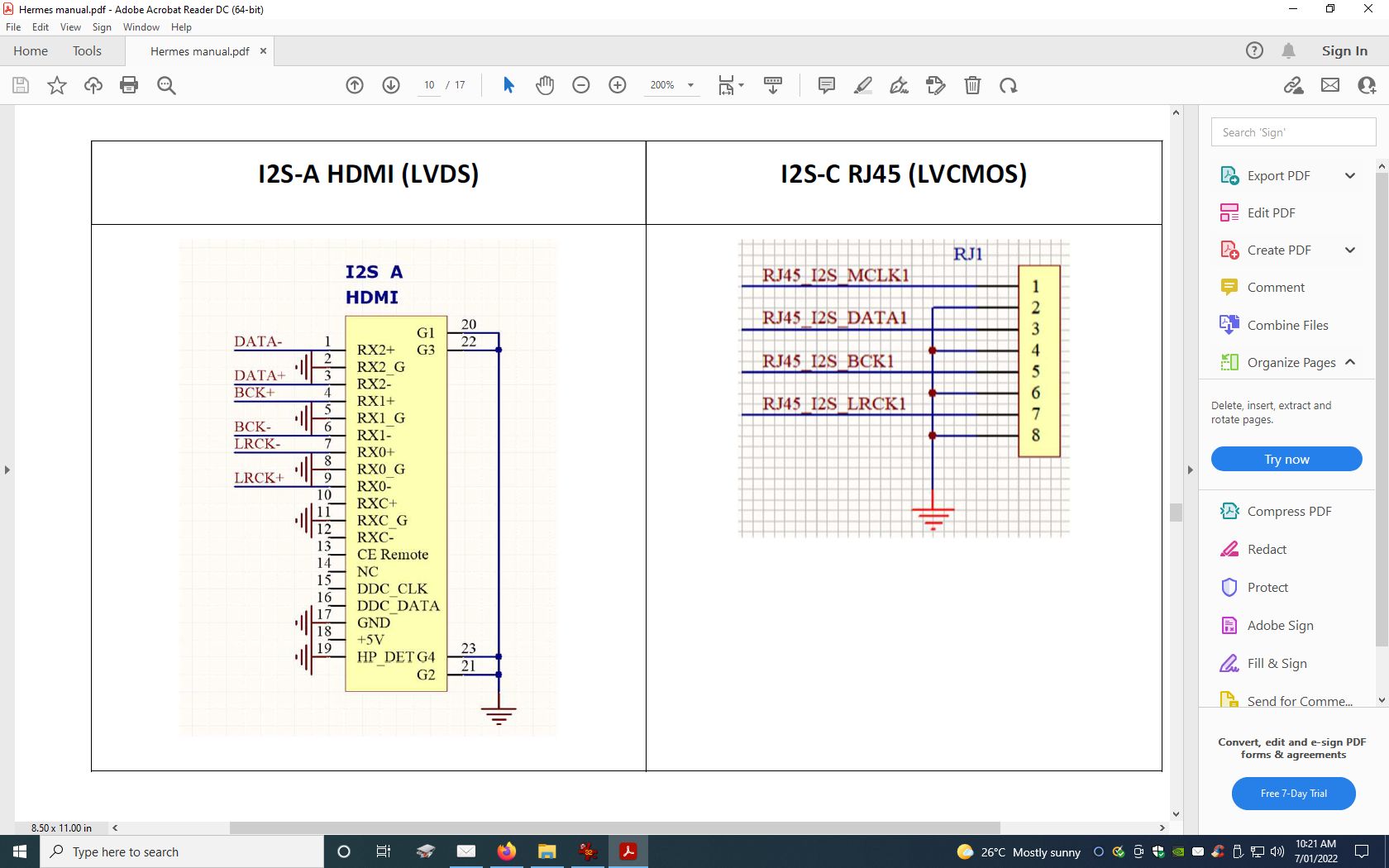

Hi all,
I appreciate any advice on I2S connection: from Denafrips Hermes DDC to Buffalo SE 9028 board. See attached pics.
Ideally, I'd like to connect via HDMI. RJ45 is another option.
Essentially - which wires go to where?
narla
narla

Suggestion: use the RJ45 option with a short cat 5/6 cable and connect all the ground wires across to the Buffalo. The shorter the cable the better - suggest no more than 15-20cm. If you connect MCLK to the Buffalo then remove the Trident regulator to the Buffalo clock ( the middle 3.3v one).
Thanks for your thoughts francolargo - and yes, I have seen the Buffalo manual. It's more a case of interpreting the pin outs on the Denafrips Hermes RJ45 - and which wires go to the Buffalo. So far I have:
Pin1: MCLK1 to DCK
Pin 2: GND
Pin 3: DATA1 to D2
Pin 4: GND
Pin 5: BCK1 unconnected?
Pin 6: GND
Pin 7: LRCK1 to D1
Pin 8: GND
If you could confirm, that would be appreciated.
narla
