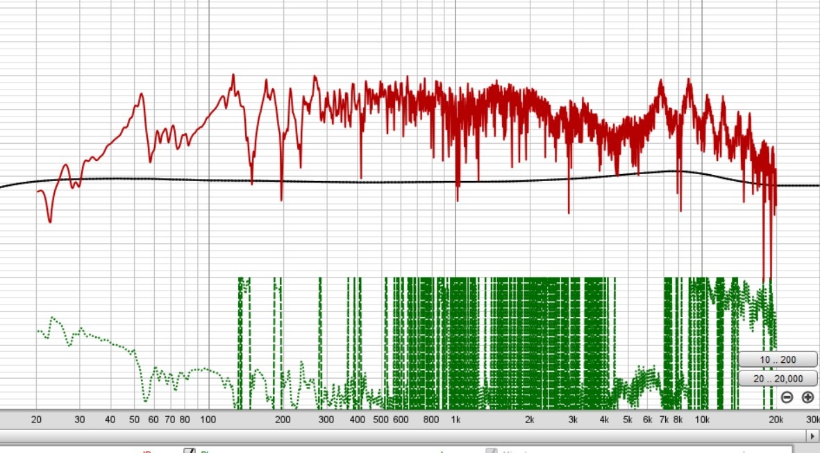

I did tried a new measurement keeping the enclosure bit more higher from floor, however this time I am getting some dips, i took around 3 measurement and all of the showing similar. Moreover I get the same dip with tweeter has well around 1kh regionIt's difficult to be sure with single measurements. What I would probably do at the start is try to ignore the peak near 800Hz, and listen to adjust the tweeter resistor. Set that value in the simulator and try to keep it there for the next stage.

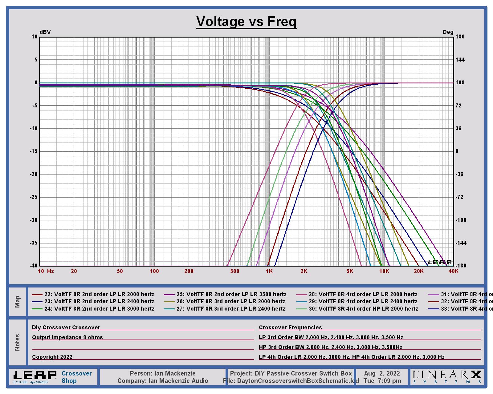

Hi Everyone,
Image you plan to build your next diy loudspeakers without measurements using Dayton drivers.
Most of the Dayton drivers have a smooth response across their operational pass band which means you could adopt a crossover without measurements using the approach as outlined by AllenB in this thread. This intuitive approach lends itself to listening and trying different things.
Please find below some crossover curves I created with 2nd and 4th order LR filters and 3rd order Butter-worth filters.
The crossover frequencies are 2,000 Hz, 2,400 Hz, 3,000 Hz, and 3,500 Hz.
By looking at the driver response curves published on the Dayton Audio website and the crossover curves attached below you can get an idea of what might happen. But the key as we know is in thelistening.

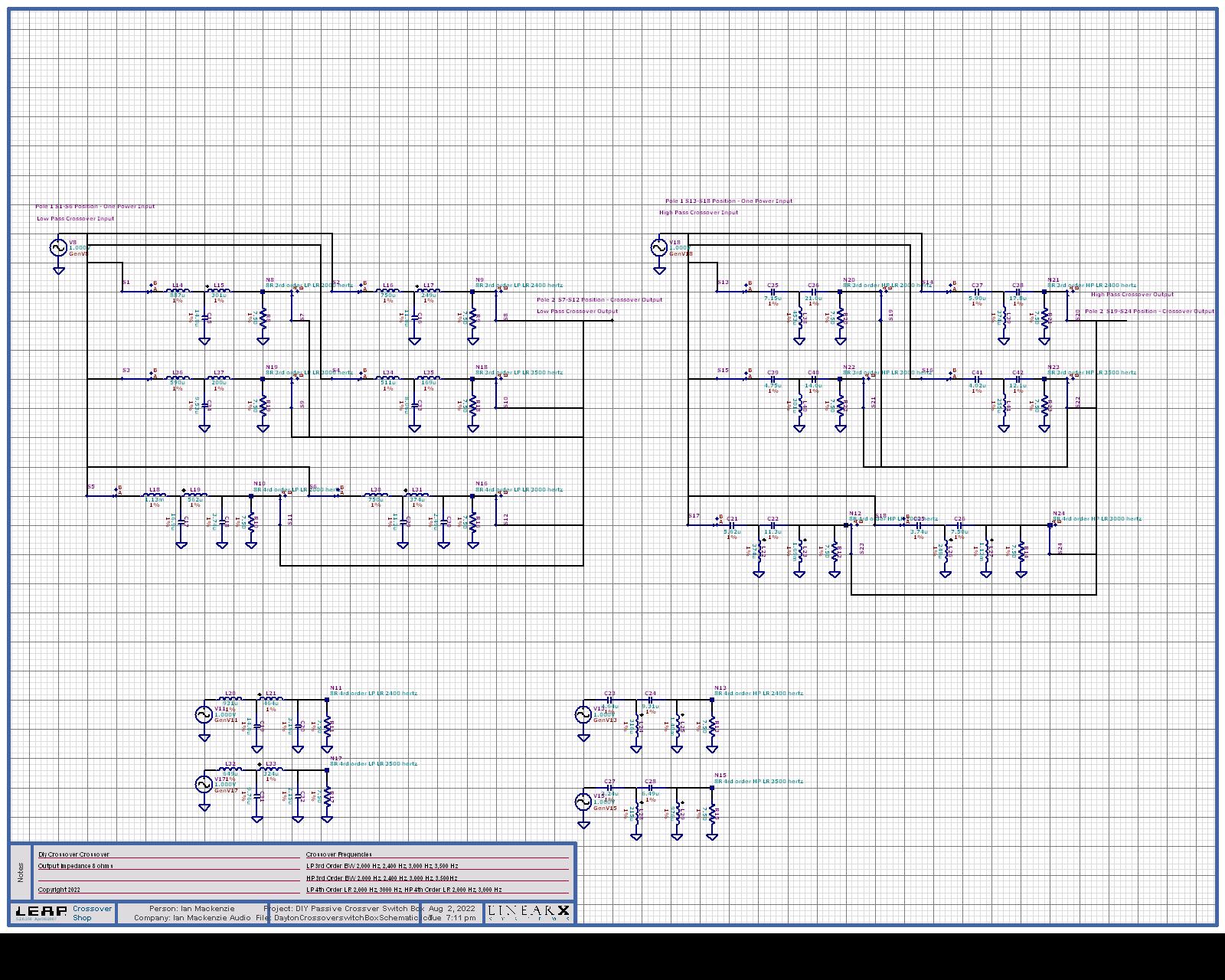

So over the past week I have given some thought to a switchable passive crossover box. The concept of the crossover box is to enable switching of different low pass and high pass crossover frequencies on the fly during subjective assessments.
Looking at the practicality of such an switch box I looked on the Parts Express website at low cost crossover parts sand at suitable low cost Lorlin 2 pole 6 position switches.
Using the available poles and positions of the switch I came up with the arrangement below. Referring to the simplified schematic each filter has an input and an output Node. I decided to use a seperate Lorlin switches for the input switching and the output switching of the low pass and high pass filters.
Grouping the filters I chose some nominal crossover frequencies which are common for a two way loudspeaker with a woofer and a tweeter.
Low Pass Filter Group
Switch One positions 1-6 Filter Input
3rd order 2000 Hertz, 2400 Hertz, 3000 Hertz, 3500 Hertz
4th order 2000 Hertz, 3000 Hertz
Switch Two positions 1-6 Filter Output
High Pass Filter Group
Switch Three positions 1-6 Filter Input
Switch Three positions 1-6 Filter Output
Looking at the Dayton driver response data across the range I chose low pass crossover frequencies of 2000 hertz and 2,400 hertz for larger 8" or 9" woofers and 3,000 hertz and 3,500 hertz for smaller 6 1/2" woofers. The tweeter has identical high pass crossover frequencies.
I then chose 3rd order BW slopes and 4th order LR slopes. These slopes are more satisfactory for filtering out problematic woofer break up modes and a tweeter resonance frequency below the crossover point. The crossover region transitions are smaller and tend to have less on axis and off axis anomalies that 1st and 2nd order filters have.
In use the user will need to refer to the woofer Re and Le to calculate the conjugate RC values for the woofer rising impedance to ensure the LP filter functions correctly.
To spice things up I have also included a filter damping modification so compensate for a rising woofer or tweeter response in the crossover region. To be posted at a later date.
Variable 8 ohm L pads available from Parts Express can be added on the output of the tweeter high pass filter.
Assembling such a switch is perhaps best done on a a sheet of plywood using hotmelt glue to fasten the inductors and capacitors.
Flying leads,tag strips and liberal use of cable ties can connect the filters components to the respective switch contacts.
If there is sufficient interest we could put together a parts and assemble thread. I will post a more detailed schematic.

Yes I did gating@jmascreen , did you gate?

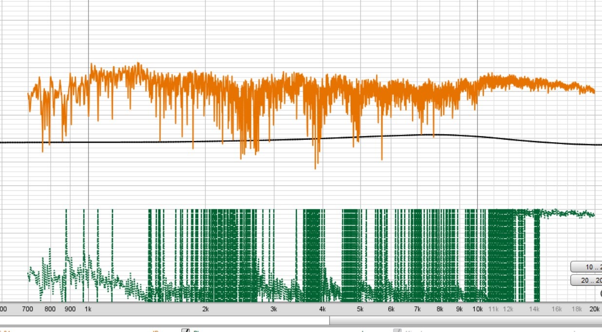

I would like to understand if the measurement taken by me are correct? why I am getting the dips, wherein same driver in similar enclosure over the internet is flat till 4khz. Attaching the Tweeter (orange) and Woofer (red) raw SPL from REWWhat help are you looking for?
If you slide the gate left, is there a point where the treble comes good?
