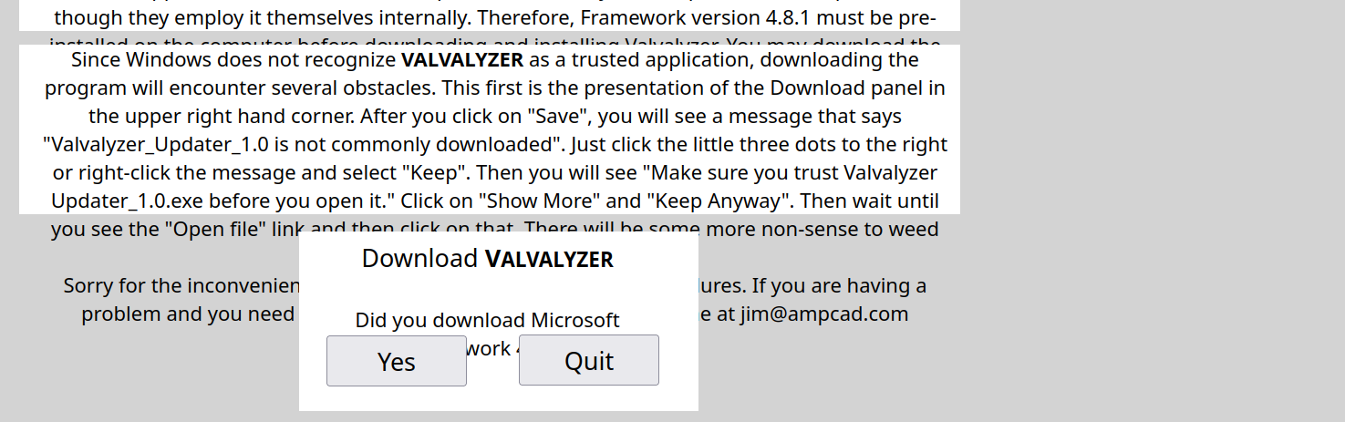

It takes about 50 seconds to transfer the files, then the updater will launch the application, but there is a significant pause there where you might think it crashed. Look in C:\Valvalyzer\Distribution and see if the files are there. If so, you can double-click on Valvalyzer3rdEdition.exe.
if you didn't have net 4.8.1 installed, the updated wouldn't even try to run.
There are the files but nothing with double click on Valvalyzer3rdEdition.exe. I confirm 4.8.1 installedLook in C:\Valvalyzer\Distribution and see if the files are there. If so, you can double-click on Valvalyzer3rdEdition.exe.
Maybe antivirus problems? ( Avast )
No Valvalyzer icon, only V updater
This is really curious. The same files load and launch fine on my Windows 10 computer. Do you have a Windows 10 computer that you can try installing on? Also, there is no Valvalyzer icon, only the Updater icon which ensures updates are distributed as necessary. You can aways run Windows Defender on any file if you fear a virus. I have a feeling your Windows 11 is prohibiting execution in C:\Valvalyzer\Distribution because of folder access restrictions. You can manage these restrictions yourself in the control panel. I get this all the time. You can move or copy the Distribution files anywhere on your C: drive and try running them in the same manner, just a different location. Sorry for all this difficulty.
I uninstalled Avast but the problem remains the same, when I launch V updater the application works for about 50 seconds, then the message " Starting Valvalyzer, please wait " appears and after a few seconds crashes. No Valvalyzer icon, only V updater. I changed the location of the Valvalyzer folder, the song remains the same...

I have a modern i7 processor laptop with 16GB memory on Win11. My monitor has 3840x1200 pixels resolution connected via USB-C. I downloaded Valvalizer through the above buttons (Download Valvalizer) and I got the Valvalizer Updater, that starts to update. It took a while, then I got a message that Valvalizer was starting but after a while nothing happens or comes up. In the Task Manager no sign of application activity and no C:/Valvalizer/Distribution folder either.

If you'll hang in there with me, I might have some good news. And this is good for Horneydude too. I consulted with Copilot this morning about the Windows 11 issues, and it seemed to be fully aware of the problems and even provided several code fixes to prevent Windows 11 from tagging EXEs with a Zone.Identifier alternate-data stream. (Isn't it always something?) The missing C:/Valvalizer/Distribution folder could be that I need to ask for "elevation". Jeez.
I will crank in these changes to the updater today, then ask for your indulgence to test it out.

My apologies, I need stronger glasses appearently, I did find this folder on my C: drive. I'll try to start from the .EXE that is in there.The missing C:/Valvalizer/Distribution folder could be that I need to ask for "elevation".
Same here.There are the files but nothing with double click on Valvalyzer3rdEdition.exe. I confirm 4.8.1 installed
In my case it ran in W11 and seemed to run from the updater install folder rather than somewhere else, it did work. My sole problem was monitor resolution.

kevinkr, Your evidence seems to contradict everybody else's. Nobody can seem to run the application even by double-clicking on Valvalyzer3rdEdition.exe in the Distibution folder. I'm so glad you are still in the conversation.
Horneydude, I want to thank you for your detailed post and for being engaged in this struggle. Windows 11 is kicking my ***, but my *** has been kicked routinely with great effect. Stay with me brother, I think you will be a great partner in the long game.

Maybe this is helpful. There seems to be some strange behaviors, the installer created a desktop short cut that links to the updater and it actually is running from the folder shown below the short cut properties.
And here is what is in my installation folder.
In W11 the bulk of it actually lives in the C:\Valvalyzer folder. Investigating further. Here is the EXE and there are many other files. (Not all files shown)
Clicking on the above file launches the application, not able to access the functionality due to not meeting the 1200 pixels requirement. I can see that there is a lot of functionality built into the software.
Not sure why running the updater installs a desktop icon (short cut) that points to the updater rather than the program files. More to figure out I guess.

Sadly I don't have any available W10 machines, the only one I own is on long term loan to my wife and she needs it for work. (Her employer was supposed to provide one, but seven months later that still has not happened.) My employer's machine is off limits.
