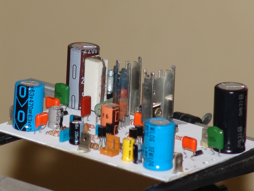

Where'd you get your circuit board material? Looks like the old phenolic board. Is that what it is?
se

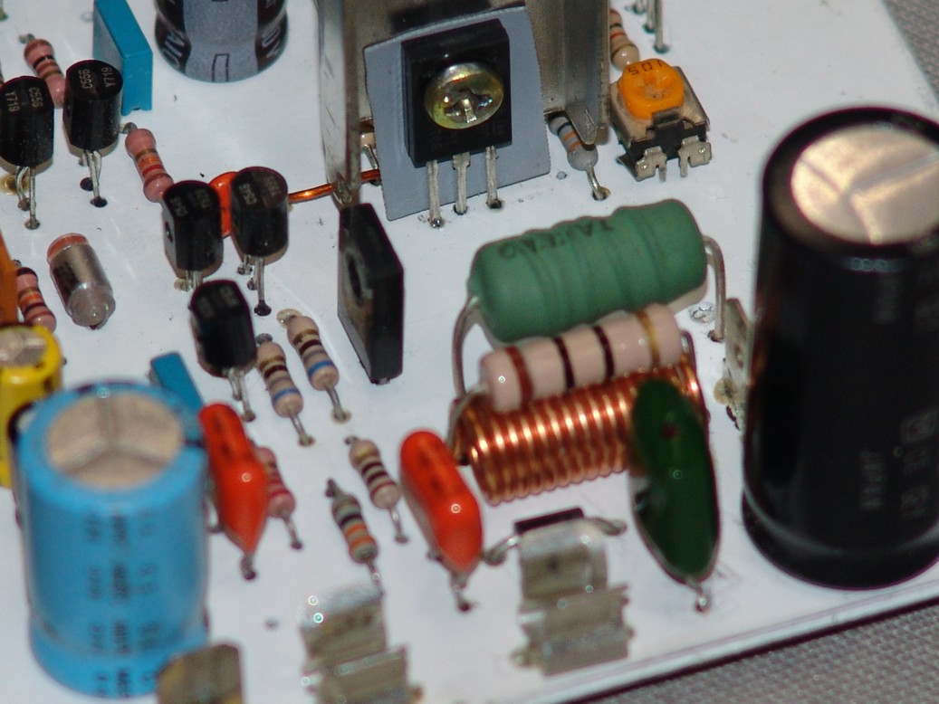

hahaha Yes, it is! I had some pieces around. And I have painted it with white spray!!!!
I have to wear a mask when drilling this material, for it is very agressive (the powder) for breathing. (hope you understand my rough english...)

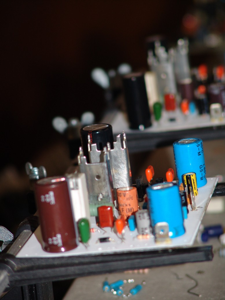

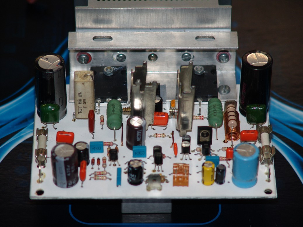

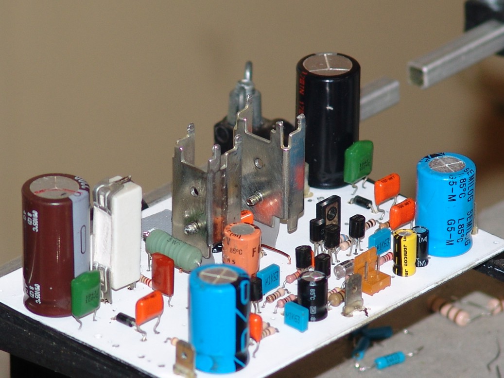

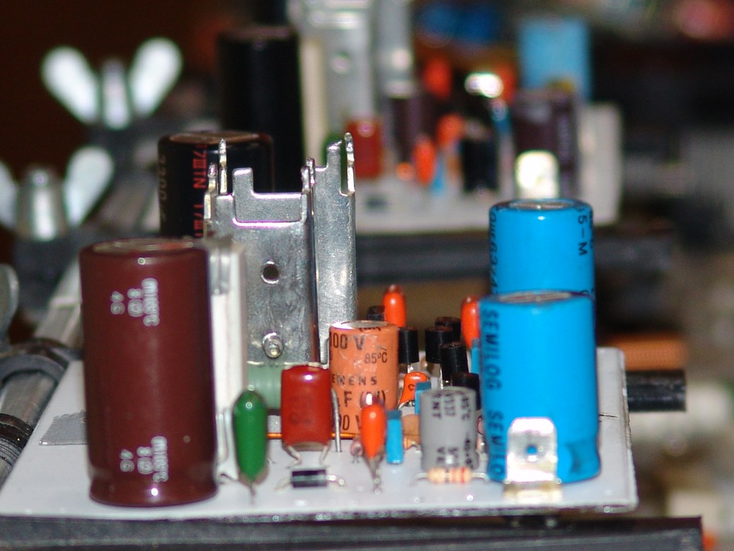

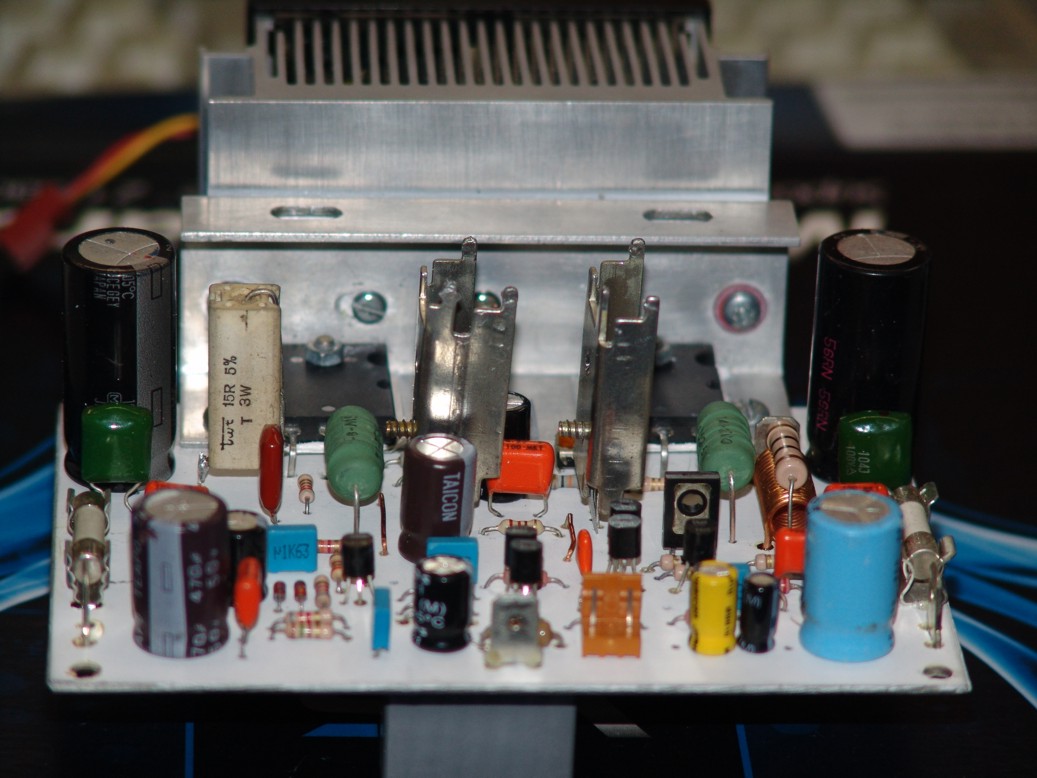

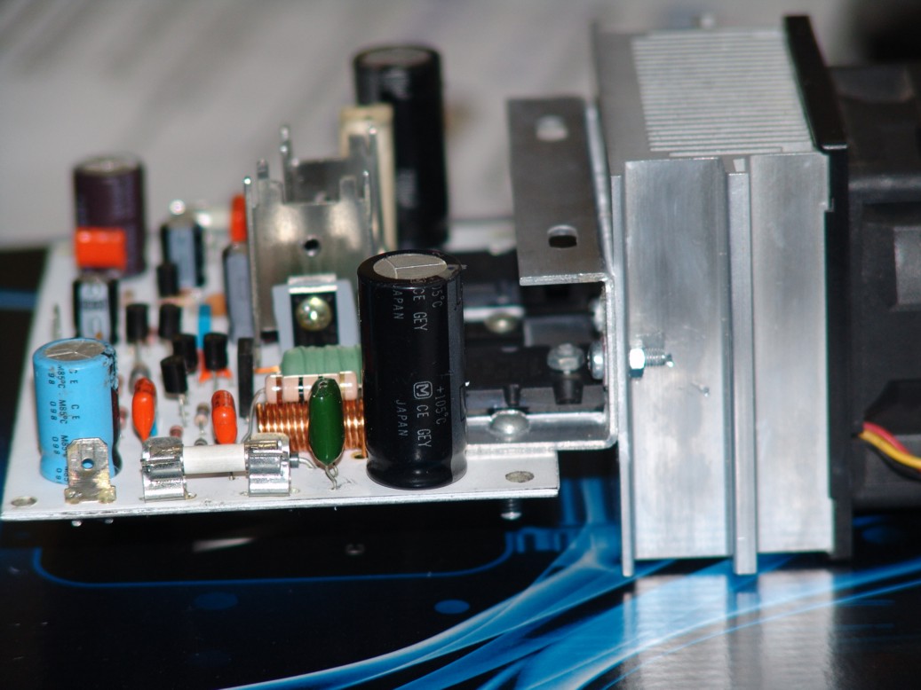

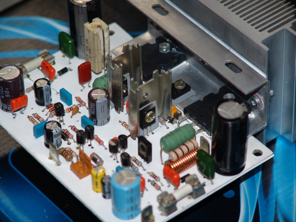

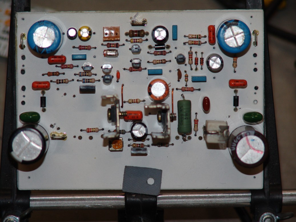

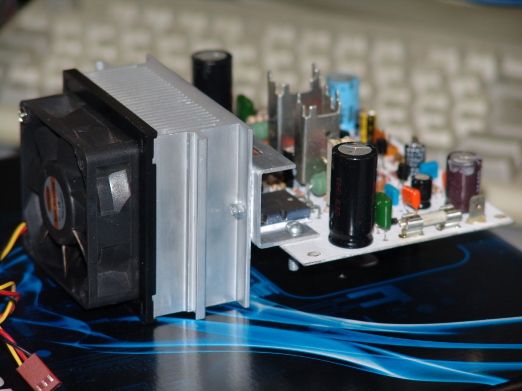

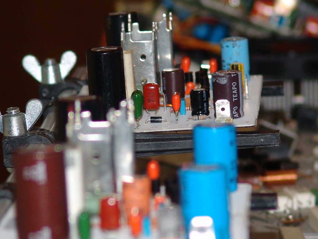

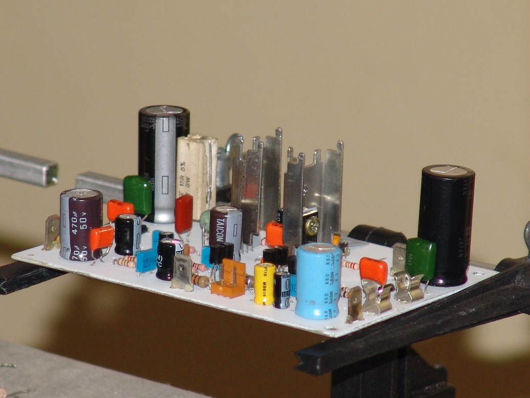

Here are some photos. I'm almost finished.
Thanks everybody for the nice comments! Have a nice weekend!

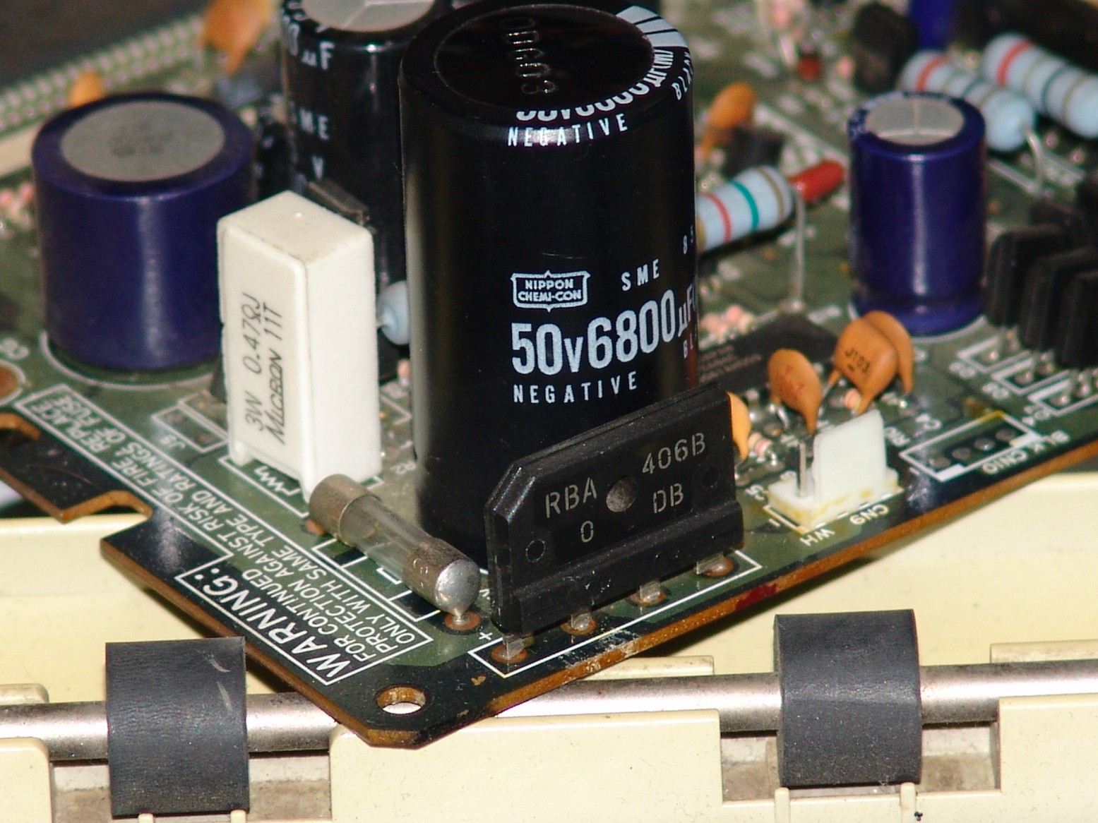

Also I find a propane torch is much faster than the solder iron to remove parts from a PCB.
Got to try that torch trick! 😱
I usually grab all PSUs, old amps and PC monitors for the parts hidden inside. Some parts are really valuable, like rectifiers, diodes, power transistors. Other parts are rather odd: I once found a TDA2006 in a monitor.... 😕 😀
Some monitors have embedded speakers, so need to be amplified. Although this seems to be a mono device.

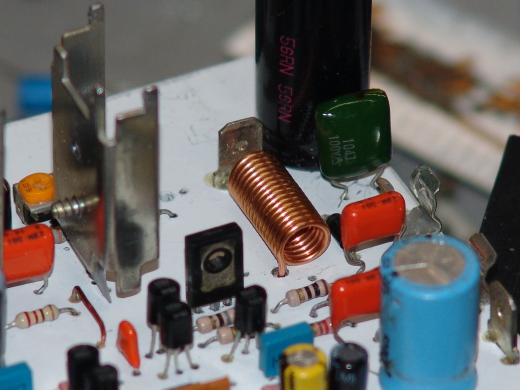

Almost there!

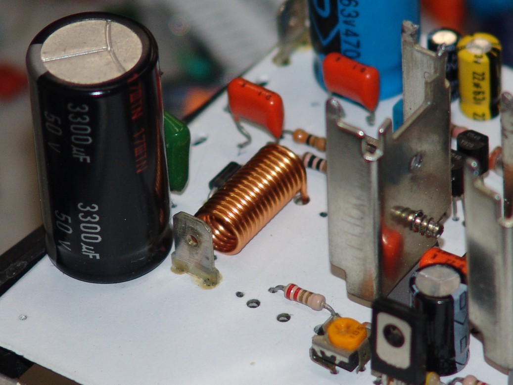

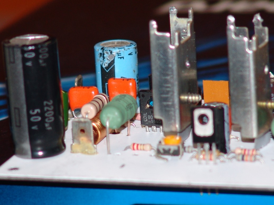

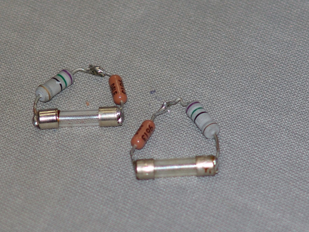

Some details. Attempt to the output coil, removed from an IBM PC100 PSU! The 10R resistor is a bit out of especifications for the output power, but I will look for the correct one!

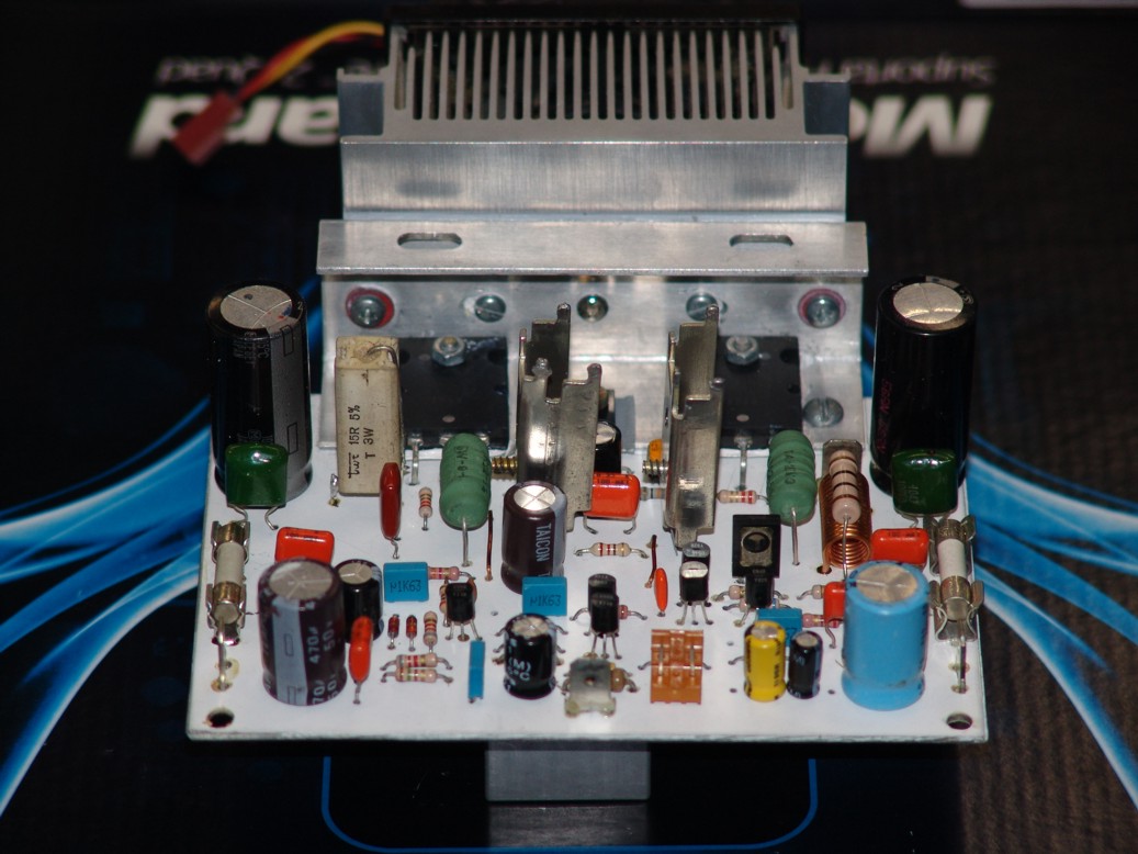

First unit done!
It is past midnight, my wife must be angry with me...
This is the finished first unit.
Tomorrow I expect to have it tested!
The answer is: YES, IT IS!!!
Well, definitely it is! The sound is SUPERB! 😱
No need to adjust anything than bias! No problem, no excessive heat, only glory!
Thanks to very good project from the forum!!!
Of course transistors were all new, but sometime I will try with some old used parts.

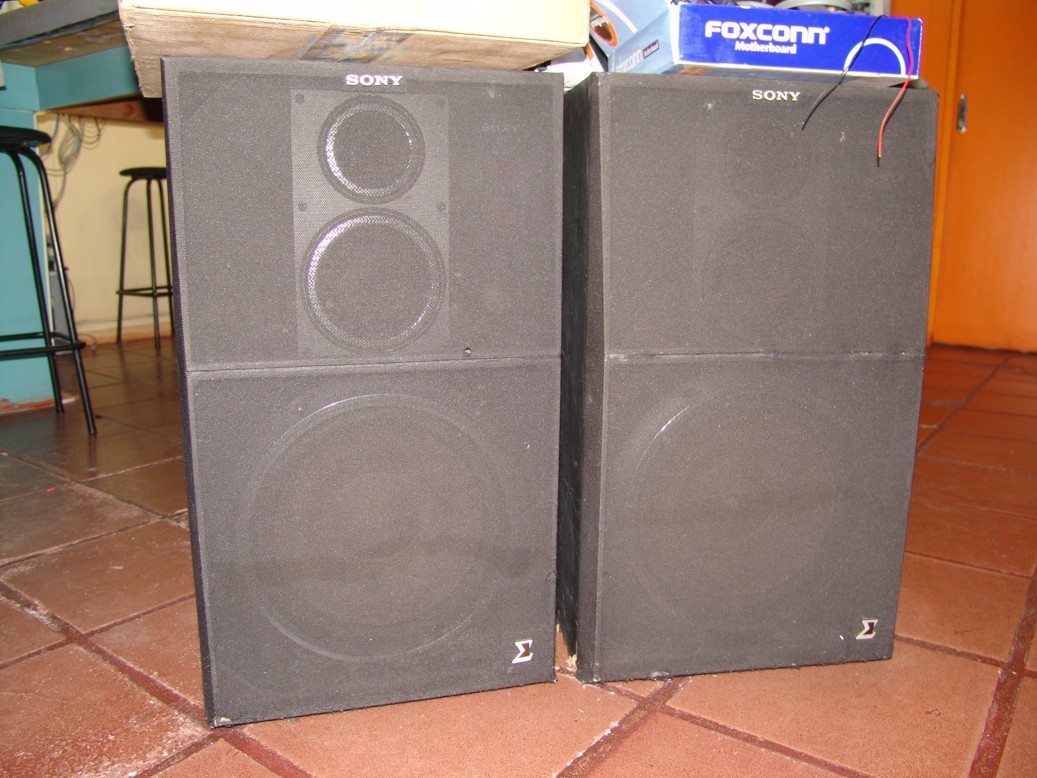

- Is it possible to build a good amplifier out of junk parts?
