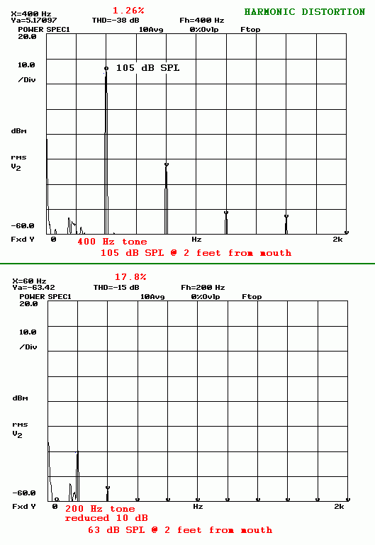

In 2011 Al Klappenberger (ALK engineering) tested some drivers to be used with the Eliptrac 400 horn, including the FaitalPRO HF200.
I suspect his findings have contributed to the popularity of Faital drivers in the US.
"The mic was setup 2 feet from the mouth, level up to 105 dB SPL with a 400 Hz tone. The analyzer computed the harmonic distortion at -38dB. That's only 1.26% harmonic distortion!
Next I reduced the level need to make 105 dB at 2 feet by 10 dB and lowered the tone to 200 Hz. That is roughly what the level would be through a 12 dB / octave filter with the woofer generating the tone at 105 dB. The level out of the driver dropped to 63 dB SPL with the second harmonic down about 15 dB lower. That's 17.8 % distortion but the level is so low it would not be noticed!"
Quite impressive I would think.
