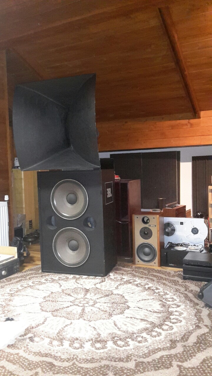

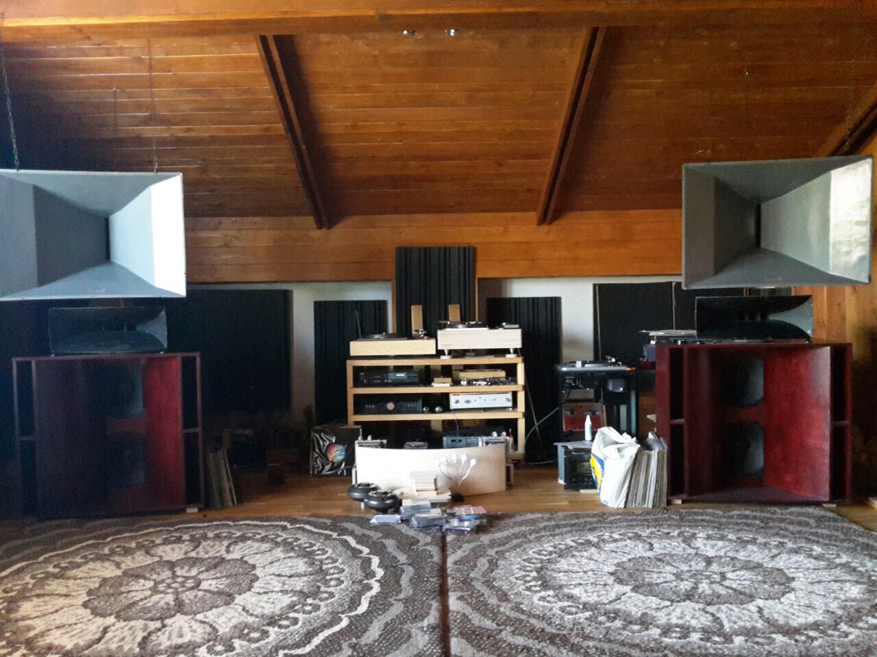

A friend of mine went through some JBL driver combinations, his favorite so far is the one with the wooden horn and the Altec 906/dual 515 combination but it is augmented with a Fostex HF.

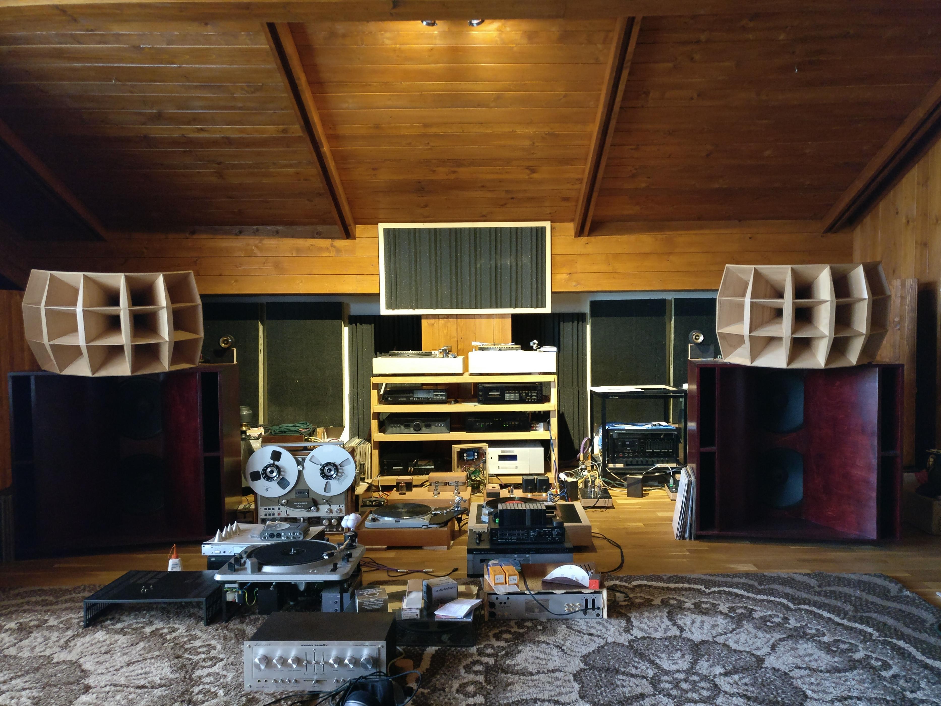

Stunning Altec system!
Those mutlicells are Markus Klug's 1505B replica's?
I wonder if a slightly scaled up 1803 with a custom throat adapter for the Axi2050 would facilitate 200-20.000Hz without tweeter.
Probably not.

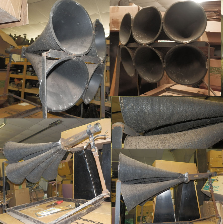

Sectoral horns are still widely used for sound reinforcement, mostly in line arrays, but also in some large 'point and shoot' systems
The Austrian guys who built the Wall of Sound - posted a few pages ago, use sectoral horns for their mid-high cabs.

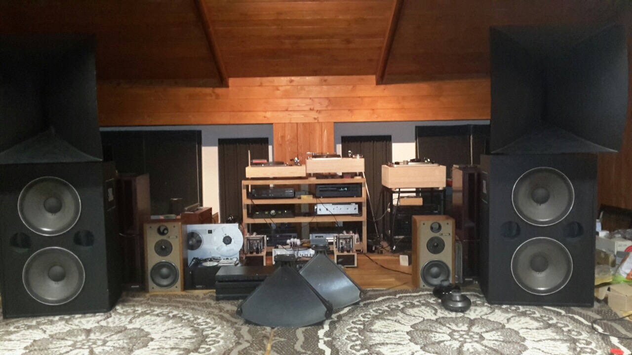

Apparently, somebody liked the Lambda Labs club systems so much, he decided to use a few of those hornloaded cabs at home:

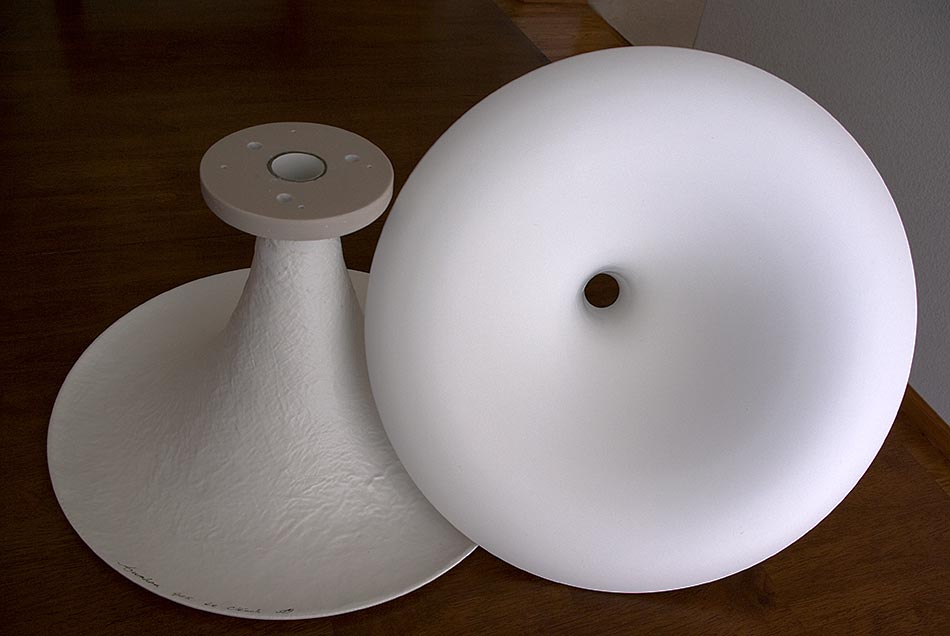

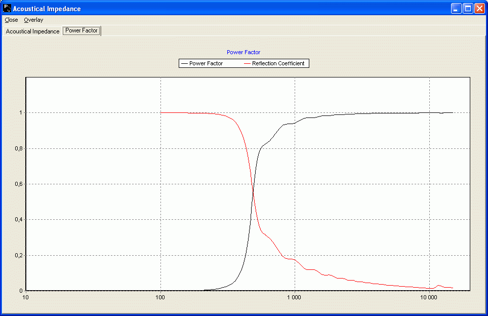

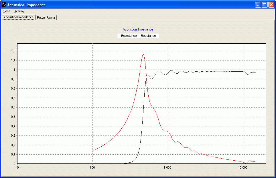

Impedance of real horns allways possess a reactive part. At high frequency all horns and waveguide possess a nearly pure resistive impedance. Things differs when frequency decreases.
I want to make sure that everyone understands what the acoustical impedance as shown above means and shows. In this example the device is not infinite, but finite, and the ripples (peaks and dips) are the result of a standing wave between the throat and the mouth. In this example the mouth reflection would have to be very large for this level of ripple.
If the waveguide is OS and the mouth is adequate terminate then these ripple will disappear. When they disappear the reactive component gets smoothed out and has much lower values. This means that the group delay will be much lower and, in fact, becomes virtually irrelevant.
When you see large ripples like this, you know that diffraction and reflections are excessive. One can also look to the drivers electrical impedance as these ripples will appear there as well, but not as clearly as they will appear in a pure acoustical; impedance.
In my waveguide there are no ripples at all in the electrical impedance, only the two peaks that are always present in a compression driver. Ripples always indicate a problem - they are never a good thing.

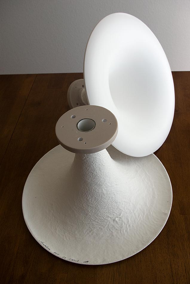

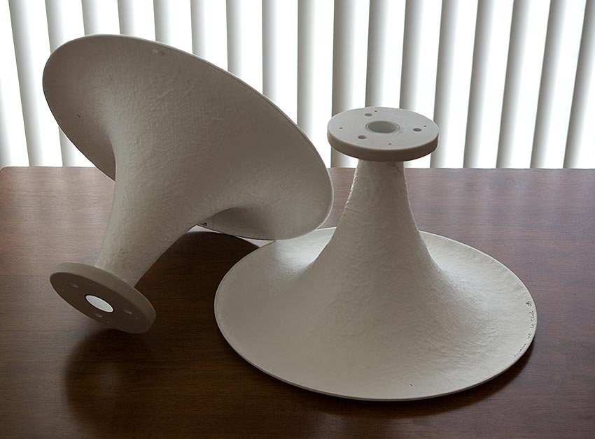

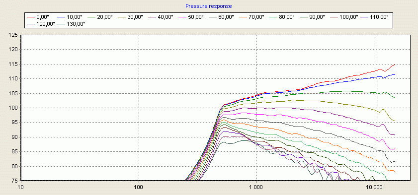

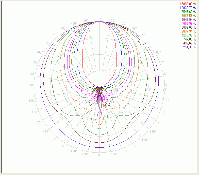

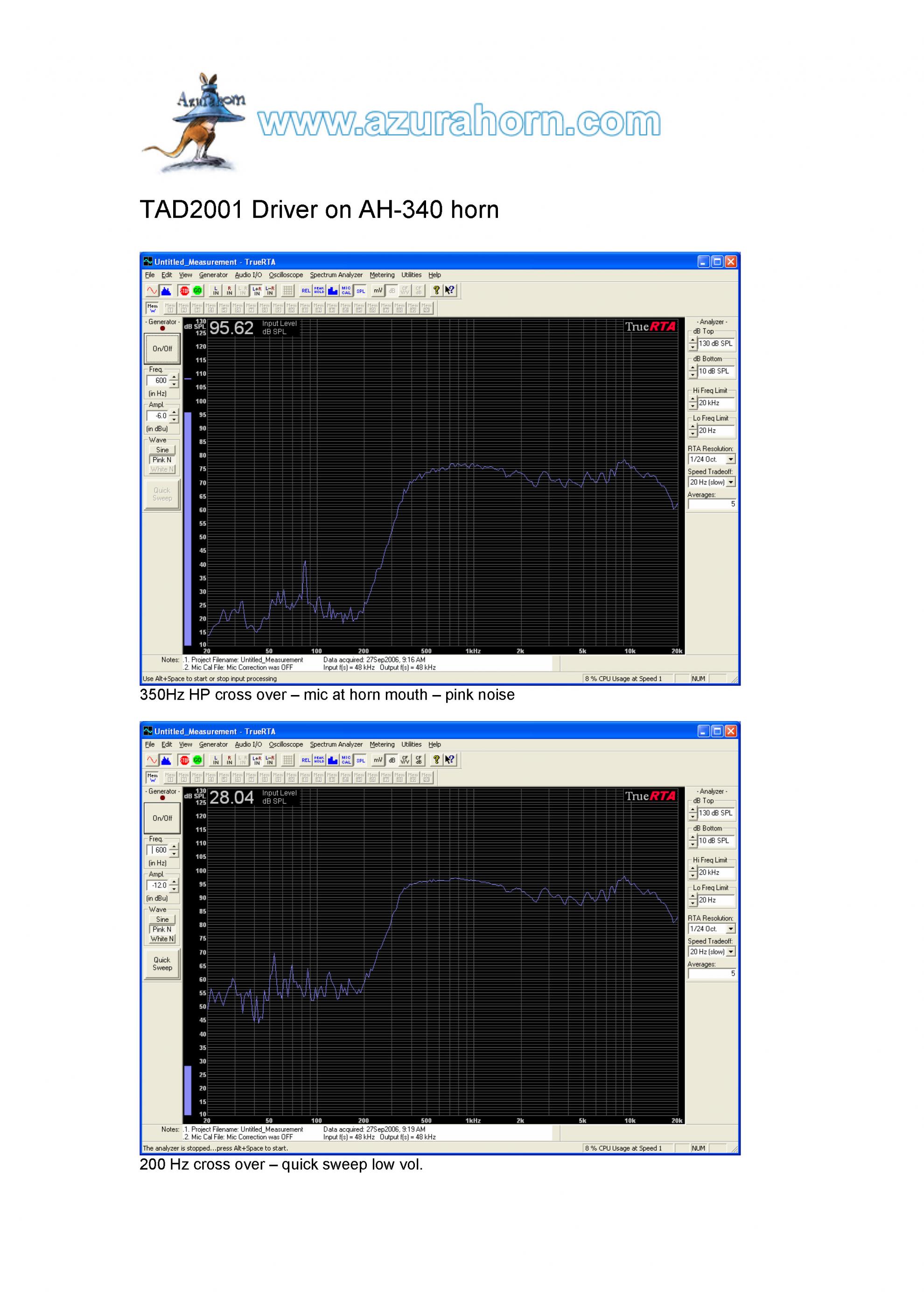

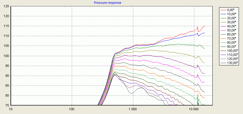

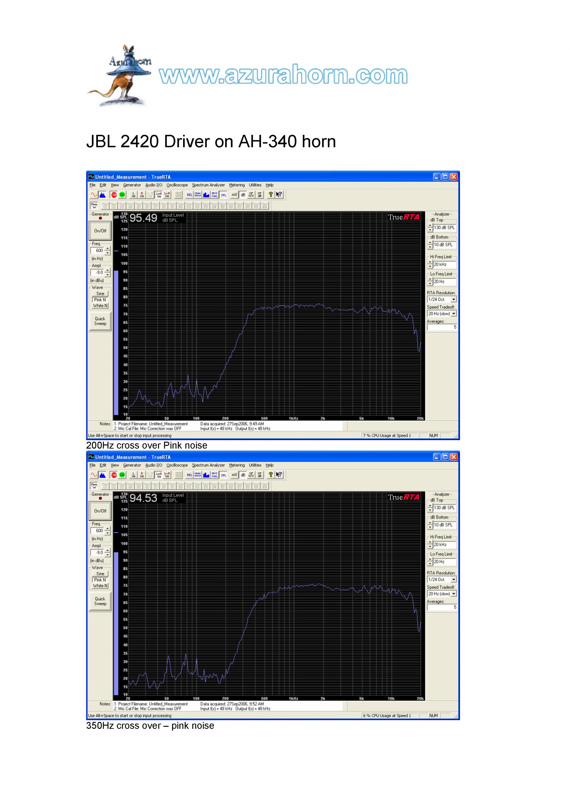

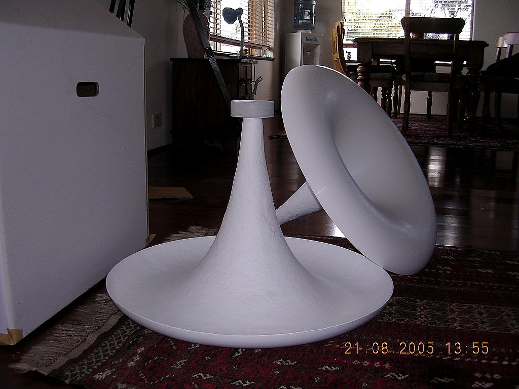

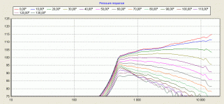

Around the same time, Bjørn Kolbrek posted some BEM sims of the AH425 (Azura Horn) in Lynn Olson's "Beyond the Ariel" thread.
The AH425 is a smaller JMLC horn.
The AH-340 with full roll back is probably more akin to camplo's horns.
frequency respone plots for constant throat velocity (no driver), 3m distance, for the shell ver.gif12.1 KB · Views: 140
frequency response curves without driver for the AH-425. This is the SPL at a 3m distance from t.gif13 KB · Views: 402
Probably not.
Indeed it is a Klug Horn, he is in love with it. I love the looks as well, the wood is so nice and somehow it has a higher WAF, not that the Azura horn is ugly but still. Axi2050 plus a huge Klug horn=LOVE. May be we should ask him?
