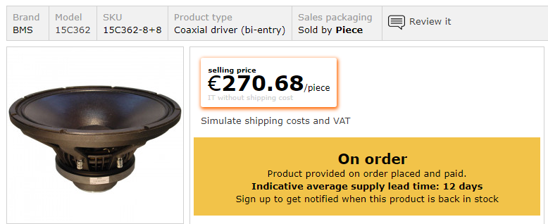

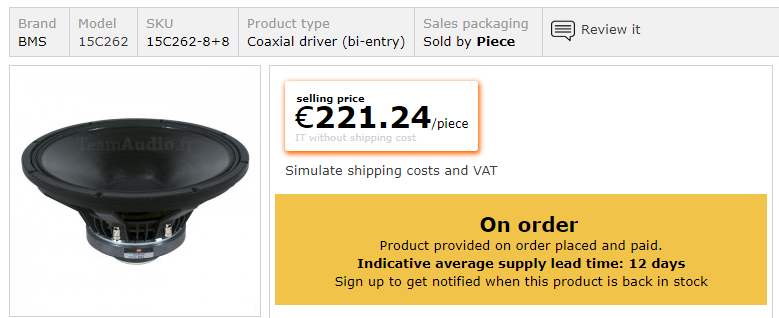

It's funny camplo, I'm up to my neck in coaxials at the moment and wonder why one would go through all the hassle of individual horns and woofers if you could have this, with a coax driver that costs less than most 15-inch woofers and has all the features that are considered important:
Contrary to my expectations, this driver (BMS 15C262), as well as its bigger brother (15C362) would drop right into my cabs and cover 35-20k (in-room) with an extended bass shelf, padded down to compensate for baffle step. Total cost: less than €600.
It seems the 15C363 could be crossed even slighty lower.

In addition, on this side of the pond, the KL3015CX-8 alone is more expensive than the 15C262.
So you still have to buy the Celestion comp. driver and probably end up with a crossover at 1400Hz, which is slightly higher than I would like.

Ro808 - yes, but the BMS is considerably cheaper.

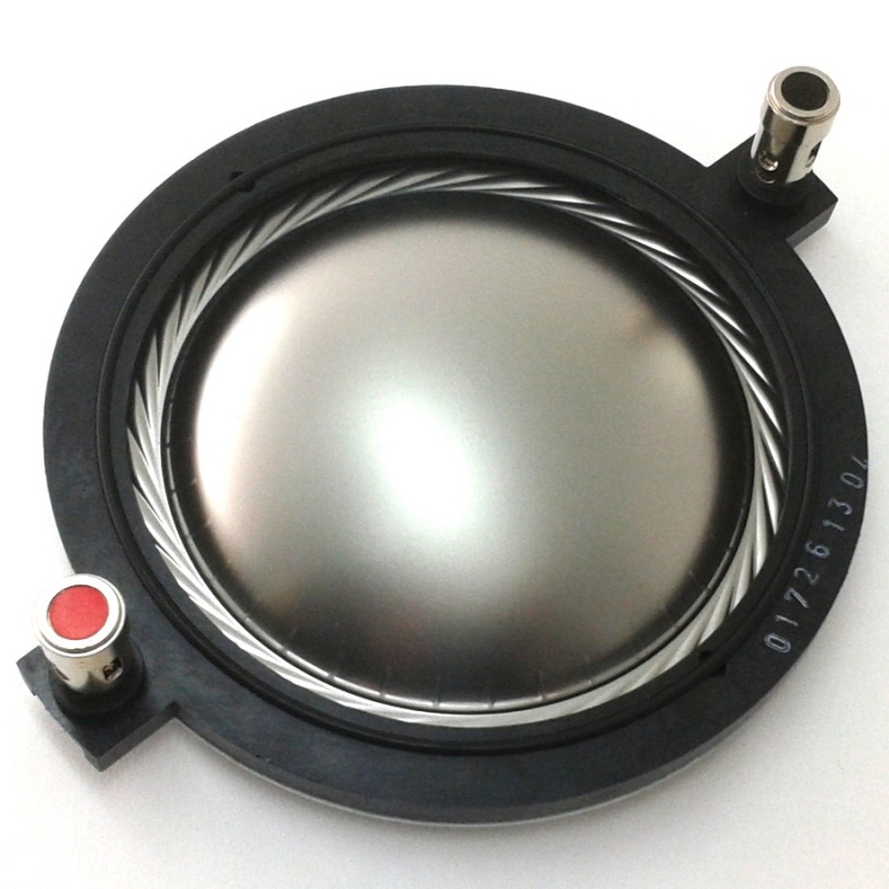

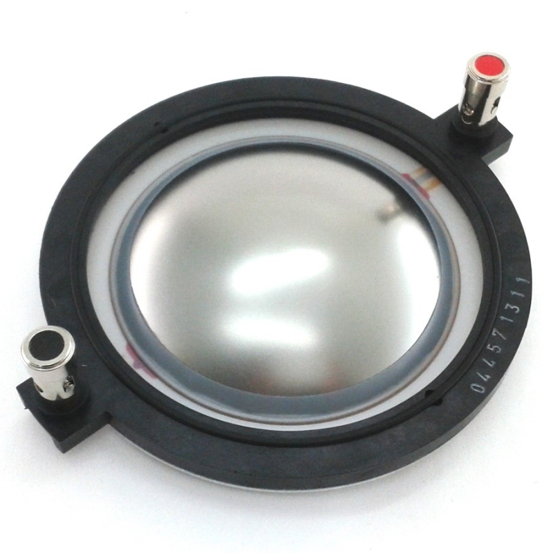

The journey of Adolf Corkscrew with the B&C 15FCX76 is quite interesting.
He starts with a number of clearly defined objectives and finally manages to 'tame' the B&C coaxials by using strictly passive crossover components.

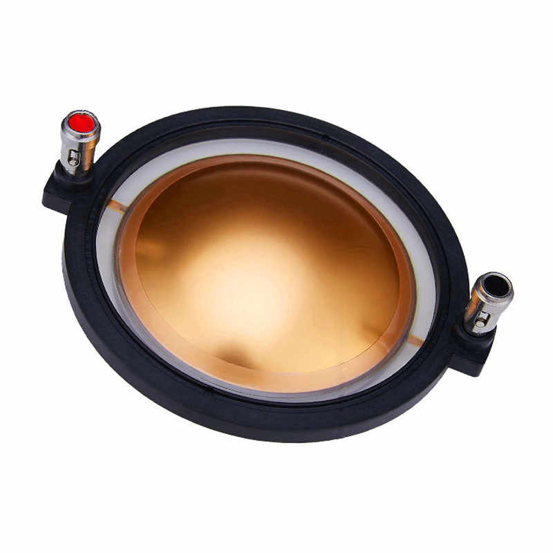

He was probably unaware of the somewhat harsh sound of the all-Titanium MMD3BTN8M diaphragms in the compression driver (first image attached).
As with the older B&C MMD3A8 3" diaphragms, Mylar (soft) suspended versions of the same diaphragms are available. These usually exhibit a less severe breakup peak and better damping of resonances in the top octave.
B&C usually mounts the hard suspended variants because of their durability / heat resistance.
There is a reason why 18Sound has switched from hard to Mylar suspended membranes for the 1" ND drivers (ND1070-ND1095).
I would immediately exchange the MMD3BTN8M for the MMD3B8M (2nd image), or try a pair of coated aftermarket diaphragms (3rd image) for 1/5 of the price.
