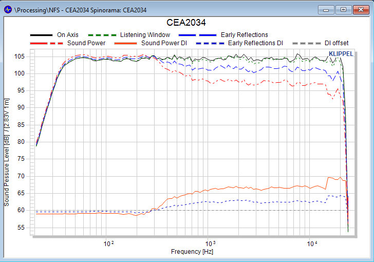

Data of the smaller brother (the big one is still under development):

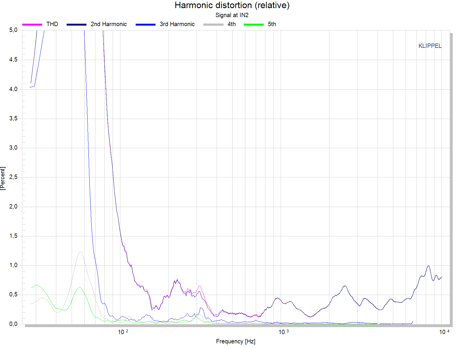

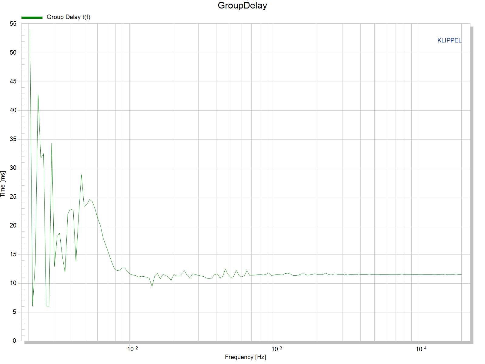

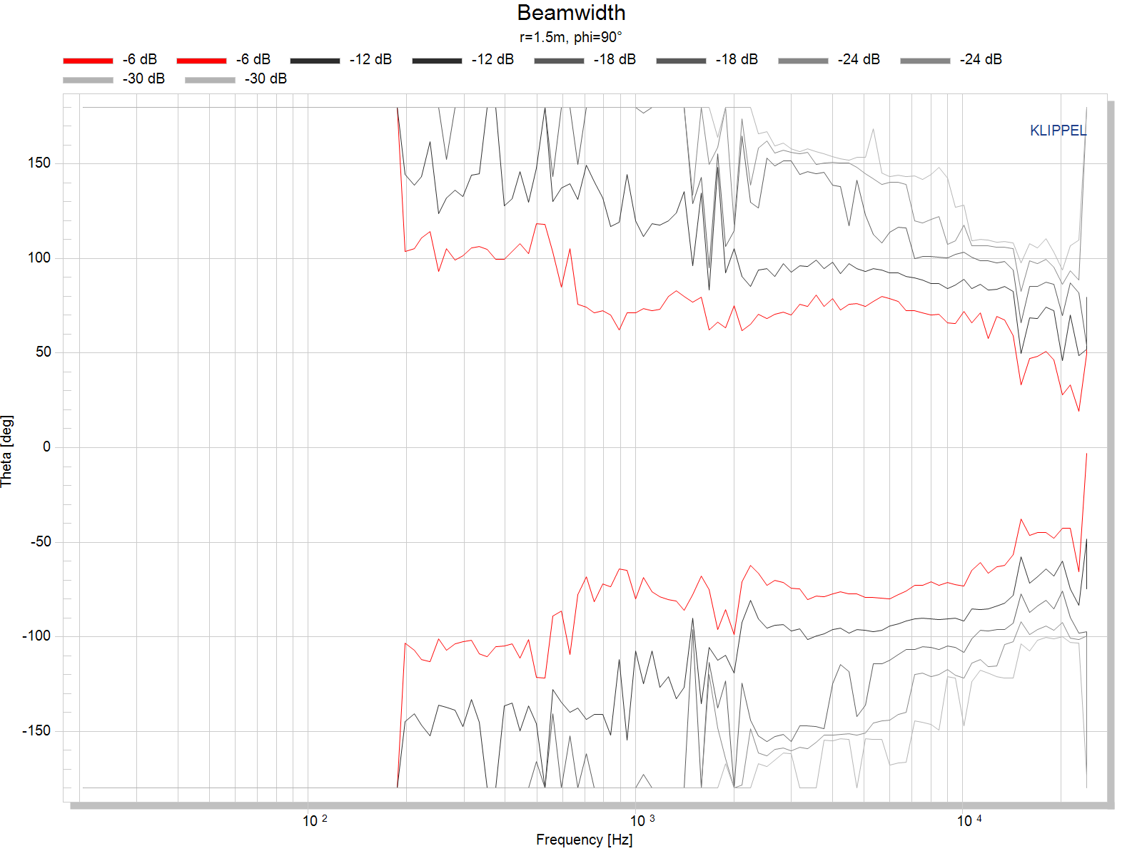

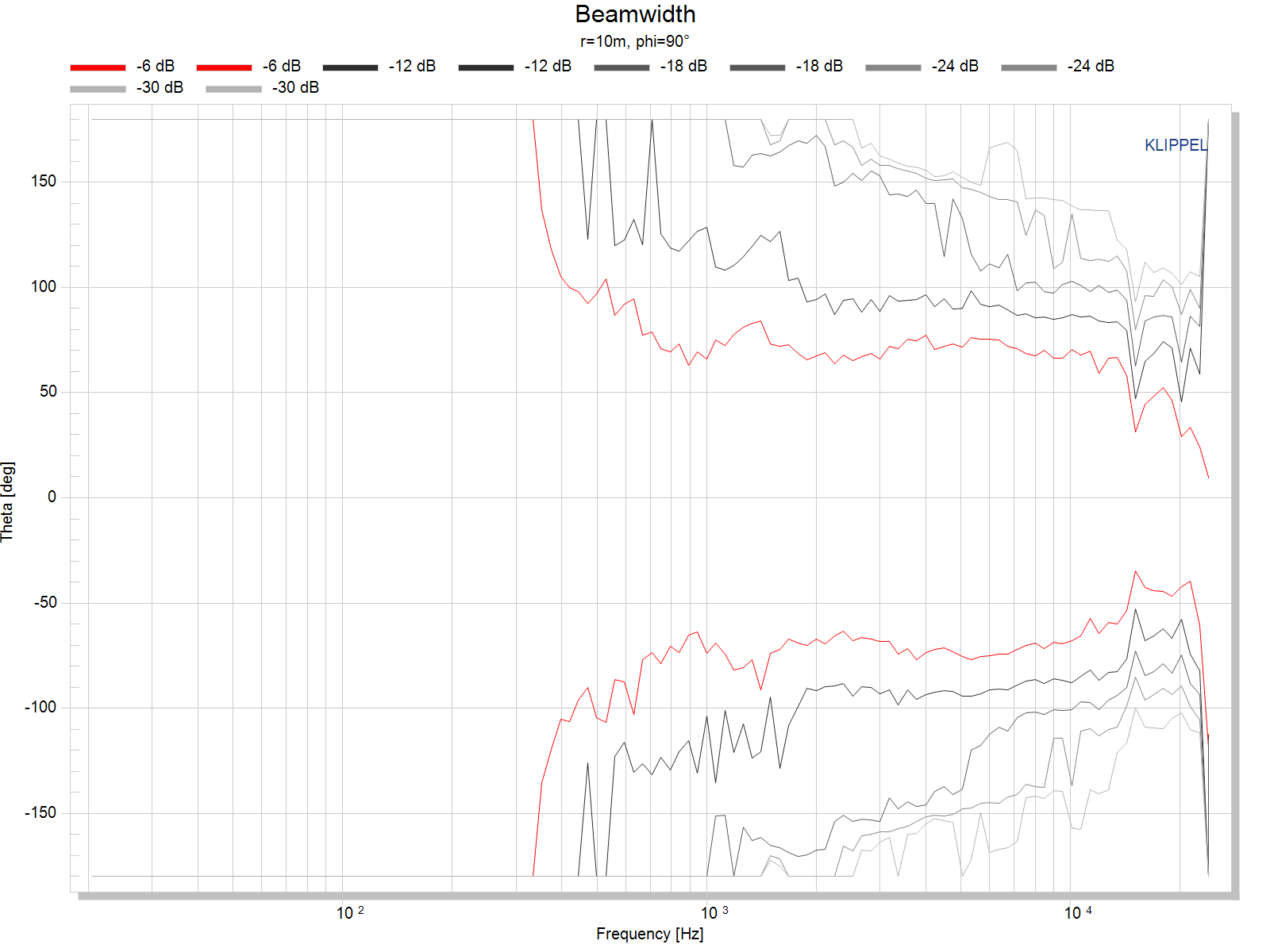

Once you've managed to optimize the hardware (drivers, cab etc.) and know how to finetune a passive crossover, I don't believe DSP (FIR) can add much, especially wrt 2 way systems.
Measurements, especially those above, tell the story in ideal circumstances. In an average room, or any other space (with furniture, people and even deviant climatic conditions) measured response etc. may be (slightly) different.
Nice low-end extension on that speaker. But it comes at a price with its strange group-delay shape and increased THD.

Yes, probably due to the lossy SB-Acoustics woofers

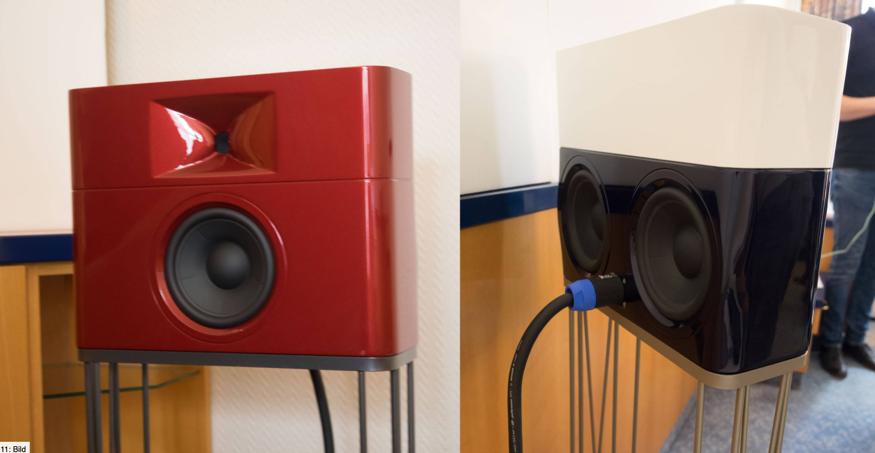

The M2 at 800Hz is being crossed outside the CD's comfort zone as has been spoken about elsewhere (the distortion rises in that region) but it was done to have a smoother directivity match between the 15" and waveguide, so directivity was prioritized over distortion.
