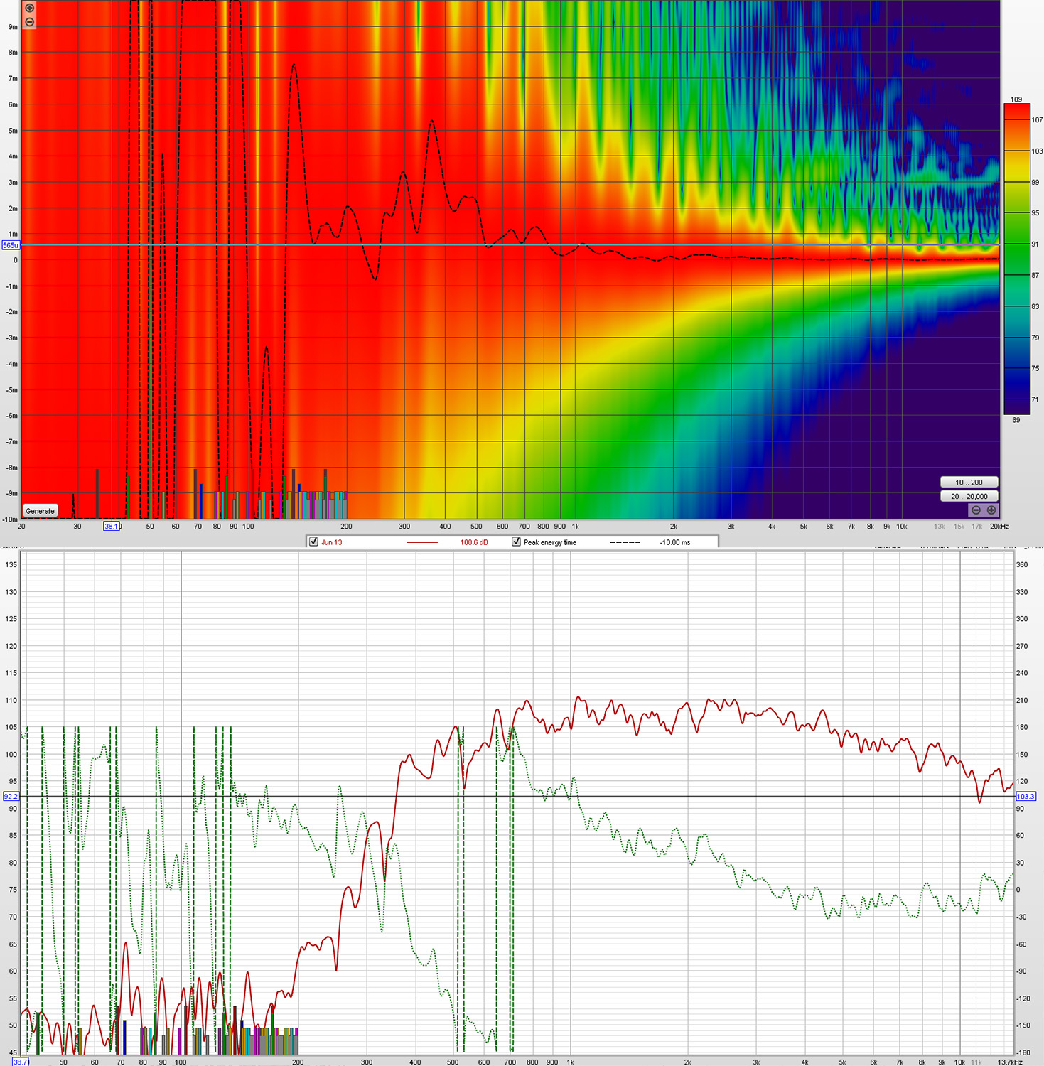

It looks as if its vertical radiation was broader than the horizontal radiation at HF. Doesn't it ?
Regards
Charles
Most likely the plots have been swapped by mistake.
I quess the horn has been rotated because at lower frequencies the behaviour is as expected for an MTM with the horizontal radiation angle being larger than the vertical. While it looks the contrary at higher frequencies.

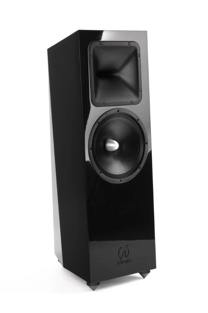

I'm not sure which version I've heard by the way, but I'm guessing it was the XR1496 given the setup > 2 point stereo in a wide space.
A prototype of the Ø Audio Icon was tested by Norwegian magazine Stereo with the XR1496 rotated.
Comment of the manufacturer:
The speaker that was tested is the latest prototype that was produced and we have tested with the horn both ways sometimes to see how it turns out. The result is a bit room-dependent whether you hear a particular difference or not.
...but it is incorrectly mounted on the latest studio photos. We had pictures taken at a photo studio in Poland and the horns / wg on the speakers that were sent for the photo were incorrectly mounted. Horn / wg will be the "right" way (rotated 90 degrees, the gap in the middle going vertically) on all speakers that leave us.

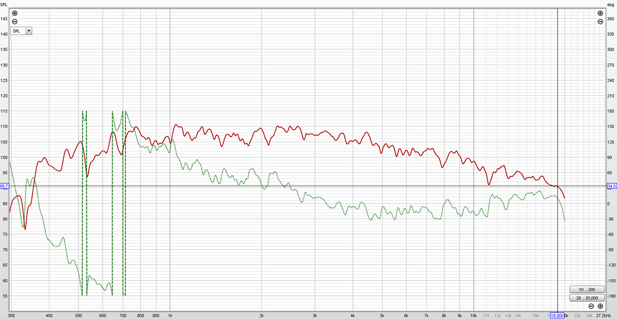

I believe in subtractive eqing first....the first filter will likely be a shelf that is approximately -10db....that gets me to +/- 2.5db (back when I was taking measurements at the mouth that is) but you bring up a good point....after the reduction, sensitivity is likely 88db? And I'll need more watts to get to where I am aiming for (~115db 1m)....

FWIR that's the way I would do it and then you add then factor in listening distance which will of course increase the power needed. There are plenty of online calculators for this. Just doing a quick calc 100 watts is 20 db. That would get you 110 from 1 watt 1 meter.
You could do a combination of +/_ EQ to get you a higher base sensitivity but because of the + EQ you power requirements are not likely to change very much. There really is no free lunch.

Looking at your measurement I think you might be low balling your base sensitivity. You don't need flat on axis out to 20K. What type of horn is it?? CD or non CD looks like a tight pattern CD with the roll off.
If that's a CD horn you are going to want to end up with a tilted in room power response so you might be closer to 95Db or so but you won't know until you power up take some measurements and listening tests.

Assuming you are using EQ to flatten response across the passband....
once that is accomplished, whether you use additive or subtractive EQ will not matter to sensitivity, or amp power needs, or THD, etc........
when comparing the two approaches at same SPL output of the driver/speaker.
Knowing neither approach matters to the realities imposed on either the amp or the driver, i tend to EQ both up and down from what appears to be a midline sensitivity (from eyeballing the raw response curve).
That midline sensitivity fulcrum is usually pretty close to measured sensitivity of the integrated flattened passband.

You may need 20dB more gain at preamp stage, but an amp that can handle 110dB will handle this speaker because the peak level of actual "music" signal @1K is usually 20dB or more higher than the peak @20K.
I would just add +20dB@20K with digital EQ and it should not be overloaded when I play "music".
