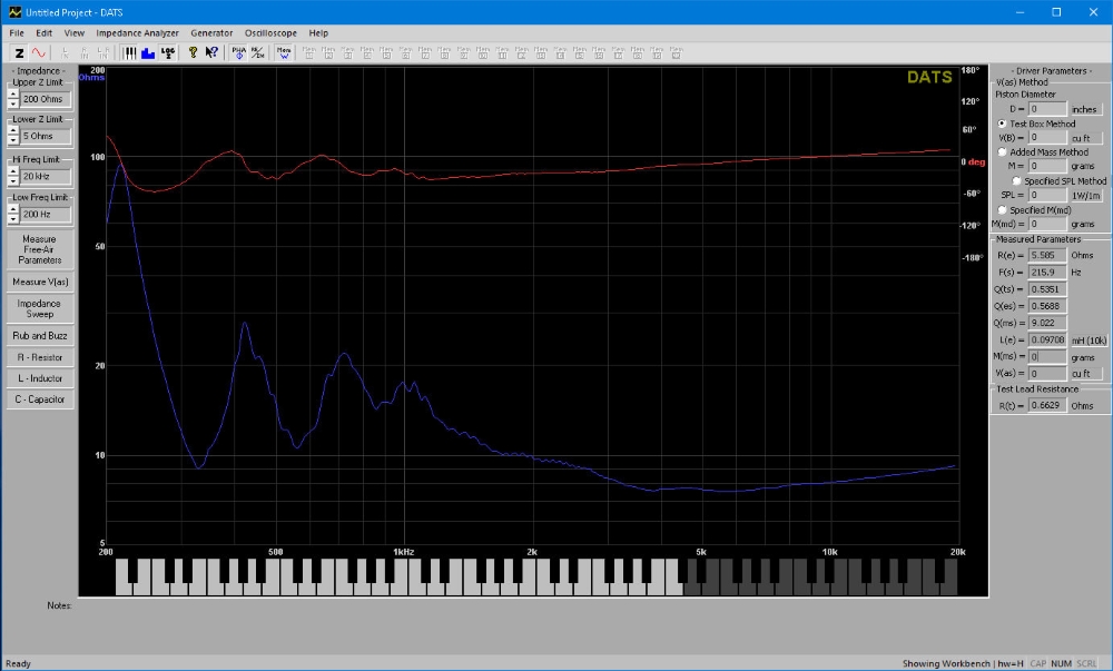

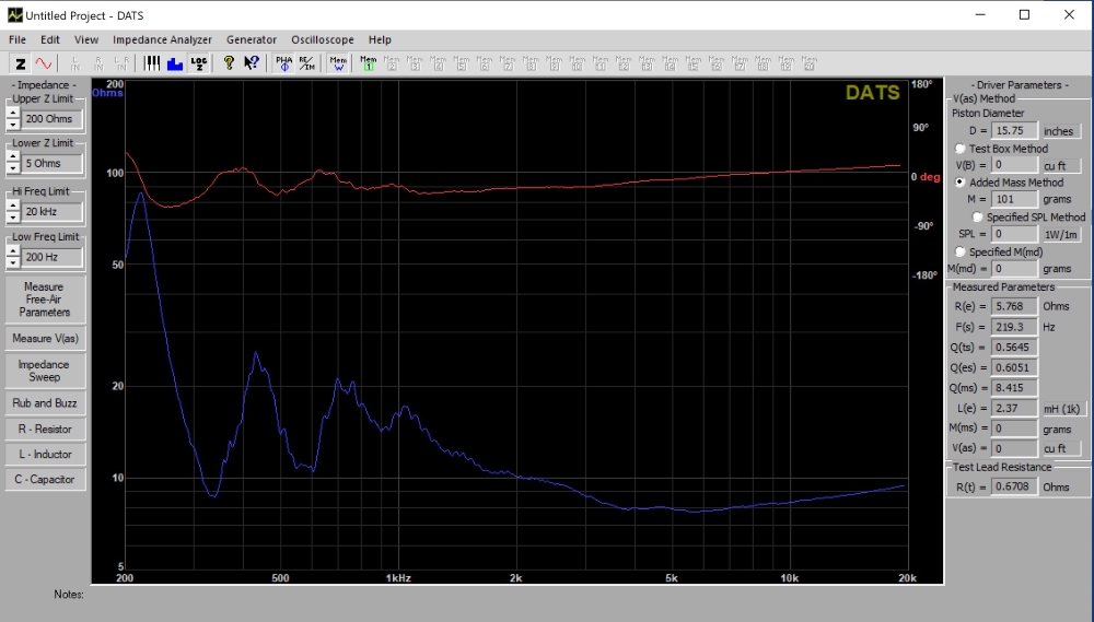

I thought i might get lucky and it was the usb power of my laptop so I took the control woofer (not broken in) down downstairs to my desktop...still not good on the motor

Not to cast aspersions on your DATS prowess, have you followed the same process as outlined in these videos?
REVIEW - Dayton Audio DATS V3 - YouTube
A Common "HORROR" Story + A Brand New Solution - YouTube
Cross calculating the parameters as shown in the second video gives an idea if the parameters being measured are even physically possible.
The more you can do to weed out any user error would surely make it easier to get some action from the manufacturer if needed.
1€ that these will in the end come out to spec. E.g... forget measuring impedance in any sort of box. Clamp the magnet, secure the clamp to a very sturdy and none-resonant fundament and measure, to begin with, at very low excursion. Impedance measurements is like having hooked up a giant microphone to your sound card...
Did you measure Re with an ordinary ohm meter? Result acc to spec?

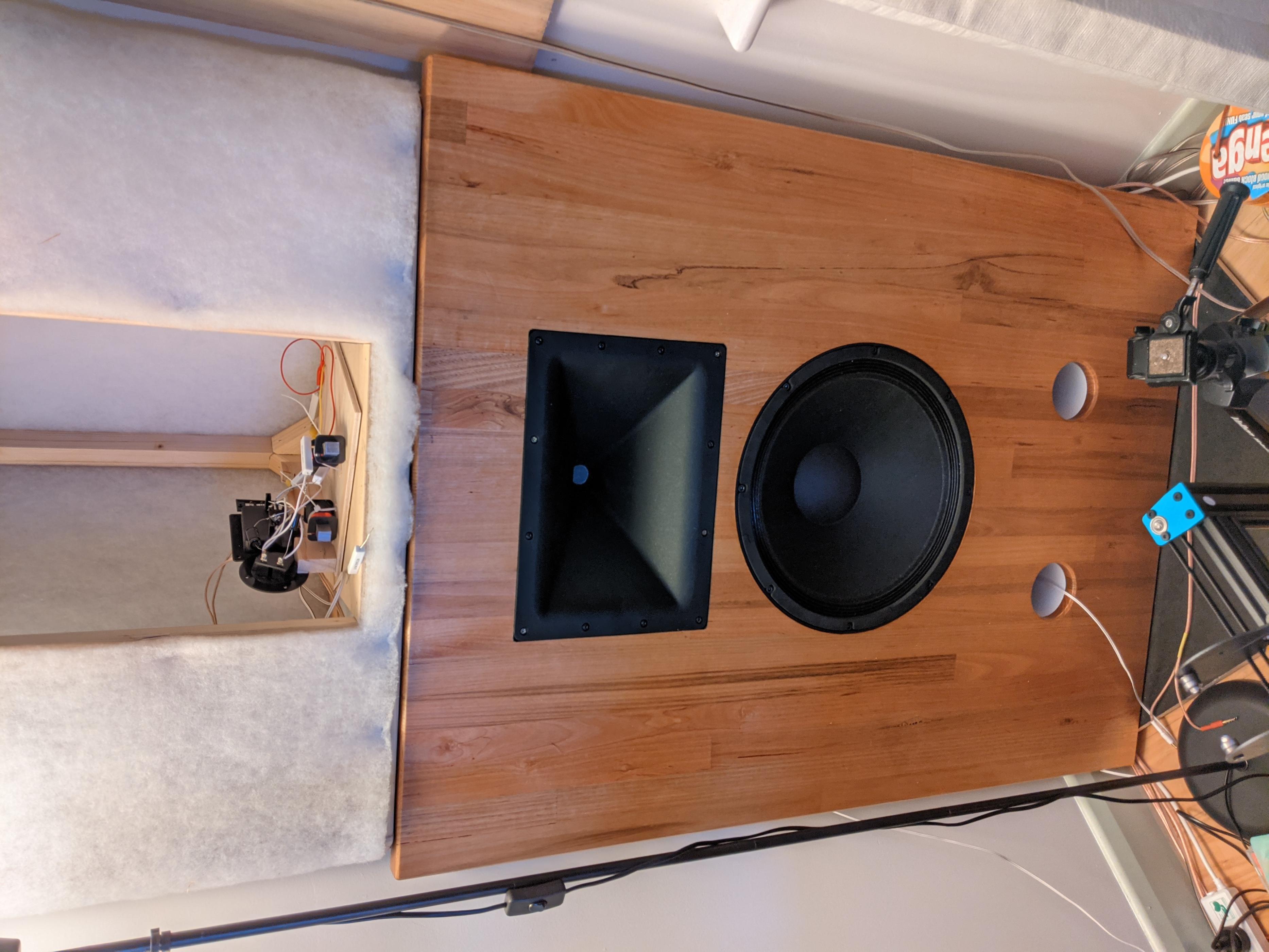

This thread has grown huge in the last 2 and a bit years.. my take on this project has been idle for over a year now, it consists of a faital 15pr400 in a 200L ported corner box with a peerless 2535 compression driver and the QSC clone waveguide, with a passive crossover prototype at 1.2khz
It sounds pretty good, i may start a thread for some feedback on the crossover
Apart from that, I have just ordered a secondhand pair of jbl 2453j compression drivers, and i plan on building another set of K402 horns to use instead of the smaller 1 inch drivers above
hopefully this gives someone ideas for their build

The B52.. I'm trying to cross as low as possible to match the woofer directivity with the lowest frequency the compression driver/waveguide will do, but the margins are small.
That's why i jumped on the larger compression drivers. It's all about compromise at the moment
I am not entirely sure how camplo estimated the TS parameters but following the CLIO Pocket review this is at least a two step processing with free air and known volume measurement:
http://www.audiomatica.com/wp/wp-content/uploads/CLIO-Pocket-Review.pdf
The dats does free air...then you have to add enough mass to the cone to lower fs 25%, for it to figure vas using the known added mass as an offset...I used a putty as suggested.

as you can see from the video, its not exactly challenging to use the datsv3...

one thing that doesn't seem to change much is the prediction of motor strength...though not "broken in" per say...Im getting 19-21tm for all the 18H+'s...I'm going to try another session of 10hz tones on the 15m to see if anything shows a trending change.

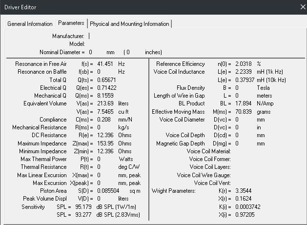

Lets say eventually I come to the conclusion that the reported motor strengths are correctly measured...
19-21tm for the 18H+...
and 17 for the 15m..
where it should be 27tm and 23tm are the spec'd motor strengths....What should I expect Acoustic Elegance to do....what should I do in the event that Acoustic Elegance has stone walled me, given I have not heard from them in 4 days now?
Which is why I don't understand why there is so much noise and odd peaks in your measurements. Without a good control measurement to a driver enough other people have measured makes it impossible to rule out a measurement error.

Simulate boxes for them with the measured specs and see if you are happy with it.. otherwise sell them or send them back for a refund, then choose something else from a different manufacturer
There is no spec'd motor strength for a 16ohm TD15M on their website that I see.
8 and 4 ohm Bl are spec'd 17 and 11.81 respectively and their Bl²/Re are quite close to one another.
I would hope that your custom ordered 16 ohm version Bl²/Re would be in the same neighborhood.
I proposed 3 options for what could be wrong and fluid has just reiterated the 'camplo measurement error' option.
Your impedance measurements are whacked. They look awful. Something is wrong and you need to rule out error on your part.
As far as your "what should they do" question? Honestly I think you waited too long to report a problem to them and that their obligation to you is expired. They could offer to fix it but not, imho, at their expense.
