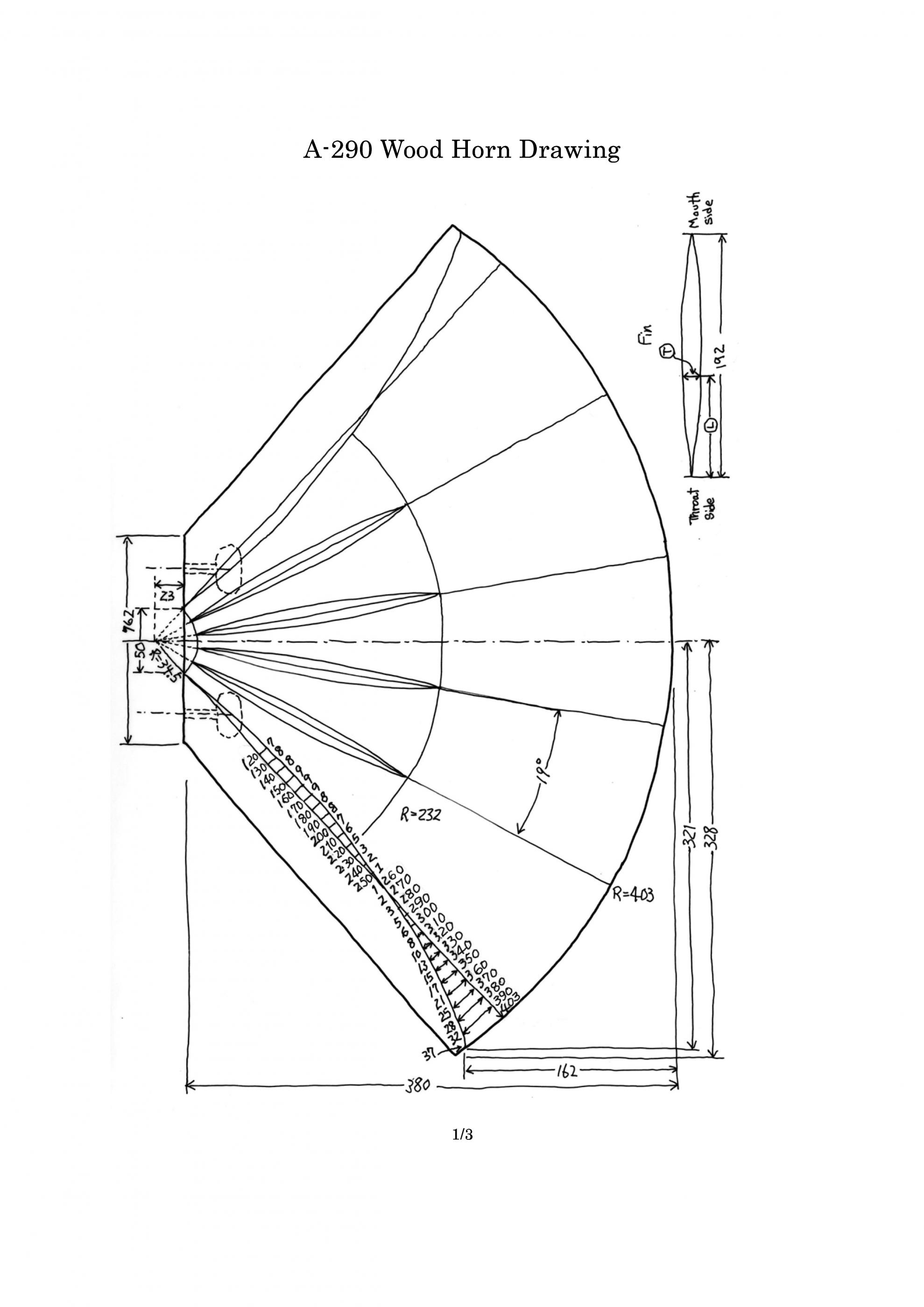

Legis uses the HF108 with his A-290 + throat adapter.

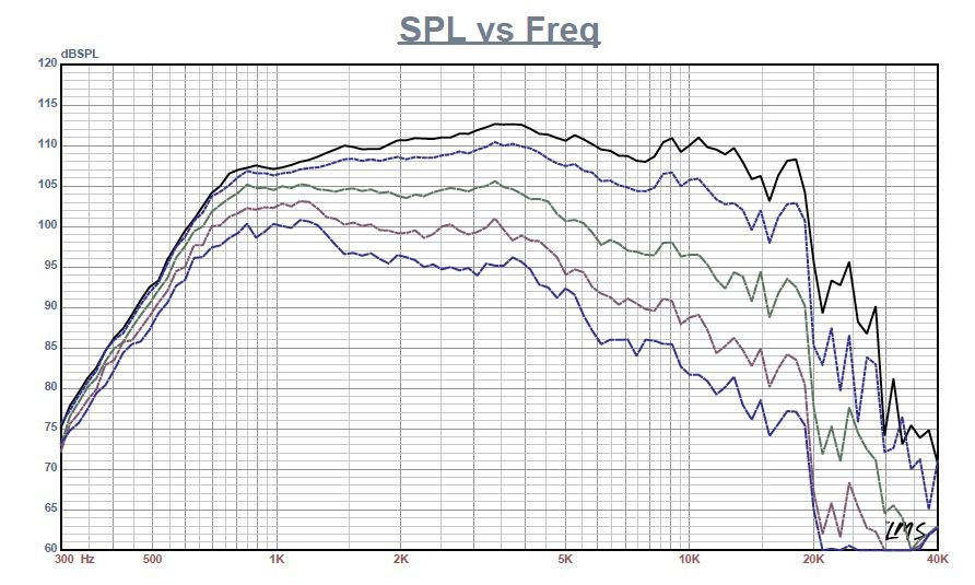

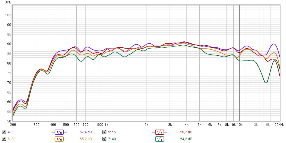

This is what loading from a 38 cm deep horn (excluding adapter) looks like:

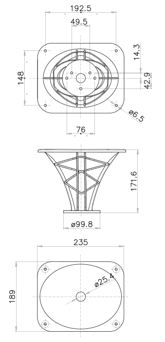

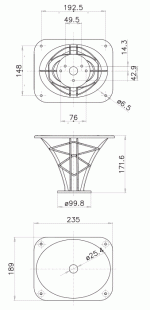

Compared to the same driver with Faital LTH102, which is still 17.1 cm deep, so considerably deeper than the average waveguide.
