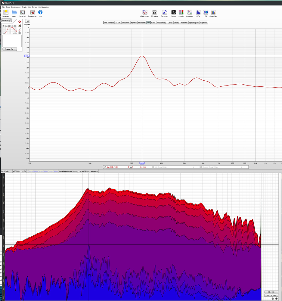

Im open minded, educate me! Measurements speak volumes. Theres a peak in group delay and decay in my 350hz horns at basically 350hz so, so far me 1 you 0...
Theres also modulation in the electrical impedance showing the harmonic modes I spoke of as well...
I've shared all my measurements once before let me know if I need to again....
Actually I'll attach some graphs, hopefully to help square this out.

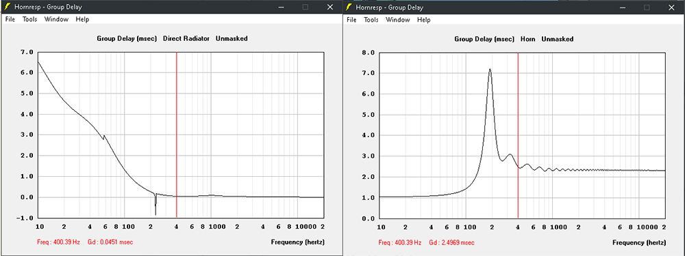

The 3ms group delay at 350hz can't be good for SQ....I mean we want to see under 2ms by 100hz....Burst decay is new to me but peaks are not the goal
I don't know where to start. For one thing, the group delay and the frequency response of the horn alone are in fact the same thing (as long as it's a minimum phase device, which no one has ever shown otherwise). After you think about that for some time, think about the frequency response behind a crossover, and the summed frequency response of the whole system. You will realize that 1) any horn equalized to the same frequency response will end up having exactly the same group delay, and 2) that it's the crossover that determines the group delay of the system as a whole - there you can make by far the biggest difference, even eliminate it to a large degree.
The raw group delay of the device alone is virtually irrelevant, as is its freqency response, as long as it's smooth and clean and the output is high enough for the intended application.
Yeah I've got work to do I guess....cause thats the farthest thing from the truth that I know....but hey, ya learn something new every day.....the group delay and the frequency response are in fact the same thing.
If you have any visual proof of this...that usually helps me.
When I spl match my sim of the 15" woofer vs axi on 150hz horn the group delay is not the same at the spl matched frequency so yeah I am loooossst
According to your words at 400hz where I matched spl GD should be the same...

Here is one measurement
We can see the knee at 300hz....this horn is only good till about 600hz...its basic horn theory, you know this already I would think...to play properly to 300hz, you'd need a 150hz horn....at horn fb there is a peak in Group delay that is no good for SQ as well as a peak in spectral decay, also no good for SQ....Fb on this horn is at or near 300hz.
Funny!!! You do know i made those measurements, right? And that they had a 300Hz LR 96dB/oct linear-phase high-pass in place?
It better have a knee at 300Hz !
The measurement post . https://www.diyaudio.com/forums/multi-way/368378-me464-horn-2.html#post6549756
Btw, the knee is without any peaking in group delay.

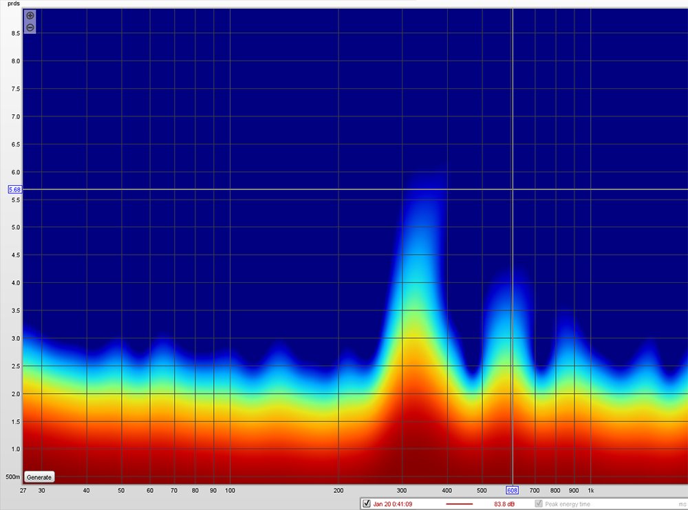

It would be great if you would just share your group delay measurements...and burst decay...and electrical impedance if you have that....heck just share rew file while your at it!
Ok I think I figured it out...you are speaking on how group delay and phase are as you say, the same as frequency response, because of its relationship, being a minimum phase system or something along those lines?
Maybe I have something to teach you then...group delay follows the same trace as time to peak energy....instead of just simply being a derivative of the phase, it is exactly what I describe and just like phase...there is only one "correct". If you will take a REW measurement of horn into rew...open up the spectrogram tab at highest resolution you will see that the trend of time to peak energy is almost an identical copy of the group delay....theres no reason why a higher frequency should take a longer to reach peak energy than a lower frequency but the GD hump at the tuning note does just that as you go below it. This is a result of pressure at tuning lagging the diaphragms motion...highest pressure is at the tuning note. In the several years on this forum, I am the first and only person here ,to my knowledge, to make connection of group delay, to time to peak energy. So I guess this is new for you too.
Group Delay of 3ms at 350hz isnt good for SQ nor is group delay best in the area in front of tuning...
Decay is obviously peaking in the area of fb...
Excursion is modulating in the area before it...
All good reasons why crossing over 1.5-2x fb makes perfect sense
