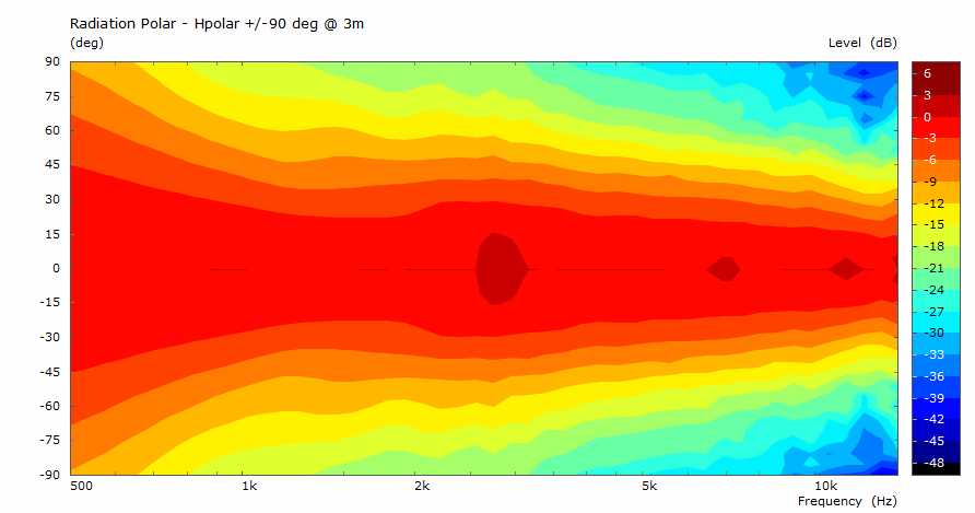

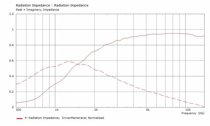

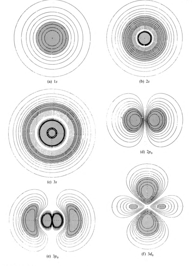

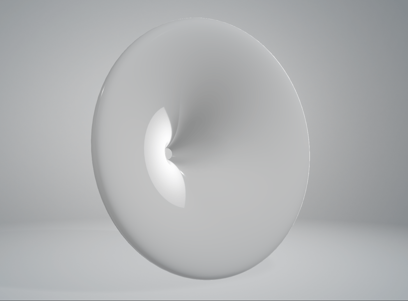

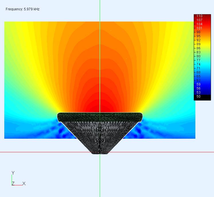

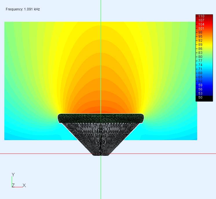

A few toroids were shown already. I bet many of us have wondered whether the interior of a (horn) torus would be suitable as horn.
Based on a somewhat alternative/novel, analysis of macrocosmic and quantum phenomena I derived one.
It's not identical to a (horn) torus, because based on electron (trajectory) shells.
The parametric equations are quite simple. A moderately talented mathematician should be able to replicate it from his head just by looking at it.
So, does it work?
(Sims courtsey of DonVK)
Nothing groundbreaking, but not particularly bad either. Loading properties are disappointing, probably due to the flare rate near the throat.

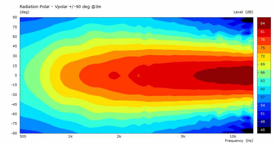

The diagrams that you show are identical to the polar radiation modes that are used in Klippel's and my near-field modal expansion. Radially, the equations for electron orbits and sound radiation are identical and those are solutions to both.
I have suggested this many times in the past.
You could easily introduce an additional all-pass filter electronically into an existing system and listen what difference that makes. People have made such experiments, me included. That would be the real scienceTrue, but that could be said of all evidence.
