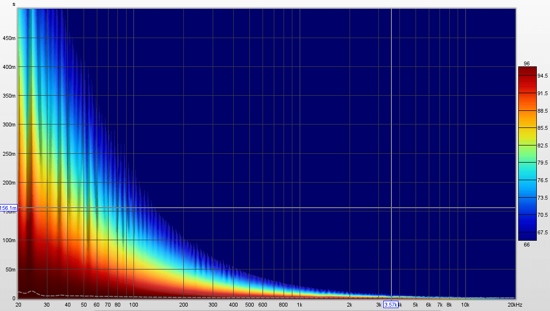

"Examining decay in terms of cycles reveals resonances and ringing issues clearly as additional oscillating periods" - Burst decay is a way to see Cycle time normalized to Periods. I can see the sense in it.... but in the case of keeping cycle time even across the whole Spectrum... Bass sets the bar, since it will always limit how low you can go.... and whos got a good even Spectral decay through out the whole spectrum? I don't even have that in headphones.
(normalized, mic laying on one of the headphone channels)

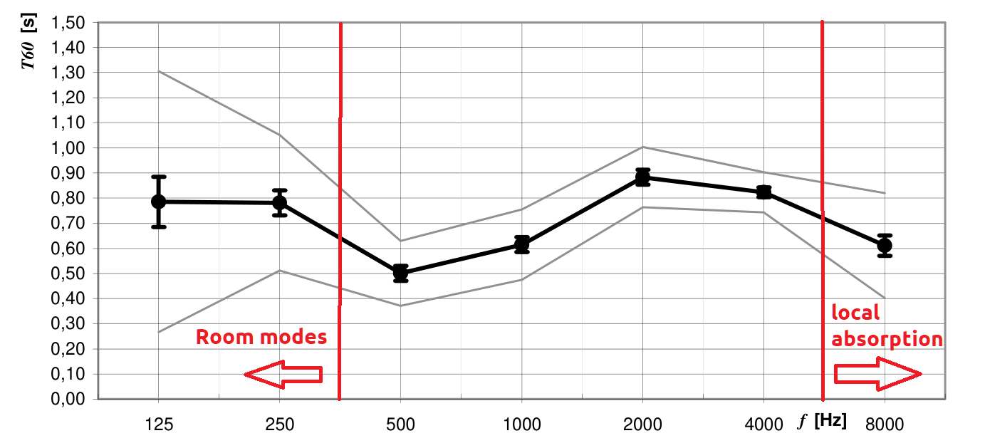

Here is a graph of some measurements I did many many years ago (was working at an acoustic consultancy company back than). I can't remember how many positions this was. It must have been in an average slightly bigger office room with at least ten positions. (since the standard error bars are quite small)
Out of those positions I calculated the standard deviation (SD) as well as the standard error (SEM).
This is what I did typically back in the day.
You can very clearly see that the T60 is clearly spreading above and below certain frequencies.
(most acoustic companies call the graph RT60, but the reverb time itself T60 btw, I forgot why)
Correlating this back to the actual measurements, you will see this also in just the SPL graphs as well.
In this case this must have been an empty room, with enough furniture you will also see those spread lines going bigger.
Depending on the size and absorption coefficient of these things.
This is a typical graph, I have measured quite some rooms this way (also living rooms).
This is also the main reason why I still doubt that constant directivity is such a thing above 8kHz, since the local absorption can be really high but also the SEM will grow much bigger (= NOT constant in a room)
The reason I find a (R)T60 more useful is more because other companies use that method as well.
So you can compare your results immediately.
Something which can't be done with the other graph.
Reverberation needs to be good and constant through the whole room, not just on the listening position I think.
