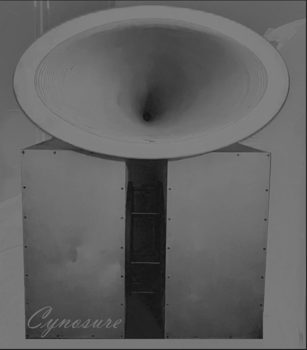

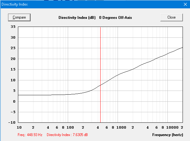

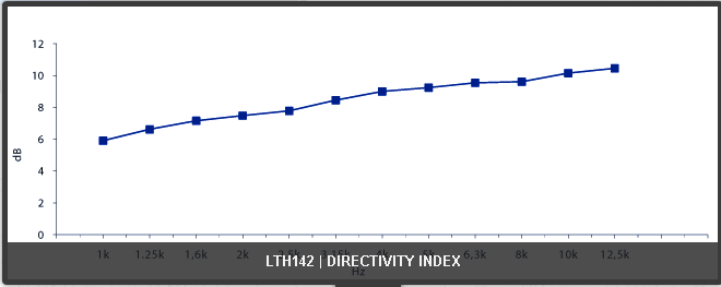

This is the DI HR shows for my mock up horn, that has a very slightly higher cutoff (about 15hz off) and is round, but still tractrix. My horn is elliptical, so the high frequency DI might be closer to an even smaller round horn, and the slope of the DI more like below. The above is only ~3.5db per octave. ~1db/oct. Why am I quoting the slope of the DI? Because a flat DI isn't the only version of Smooth DI. Smooth transitions are the key.
Smoothness is important, but so is the flatness. A rising DI is not CD and so the critical distance will move with frequency - not to my liking.Why am I quoting the slope of the DI? Because a flat DI isn't the only version of Smooth DI. Smooth transitions are the key.
