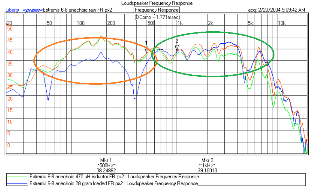

This report by Adire Audio is not entirely correct. The problem lies in the erroneous interpretation of the results they obtained. This statementIts Vas, Qts, Xmax and Le in particular sets the various performance parameters.
Guess what - we just answered the original question! It turns out that transient response of a woofer is not a function of the moving mass, as is commonly espoused (one of the most infamous audio myths). In actuality, it is based upon the inductance of the driver. And the greater the inductance, the slower the driver - the lower the transient response.
is actually wrong because the added mass and the cone stiffness make up an oscillating system. The added mass method is perfect at low frequencies , when the cone approximately moves as rigid piston. However, in the mid frequency range the added mass and the cone stiffness form an oscillating system, whose resonance frequency is dependent on the added mass distribution over the membrane surface and on the fixing strength. Thus, the added mass and the cone will not move as a single moving mass at higher frequencies. The added mass method is valid in the frequency range well below a resonance frequency of the oscillating system "cone stiffness-added mass".
Let's take a look at this picture and try to analyze it. Red is SPL of the raw driver, blue is the driver with 28.5 grams mass added, and green is the driver with the inductor in series (no added mass). Does anyone have any ideas about what's wrong with the blue graph ?!
The blue curve has added mass and it makes an existing cone resonance much worse. This will change with location of the added mass. But the hole is still there without the added mass. Above 1 kHz and this is mostly radiation from very near the voice coil.
That blue line??? That makes no sense by just adding mass. Just compare a JBL 2234 vs 2235. The 2235 has a 35g mass ring added everything else is equal. The result is a shift in Fs and an increase in LF extension and a decrease in midrange level.
How did they add the mass???

I noticed that sensitivity o the loudspeaker with the added mass is equal in the midrange to the sensitivity of the raw driver, which is not entirely consistent with the classical T-S theoryThe blue curve has added mass and it makes an existing cone resonance much worse. This will change with location of the added mass. But the hole is still there without the added mass. Above 1 kHz and this is mostly radiation from very near the voice coil.

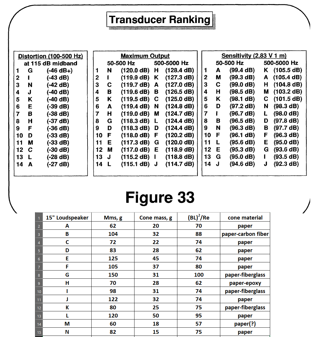

Sorry to sound a bit grumpy on this one, but please go read those books.I thought mms had an effect on distortion vs spl. Lighter cones having better distortion at lower volume, higher mass, lower distortion at high volume?

That being said, you can NEVER mention just Mms without mentioning the BL as well.
In addition to that, it's very simply the BL(x) and Kms(x) graphs that count as well as the measurements.
There are woofers with a (relatively) high Mms that perform great.
There are also woofers with a (very) low Mms that perform absolutely horrendous.
It's quite a useless discussion without knowing the context, aka the rest and quality of the motor and structure of the woofer itself.
WAY to many variables.
What people do is just mirror and parrot each other, without showing any additional fundamentals of measurements.

Agreed, I sometimes will resort to assumptions just to get the ball rollin since I lack the ability to accumulate enough data to be sure on a theory. My assumptions were based off of the above chart, I did think about BL and realize its a factor. Assuming that a good spread of driver is on that chart above, including those that perform the best in certain aspects displayed, it is the heaviest mms driver that has the lowest distortion at high volume. The lightest cone, has the highest distortion.... It is not lacking in BL vs Mass. It has higher BL ratio than the 150gram mms driver. This same driver has the highest sensitivity ratings and lowest mms... Still very unscientific without seeing the distortion levels at 2.83volts, I know. Is it unfair to think there might be an advantage in distortion at 2.83v for this style of woofer, given the general relationship of efficiency to distortion? I don't know for certain but there is likely some truth there.What people do is just mirror and parrot each other, without showing any additional fundamentals of measurements.
I got lower thd measurements from my single 15" vs the dual 18" ppsl in the upper midrange. I thought this complimentary but to draw conclusions without more strict testing isn't good science. I figured if there was some truth to it, it might exposed in the thread through conversation.

It totally depends how they optimized the motor as well as the cone.I got lower thd measurements from my single 15" vs the dual 18" ppsl in the upper midrange. I thought this complimentary but to draw conclusions without more strict testing isn't good science. I figured if there was some truth to it, it might exposed in the thread through conversation.
So it's so hard to draw any direct conclusions.
Obviously, always within boundaries.
If we are gonna compare extremes, things are more obvious of course.
Exactly!Theoretically, I don't see how there could be any relationship between mass and nonlinear distortion. Mass is perfectly linear, unlike almost every other variable in a loudspeaker.
Basically, the only thing you will notice, is that the freq resp just collapses.
Because that is exactly what mass does.
Although that is looking at the picture from a theoretical view.
A lot of very light cones all suffer from severe impedance mismatch, often resulting in all kinds of problems.
Often resulting in non-linear behavior and distortion.
Technically speaking that is not just the Mms.
The thing is that these mismatches show up as frequency response issues. They will not show up as nonlinear distortion -"impedance" is a linear concept. The mass compliance issues of a wave moving up a cone are basically all linear except in extreme circumstances.A lot of very light cones all suffer from severe impedance mismatch, often resulting in all kinds of problems.
Can we relate mass to le or a high pass filter?Basically, the only thing you will notice, is that the freq resp just collapses.
