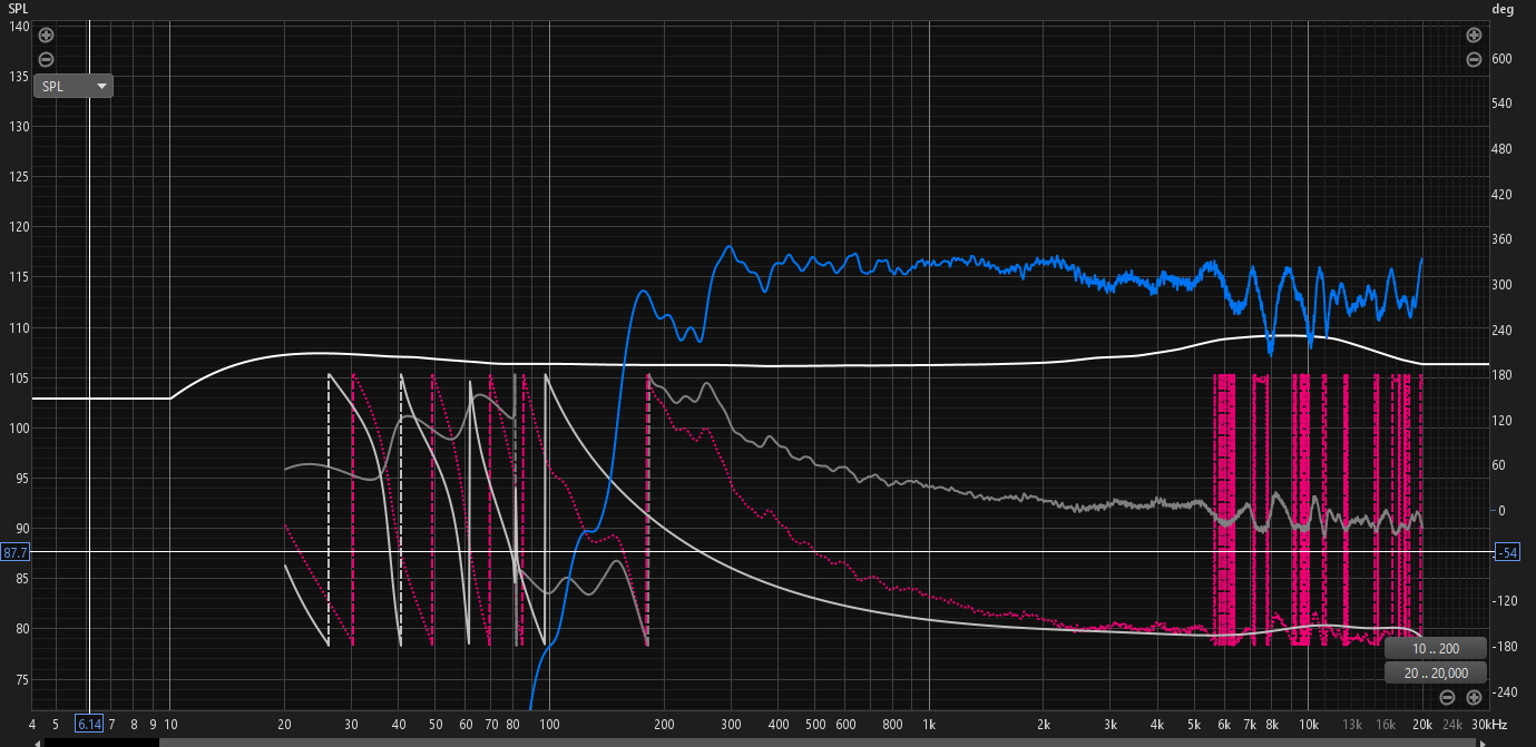

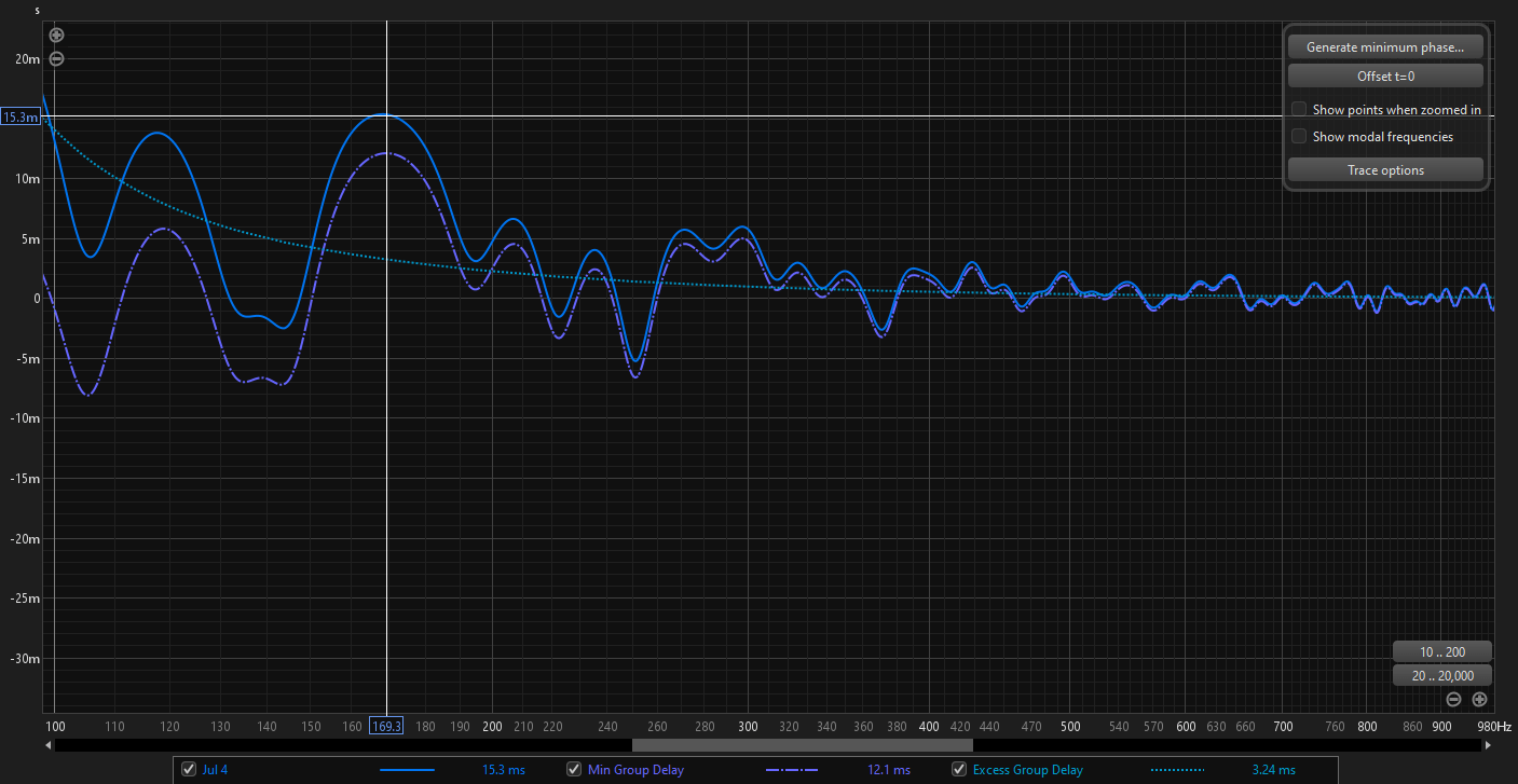

Experimenting with the worst parts of my spectrum, I used an outside measurement, which are about 15ms at 167hz and about -10db from the fundamental level. I used an all pass centered on that frequency with a Q of 8.81 to achieve the same group delay, according to Vituixcad. I used a high pass to experiment with 167hz being -10db. I could hear the difference. The attack time wasn't what was making a difference that I could tell, it was the ringing. It was a similar event to reverb that had a fundamental resonance centered on the particular frequency. I am very interested to try this with the horn. With the high pass, it was just faintly discernable in vocals of J Cole, rapping. bypassed it the vocal as every so slightly dryer in the area of focus. Then the song has a transition to another part where there is a very punchy kick drum taking lead... this is more like an impulse response, and I can hear the Hf of kick drum ringing clearly how ever subtle the change is I can hear it distinctly.
If you look at the FR, it is not, smooth, nor a final voicing. I just set this up quickly to test headroom at that moment. A better voicing should create a better result and there's also the question of accuracy of my testing to what will happen with the loudspeaker. I have been doing critical listening for some time now and these changes very subtle. If I am going for utmost accuracy I still must consider addressing these issues.
The GD at the trouble area is 10ms in raw response, and with equalizer apo set to match that GD, everything is fine. The change is barely noticeable using tone burst of rectangular windowing, as in virtually non existent. In the measurement below is a minimum phase 48db/octave LF high pass at about 180hz. I think that is just more reason to think that I can do better with better voicing, but I won't be certain what needs to be done until I have the horn up and running again.

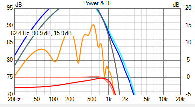

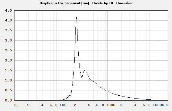

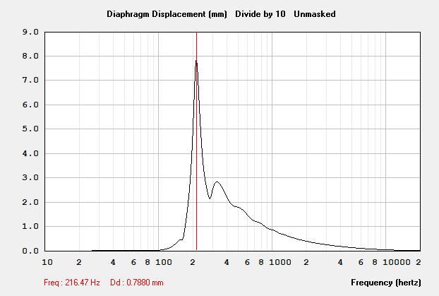

Tonight I did some more modelling. In horn resp I can ballpark the drivers characteristics but not the horn response. Horns/waveguides do not change the nature of excursion. It looks like large horns do help to curve excursion below cutoff more so than a pure waveguide but that is neither here nor there in the face of a high pass used for crossing above the F of a waveguide. Because of this, I should be able to use horn resp to ballpark excursion. I loaded up the raw response into VituixCad, and created a voicing. then I loaded the filters into Hornresp, in particular the ones near the roll off of the horn, that mattered most for this exercise. From there I could adjust voltage in vituixcad to achieve certain spl, and then try it out in hornresp to see where it might take me, excursion wise. 1db increments the graph, looks like the XO point is at about ~212hz. This isn't much different than what I've achieved with the rough voicing so far, which is probably about 215hz -6db.
112.5db
107db
Respectively this is what would be potentially asked of each horn for 115db and 110db peaks. From what I've seen 15db headroom is about standard over average and 95db average was the max safe average for something like an hour. This may explain why I have not had an issue with thd as the excursion is about 0.6mm during transients listening at 95db average, which is loud enough for me. As a system, things will keep transient excursion near half xmax and that is desirable.

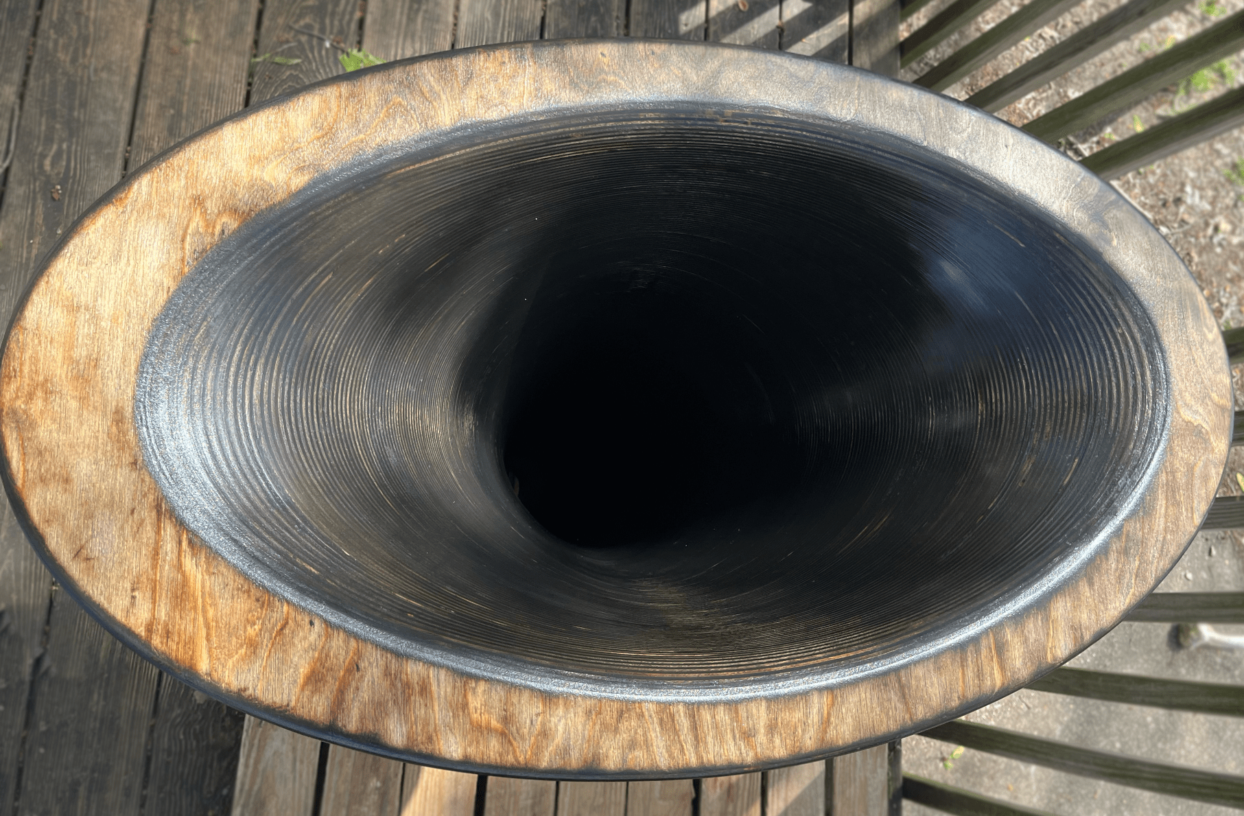

Hello Camplo

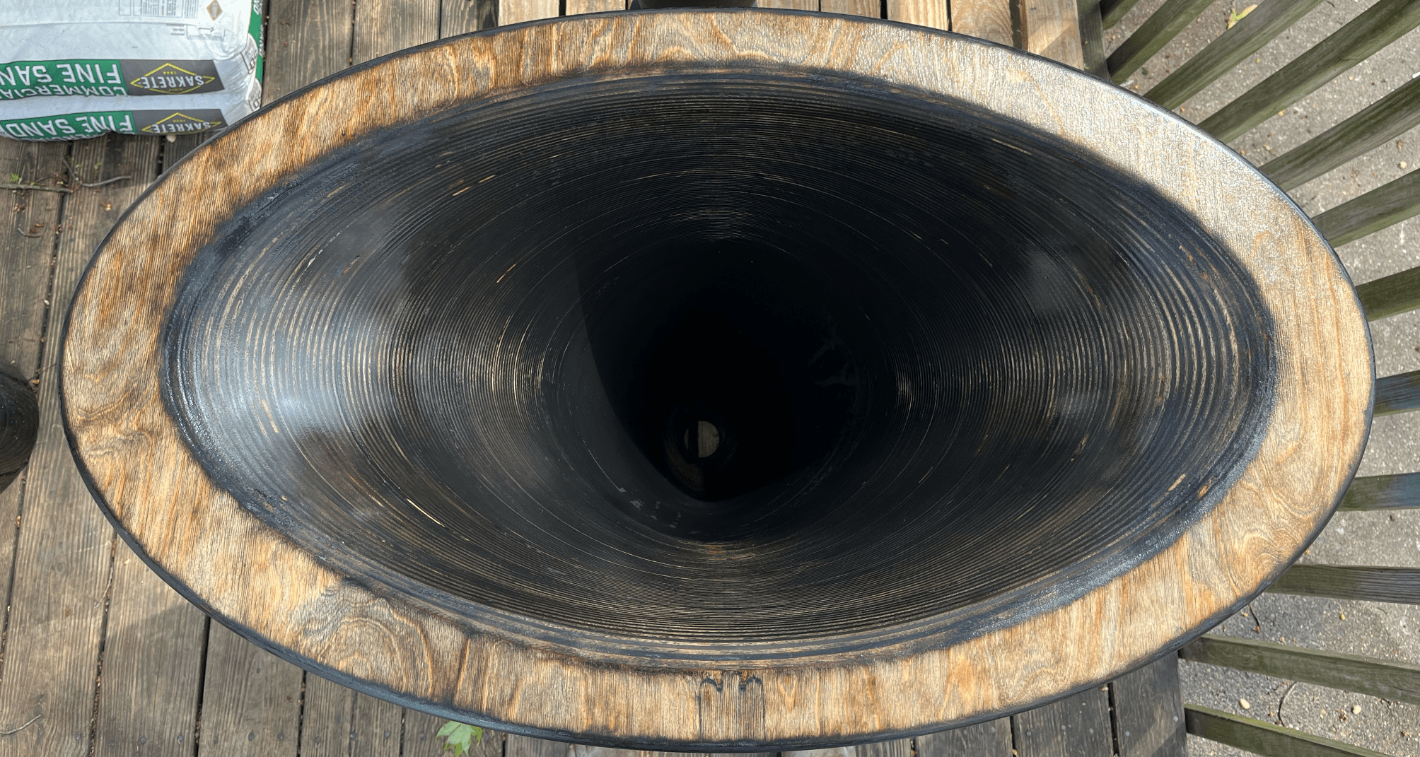

Have you considered a paint/clearcoat combo?? Inside x color rim clearcoat outside ?? does it look that same as in. Very hard to judge how big they are. Do something that goes with a wide range of decor's so if you move them someday they won't be an eyesore.

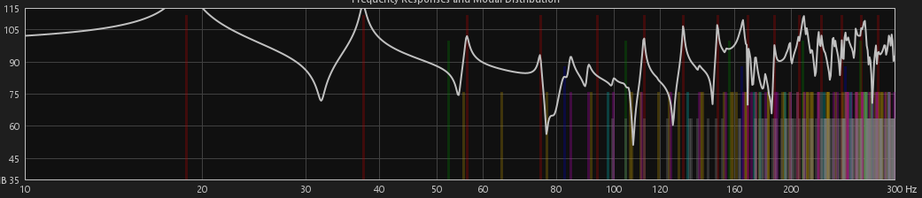

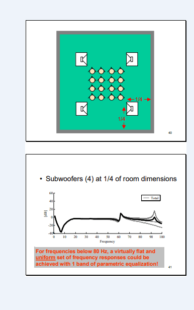

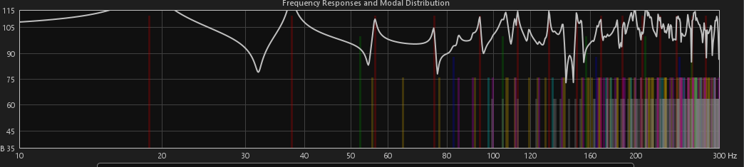

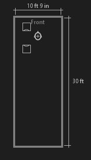

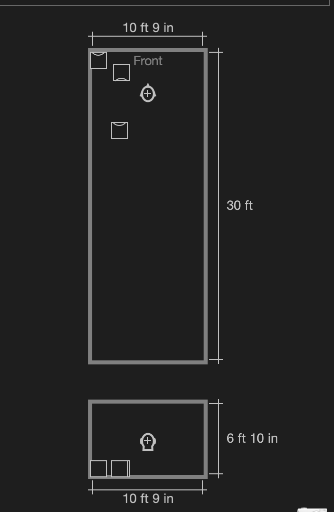

What is the height of the listener and the subs? Is it the same as in the trials?I cannot recreate this in REW...but not sure why.
These positions are great but they always forget the vertical behavious. Subs should be in the center of the room height for this setup ... not often possible ;-)

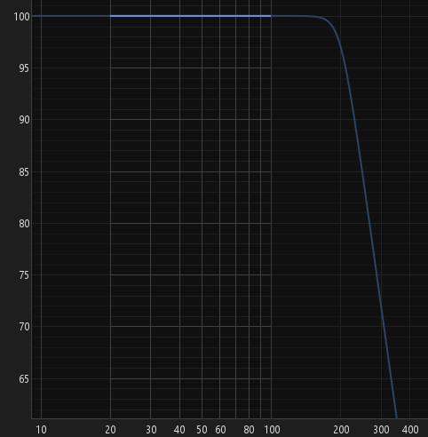

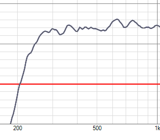

I envision, a woofer, front and back, that is time aligned and phase/gd aligned to the listeners position from 20hz to 300hz, given that it sounds to my liking. What I find questionable is the area above where the two drivers coupled, ie ~100hz. The enclosures will be in corners so I view the rear woofer plus wall, as a sort of folded horn. 300hz will be pretty buried in slope looking at a 24 and 48 db/oct filter. I know this approach I am describing will result in a more disperse sound, but it is possible that with everything aligned in the time domain, that it won't be a very significant change.

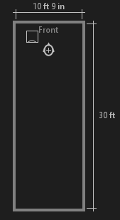

Solo main
Faux bipole
vs
Independent woofer placed behind listener.

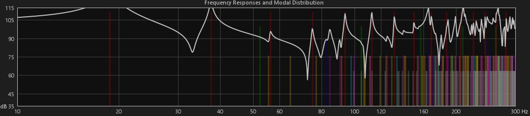

You can vary the FR with the position of the rear sub but, the Bipolar sim has a better FR in particular through near the top of the intended register, hence my curiosity. Not the best sim of bipolar but it is in the ball park. Look at the Vituix sim

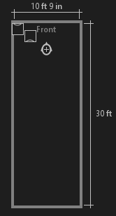

Single front woofer
vs
Bipolar with time alignment
It seems I should be able to improve the FR with a corner loaded bipole, is what I am getting at. Corner loaded bipole vs independent quad stereo sub placement... with the independent woofers, I am still limited to about 120hz for the low pass, correct? If still choosing to run this higher, the FR is not as refined as the Bipole. With the Bipole I can still chose to be limited to 120hz on the rear woofer, but benefit from coupling from about 100hz down plus the potential to improve FR up to 300hz if I like the sound of it running that high. I cannot simulate it, but with time alignment and phase/gd aligned the bipole response might be really good at the listening position

Name the two sources (or more?) which will be time aligned to the listening position.I envision, a woofer, front and back, that is time aligned and phase/gd aligned to the listeners position
I am talking about a stereo system but in particular a bipolar woofer section under the horn. One woofer in front, second woofer in the rear. 300hz and lower if acceptable, from both woofers. Below are examples of where 300hz could land.
If I were to go the independent positioned woofer route, I would like to keep it symmetrical. The second redundant woofer would be placed behind the listener. This option is sorta straightforward. The bipole in a corner presents a better route to have all woofers running to a 200hz xo point. I pointed out 300hz because in my experience using a 48db/oct filter on the horn, up to 300hz needed to be covered to support the horn through the crossband.
