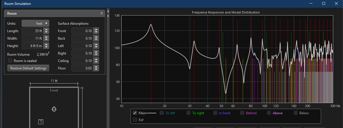

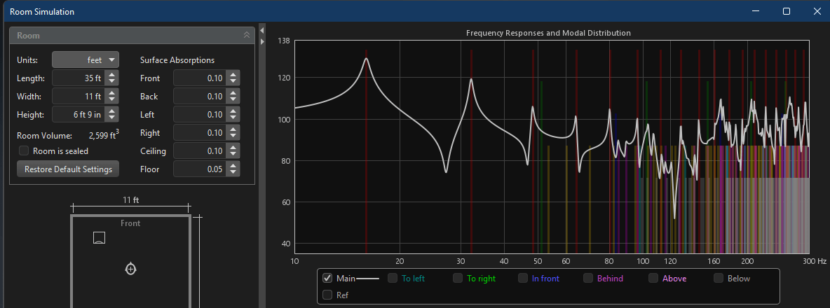

Playing with the simulator I did not see a huge improvement with a subs arranged symmetrically in quadratic stereo. Also rear subs would require another amp/dsp. So far I can run everything with 2 amps in the fashion of a two way

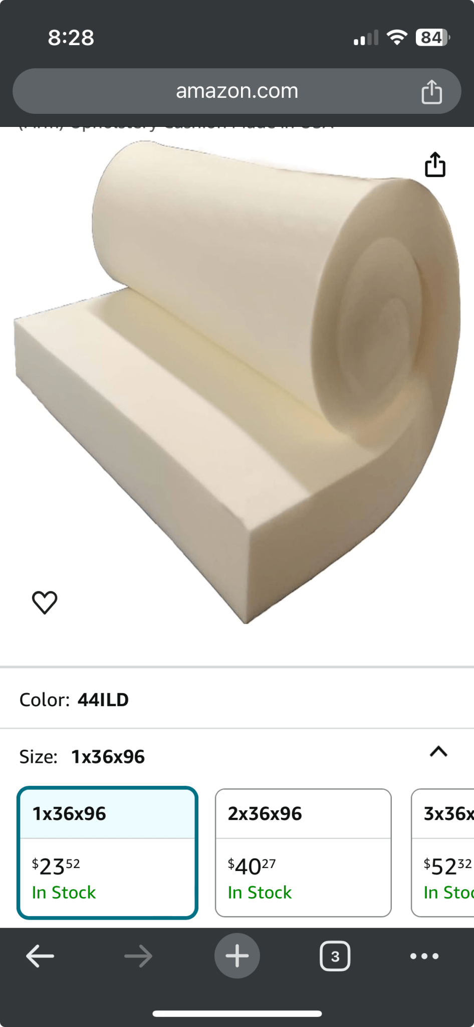

I am really doing myself an injustice by not trying to dampen the slot vs redesigning it 😩I think I can narrow it down to some visually interesting yet effective solutions
Cotton rope
Acoustic ceiling tile
Open cell foam
I think cotton rope is a good choice but importantly to me these options allow a uniform organized approach that would be visually pleasing if done right
This is cheap n thick

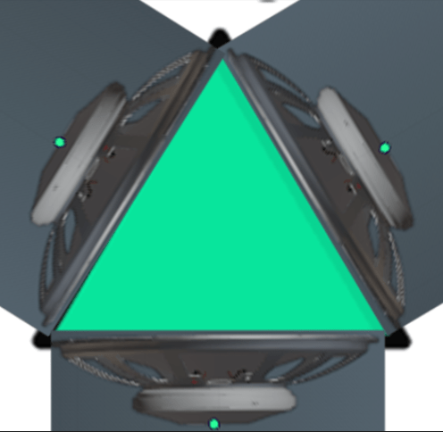

Thank you guys for your continued patience, there is one thing, I cannot simulate but I think your experience and knowledge could predict the outcome. please consider the effects of the use of damping material, as well.
There are 2 slot configurations I think could work.
One is a Tringle with a driver on each plane. This maintains equal force cancellation, and after damping material should have a decent FR
2nd Idea is a tetrahedron.
Basically a tetrahedron shaped waveguide with the woofers offset on the three planes. This would be better acoustically but not have as much force cancellation

The tetrahedral orientation creates a conical horn, it could simulated in Hornresp.
The volume of the triangular cavity could be simulated in Hornresp same as a slot.
Damping material could reduce some of the cavity resonance.
Either triangular or tetrahedral orientation work OK for low frequency use.
Long term cone sag is a problem for either, and the effect of gravity compromises symmetry in use.
Simulation programs won't account for those, TS parameters are for vertical speaker alignment.
Most frontal area reduction schemes use two or four vertically oriented drivers in a "V" to avoid those problems.

The tetrahedron is not pure force cancellation, there is still up-down force - assuming three drivers. For this reason, I do prefer the triangle tube. This would make for a strong single source, but a single source in a room can be a disaster. I would prefer three small, but individually controlled subs spaced about the room - all closed box. Setup right and the bass in that system would be spectacular.

That looks like closed cell foam, and it is terrible for what you want. You need about 20-30 PPI open cell, or don't do it.
That's unusual. I have yet to see a situation where distributing the subs around the room is not a substantial benefit. Maybe your sim is wrong, most are.
How should I view multi sub versus corner loadeding. First I should say that I am not certain if corn loading has to literally mean dead in the corner, if that's the case then I am probably using the term somewhat loosely as I mean anywhere from in the corner to near the corner. When playing with the room simulator the further a woofer was moves into the corner the more improved the frequency of response was.
Dead in the corner is creates a great response. How does one improve upon that using more?
I am definitely not against multi subs surrounding but I do not wish to use anything that is not symmetrically placed around the listener. So when I play with the simulation I always keep the rear subs a mirror image of the front subs... I couldn't see wanting to do it differently, hopefully thats limiting on performance

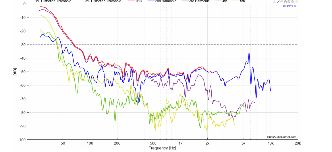

Okay explain to me this why people like Klippel take these different kinds of distortion [HD and IMD] very differently?
I'm curious as to how the Klippel analyzers treat these two types of distortion: HD and IMD. How do they handle them differently?
They even provide a threshold reference in their graphs (I think it's around 3%) which indicates where either/or IMD or HD distortion is to high.
Having a reference threshold seems to simply be a reflection of the fact that "modern design practice" enables a certain level of performance to be achieved.
The problem is that "corner loading" in rooms is a fiction. A corner in an open field, i.e. no opposing walls, with have about 8 times more output (maybe even greater due to efficiencies) and that is across the band. But a corner in a room is a different animal altogether, because all dimensions have opposing walls and hence we now have constructive and destructive reflects leading to mades with lots and lots of gain as well as regions of almost no output. The later is obtainable, the former not so much. Hence, I wouldn't want to compare the two situations becau8se you can never achieve one of them. This complex situation is why DSP control becomes almost necessary, certainly necessary for a "premium" sound system.
Im definitely not against multi subs surrounding but I do not wish to use anything that is not symmetrically placed around the listener.
The double negative caught me at first. I have always proposed a r4andom placement as the most effective and I stand by that.
Don't rely on inaccurate sims, no one - to my knowledge - does the high distributed damping room sim right because iot massively complicates the algorithm.
Doing multi subs will require more electronics but as they say, you get what you pay for.
Yea a couple more amps, I did it with a single 2 channel amp. But amps are cheap and so is the DSP. SUre its more complicated, but that's why it works.
Klippel has some kind of multi-tone distortion test.
But I think they also have a test where they combine IMD as well as HD and check which of the two will be the most significant?
I don't know the exact details anymore on top of my head, you have to dive into the Klippel papers for that.
It's all quite well explained (well, most of it lol)
https://www.klippel.de/know-how/literature/papers.html

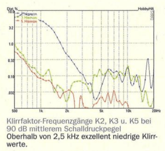

I totally agree with you that just one flat line isn't the greatest, very far from it even.
But since there are no other standards, we have to use something.
A good read on this is;
https://hifi-selbstbau.de/index.php/hsb-grundlagen/verschiedenes/klirrfaktor-wie-viel-ist-zu-viel
(use google translate if you can't read German)
Or a couple Geddes papers obviously.
But unfortunately there is still no or very little general agreement on any of this.
