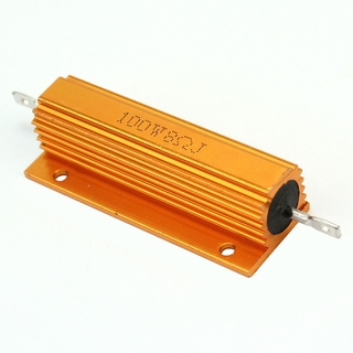

What if I go with paralleling an 8 Ohms resistor to two 4 ohms woofers being serially wired, but I’ll use a large resistor i.e. 100W resistors, as pic attached? Is it acceptable?
I see some crossovers of sonus faber speakers don’t use any caps, instead, they use these heatsink resistors.

If the impedance falls as low as 2 ohm in the bass section, you are highly likely to damage your amplifier.
I have such a loudspeaker going to 2 ohms around 100 Hz. you need atomic centrral to move them well. Chord amps for instance and equivalent !
Better to design with two of these drivers in serie to double your impedance.

I suggest OP you parallel the two 12” and serial with a 1000 watt 2 ohm. You will have a nice sensitivity of 70 dB and you need a 1000 watt amp at steady
4 ohm load to get close to 100dB perceived SPL.
10000 watts peaks if you want to have +10dB dynamic headroom but by then that resistor will probably set your cabinet on fire.
This is a very good idea. Who needs sensitivity when power is so cheap?
That is why nobody else have done it, because only real creative minds can come up with it.
Or just get a proper 12” 8 ohm single woofer, cross at sensible frequency and use your existing amps.
