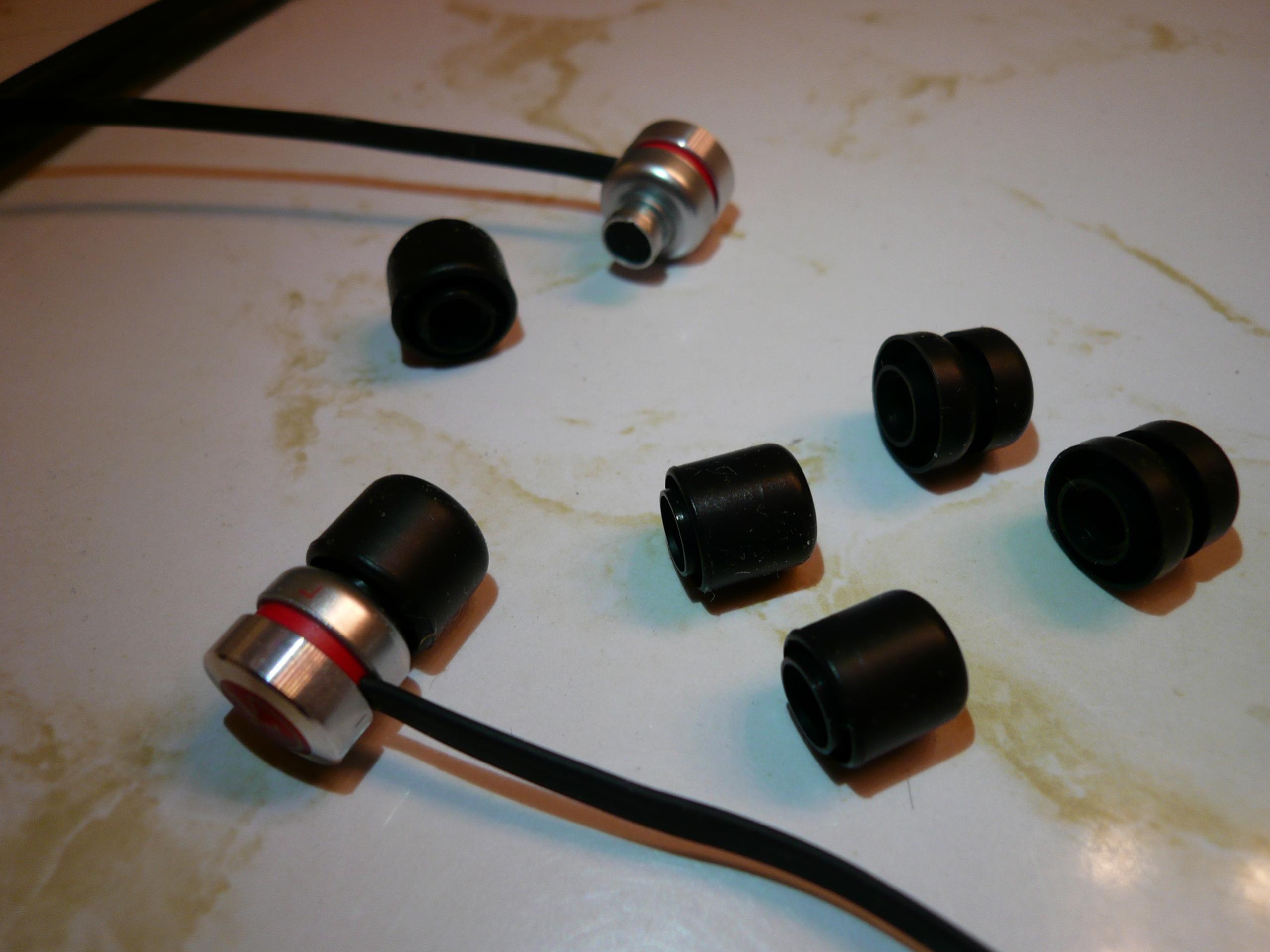

These little isobarics will produce the cleanest, flattest bass you're likely to hear. I believe the FR is very close to perfect. 3 different eq ear inserts. $30.00 + taxAt wavelengths much longer than head size the eardrum responds to air pressure, not air movement. The wavelength doesn't come into it, at least not until the sound pressure variations have passed through to the cochlea. The placement of a headphone cup over an ear is making a quasi isobaric chamber between the driver and the eardrum.

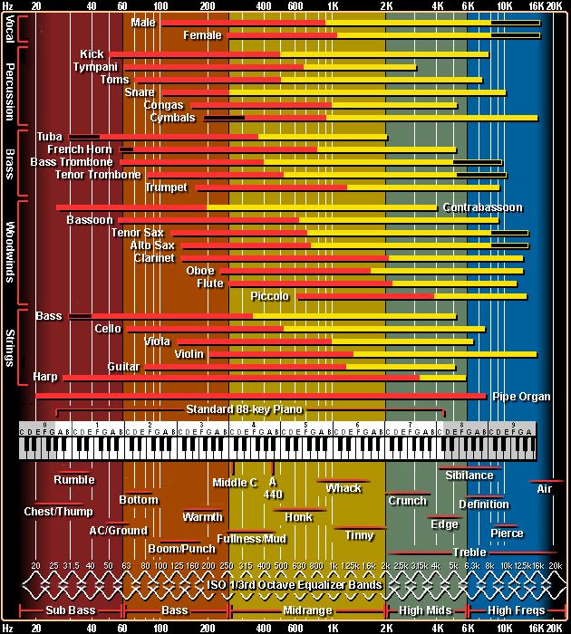

Unfortunately, the chart does not cover 'electronic' sounds.

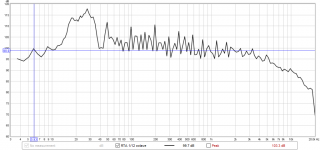

Sidebar: For a while now I've increasingly ignored manufacturer's alleged specifications. I've just played this track: Urban Shakedown feat. Micky Finn - "Some Justice' (1991) - YouTube through all of my subs.
My Vector VW8 (28hz) phoned it in.
My pair of LG7's (35hz) produced an impressive combination of purrs and growls inducing other household items to vibrate in sympathy when under duress.
My Audica Pro (40hz) auditioned for a job in the demolition, hitting the certain notes too hard. Fun fact: air from the port was able to sway clothes hanging on a dryer over 6ft away.
Please, will anybody with there system connect to the Internet perform the same test?

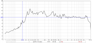

I'll take your "Urban Shakedown" (1st picture) and raise with a re-bassed version of Rob Dougan's "Clubbed To Death" that was in circulation many years ago (2nd picture). Notice what's going on below 20 Hz, compared to your track 🙂
I can't seem to find a copy of it online again, so I've uploaded a copy to my website. PM me for link if you want it.

It wasn't a competition. I'm trying to compare apples to apples. Urban Shakedown is a fairly standard MP3 where I assume everything below 20hz was discarded,
