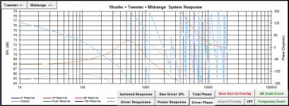

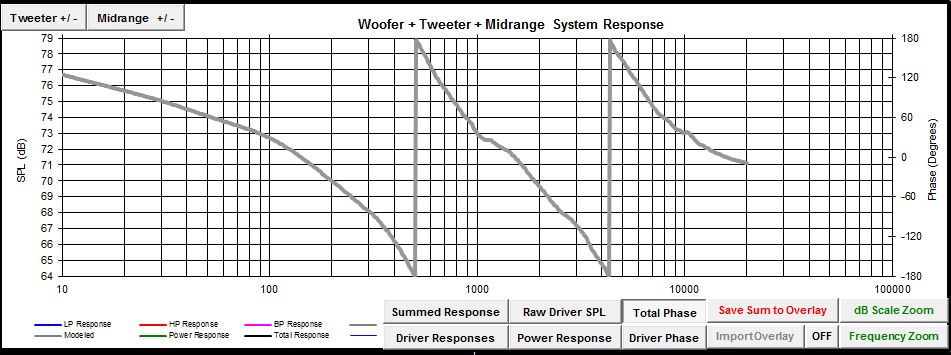

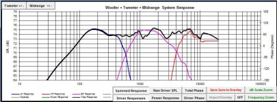

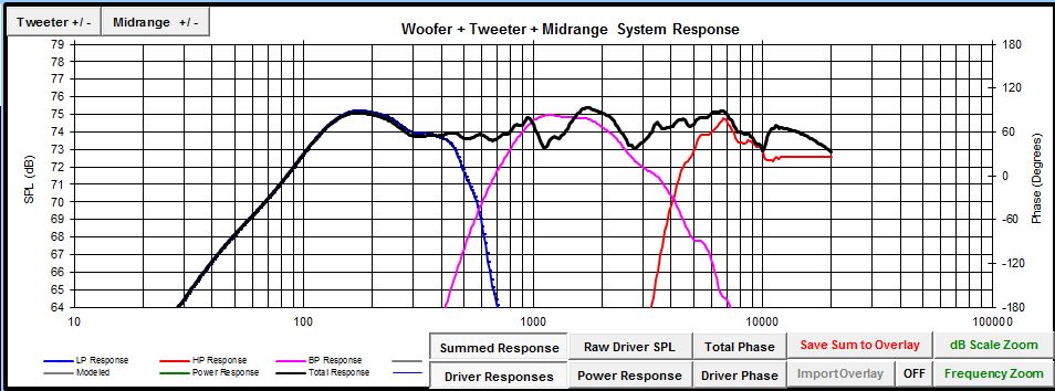

I need your kind help and knowledge for understand if I’m on the right path or not. I’m doing a 3 way project MTMWW (SB 26ADC-C000-4, 2xTB w4-1337sd, 2xRCF L8S800). The idea is use an active XO (miniDSP 2x8) and 3 Crown XLS for run the drivers.
For the measurements, I have a UMIK-1 and an external sound card.
Here the simulation of the active XO based on the in box measurements (minimum phase)
![1.jpg 1.jpg](https://www.diyaudio.com/community/data/attachments/490/490482-15a2ca6b21453194a21e858f6019c9fa.jpg)
After several nights of study, I’m still not sure I’m doing the right thing, and I would to know your opinions on the below
Question #1 – real time delay
I’m struggling to understand if there is a way to correctly measure the driver time delay: I’m using the methodology from “Finding the Relative Acoustic Offset in PCD” written by Jeff Bagby, but I would like to measure the result back to see if the drivers are really aligned after input in the MiniDSP the simulated delay. Can you please help me, or point to some tutorial? Is that possible?

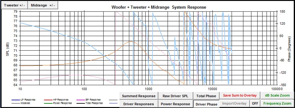

Question #2 – phase alignment
I’m not sure I’ve understand yet the driver time alignment, and when they look good or not. In my simulation excel (Passive Crossover Designer 7 (2007)) I can get the phase – or at least I think so – but I’ve no idea if they are right. Below the results
![2.jpg 2.jpg](https://www.diyaudio.com/community/data/attachments/490/490484-8a5b11d879aa642d5fcdcbd15d8c0f7e.jpg)
![3.jpg 3.jpg](https://www.diyaudio.com/community/data/attachments/490/490490-075e5ce1b6880048bc7c589a22045f3b.jpg)
All the measurement are “minimum phase” before the simulation
Can you please give me your comments or, again, point me to some “good phase” and “bad phase” alignment example, so maybe I can finally get it?

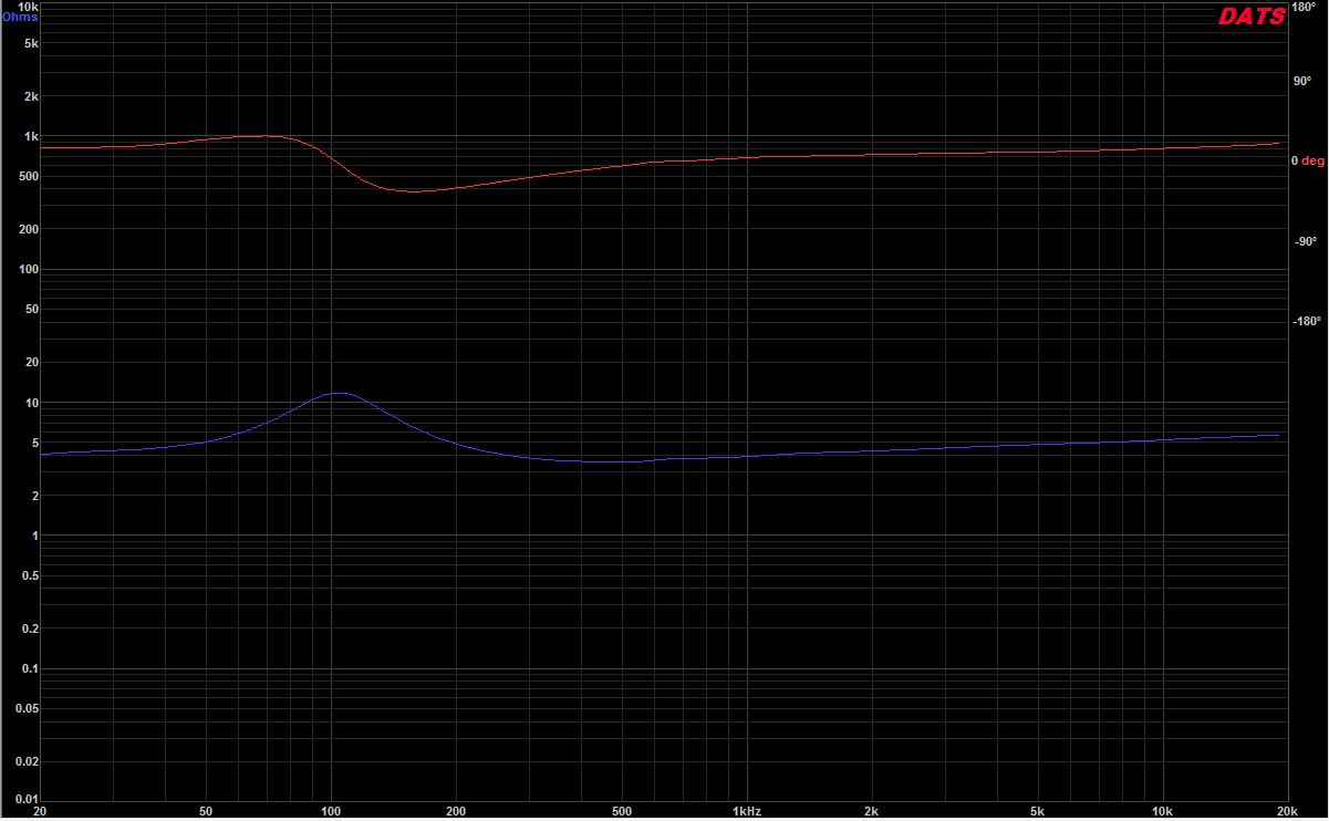

Question #3 – standing waves
I have done all the inbox measurement, and looks like nothing is wrong from the impulse and FR point of view, and I can’t hear anything strange when I run the sweep.
Is there any example or clear way to define if there are or not standing waves, and how to identify them?

Yes, this is easy to do with almost any high resolution tool that measures frequency.
Steps:
1 - Measure tweeter, you may use a capacitor to protect it. If you can limit the test signal to so it excludes bass, that's good in addition.
2 - Measure woofer, no crossover
3 - Measure woofer + tweeter (including protective caps)
4 - Stick measurements from 1 and 2 into XSim (or whatever your favorite free Xover simulation tool is). If you used a cap to protect your tweeter, include it in the schematic.
5 - Adjust woofer delay until combined FR matches results from step 3.
I like to start 5 by estimating it. Measure from the back of the tweeter faceplate to the back of the woofer magnet. That's usually a good starting point. Then incrementally add about 1/4" until you get really close. Then tweak.

With HOLMImpulse you can lock time after your first measurement. That will show you the time offset of the measurements that follow. It works very well. Phase will then be relative to the first measurement too, of course.
There may be a way to do this in REW, but I have not tried it.
Yes, what Pano said works every time. Lock the time after the first driver measurement. This references the time for the next measurement to the first. So, your second measurement's phase will be reported relative to the first measurement. This is all you need as input into the Bagby spreadsheets. Don't use the built in x,y,z compensation in the Bagby spreadsheet if you use this method.
To study cabinet's internal reflections, stored energy and standing waves, first measure the mid and woofer in free air at 1-2cm distance (be careful with spl). Then put them in the cabinet and measure one at the time again at 1-2cm from the membrane. The difference in spl/Fq comes from what happens inside the box. Then try diffrenet stuffing etc. to minimize deviations.
1m distance for measuring is necessary too, because it reveals cabinet diffractions including the baffle step. Measure also off-axis!
I assume by resonances, you mean box resonances as opposed to driver/cone resonances?
Enclosure panel resonances will usually show up as increased harmonic distortion (at the resonant frequency) in a harmonic distortion sweep, and increased cumulative spectral decay.
Reflections and standing waves will show up as a difference in frequency response - measure nearfield as Juhazi suggests.
Severe standing waves will show up in the impedance, though usually these only occur in very large boxes - e.g. a floorstanding speaker with a chamber that runs the full height of the box.

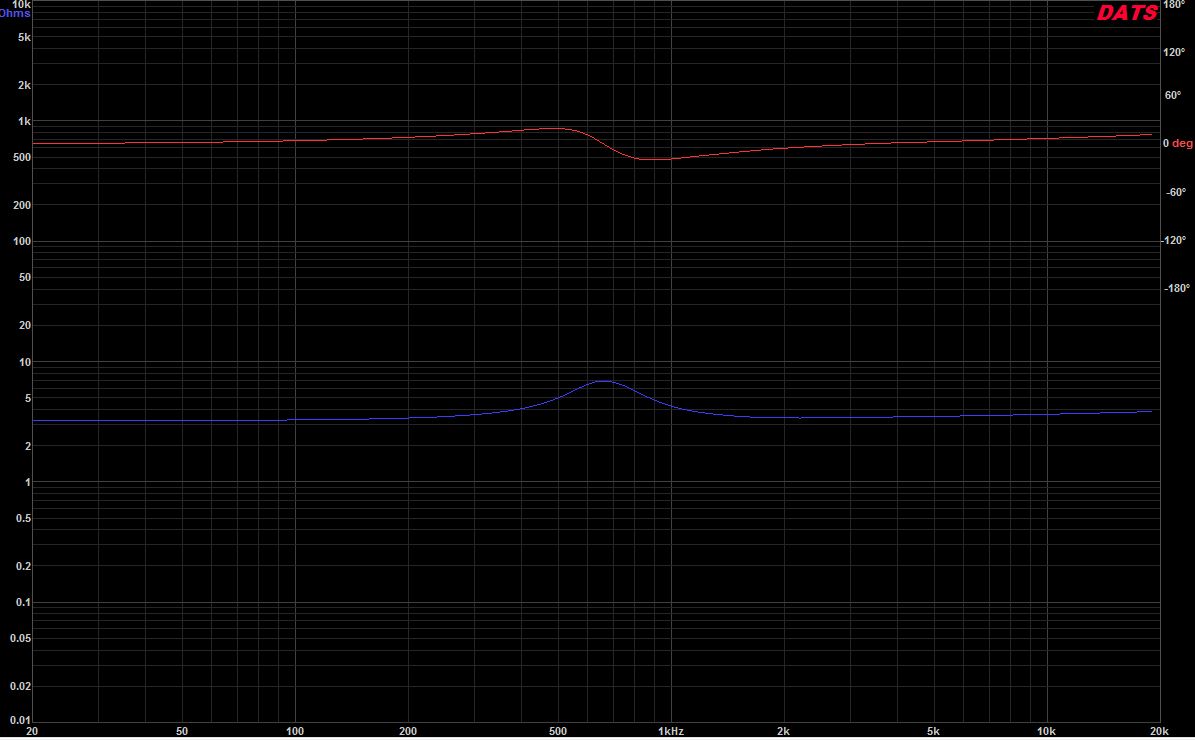

TMM,
the impedance curve (measured in box with the DATS V2) is more or less ok: the drivers live in their own separate box, and I don't have the situation that you describe.
Below all the 3 curves: any comment is very welcome

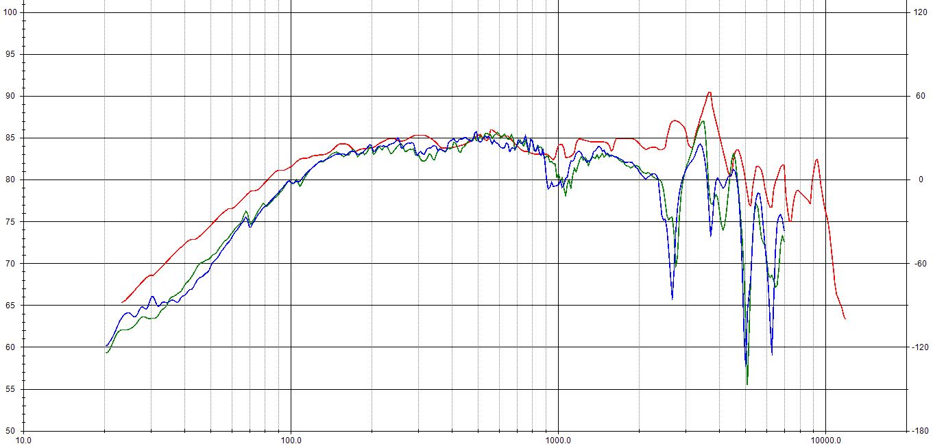

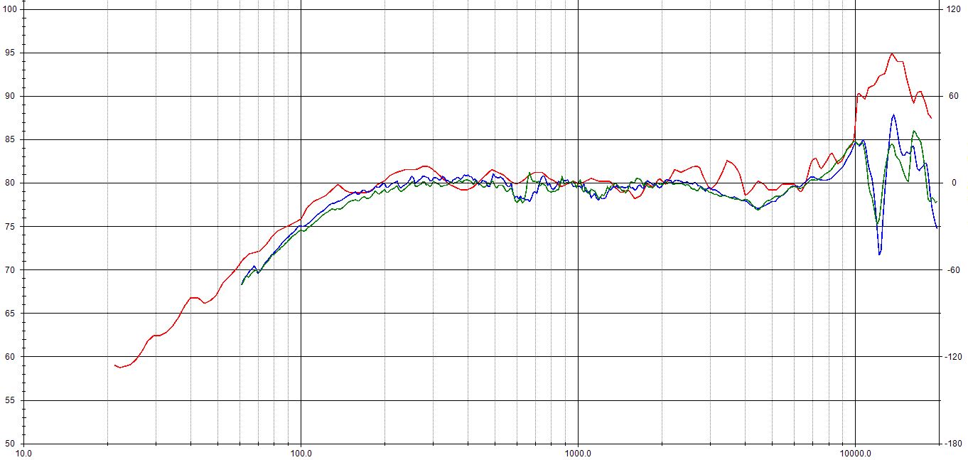

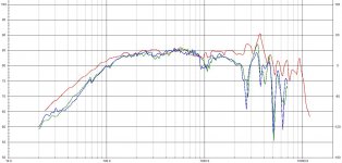

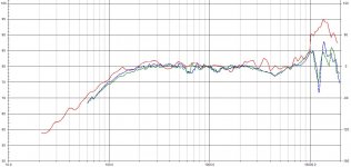

Dear experts,
Here my near field measurements, based on the Juhazi instructions
I've compared the in-box with the maker FR (in red), with SPL adjusted, smoothed 1/48
Mids
Woofers
I see some difference in the low frequency for the woofers: is that normal?
What do you think?
thanks for the help!

If you're comparing near field measurements to a manufacturer's 2pi far field measurements, there will be differences. At low frequencies the differences are likely due to different back volume size. At high frequencies the differences are due to the different location of the microphone, diffraction, etc. Your measurements look reasonably close to the manufacturer's, so I'd just trust your measurements.
