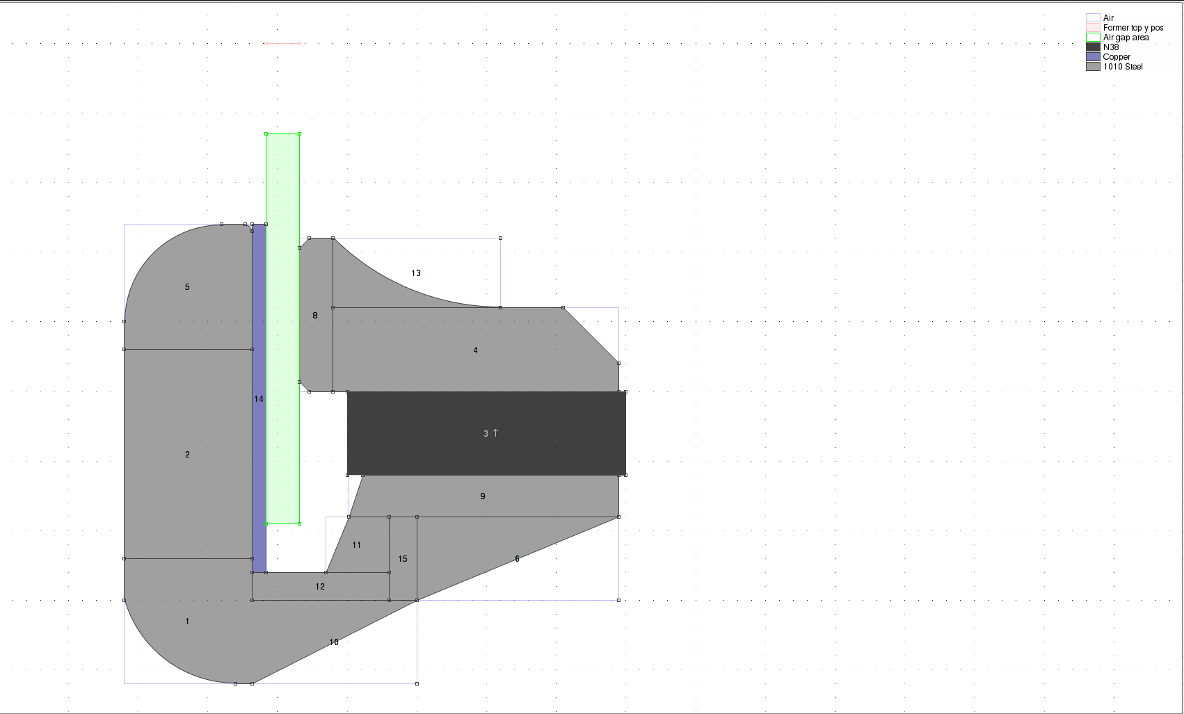

Are you separating the L and the B in the BL concept correctly?
L is linear usually unless you have a variable wound voice coil.

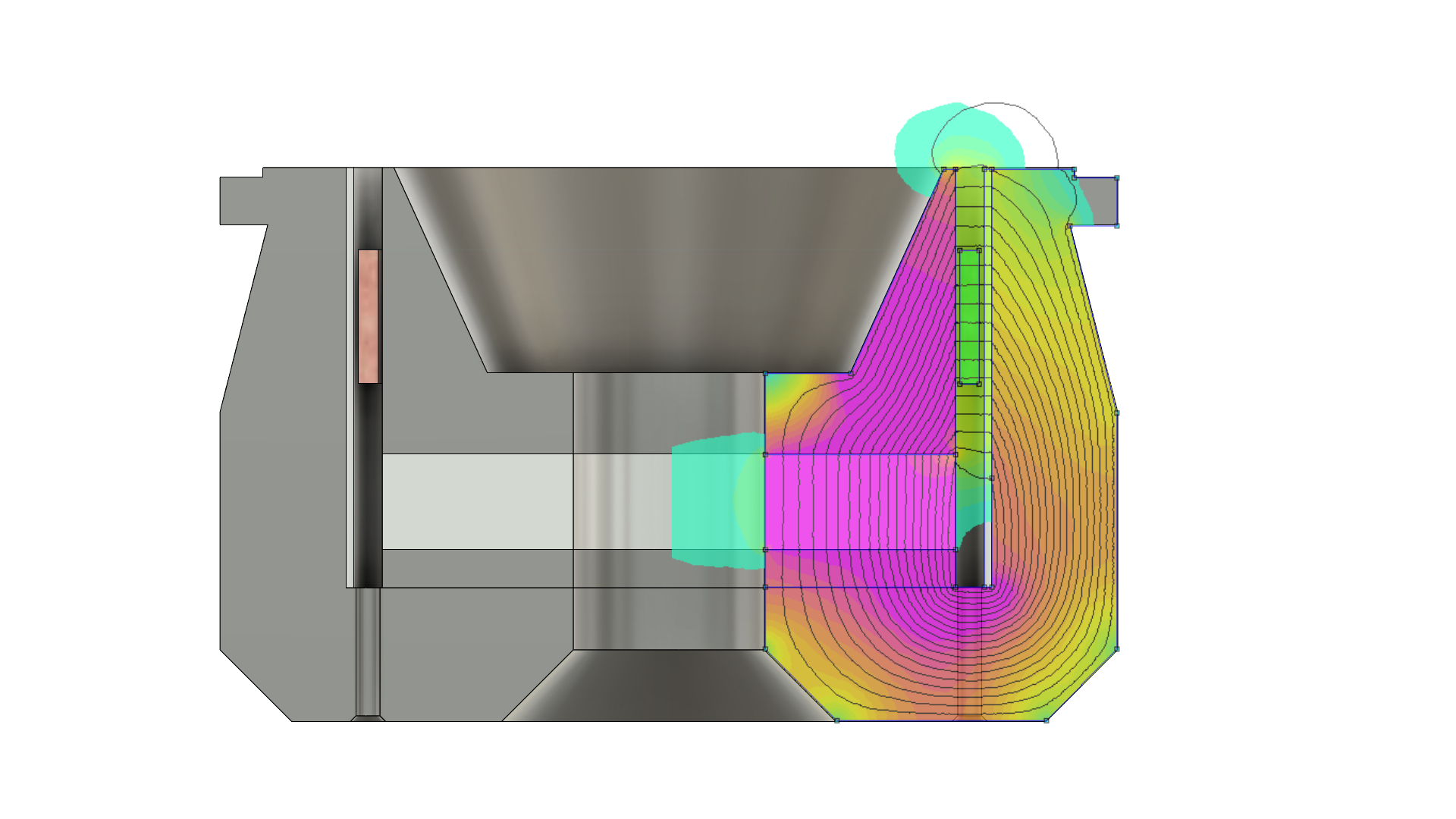

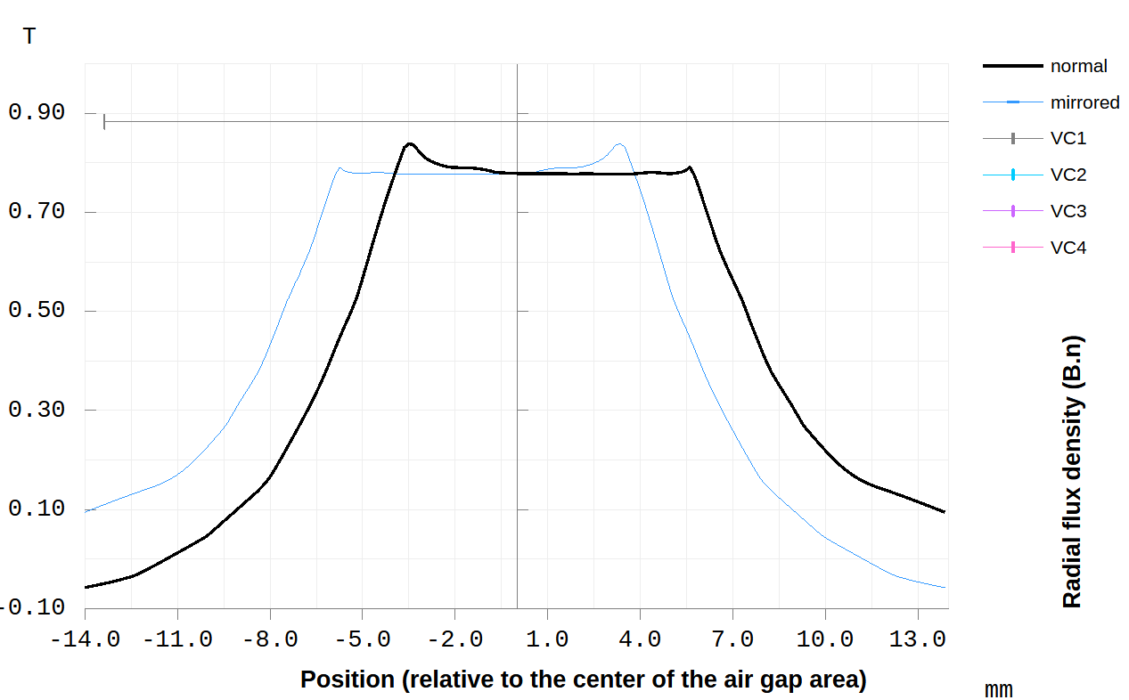

The B field is the part where you have non linearity. I'm trying to think of how you could back out the B field measurement from the other measurable parameters. It may be possible. But it will need to be a very low voltage levels so it is not exactly useful.
An example. This is not a fully finished design. It is a very long excursion underhung motor. Green is the area that the coil can move within.

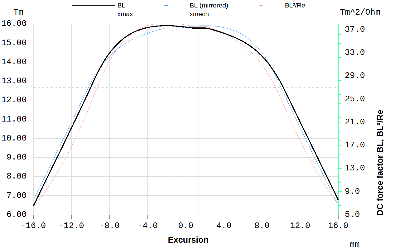

The two other pictures are illustrating the B field and the subsequent BL as simulated.
So can you simulate a B field? Yes!
Hello there, I happen to have a lot of experience developing and testing some underhung motor platforms. I use an in house klippel ka3 to validate and there are some things I'd like to share about your simulations there that I have learned from my journey along the same path.
In all of the simulated BL curves of my underhung designs, there seems to be a rearward bias in FEMM results that is actually not there in real life. I tried tapering the pole around .015" smaller in diameter from the top of the gap to the bottom, and this will let FEMM spit out a flat BL curve, but after testing a prototype this way that is not the case. If you flip the polarity of your magnet 180 in FEMM and change the current of your VC circuit to -1, it will bias the BL towards the outward stroke.
Also, the chamfers on the corner of the top plate won't alleviate the "cat ear" B plot; that does not translate to real world results. Undercutting the pole for the gap height helps here, and with a flared taper at the top of the pole ID instead of just a radius you do not need an extended pole. Flux is less likely to stray/modulate from steel the more saturated it is, so saturating your pole fully at the gap is a good way to control the fringe field.
Here is a cutaway of one of my early designs with the FEMM result overlaid transparent on one half to show the saturation at the pole that I am talking about. In this exact design, FEMM showed a rear bias on the BL curve but the klippel measured it perfectly flat and symmetric.

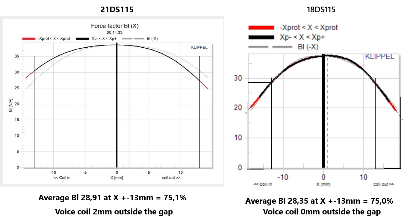

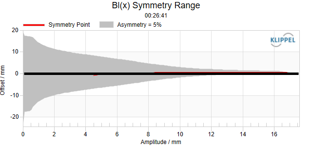

So most people don't understand what the red part of the graph is on a BL curve and I think you are misinterpreting it since your X axis marker is pointed at the start of the red section in the first graph.I have requested original B&C Speakers data on 21DS115, but here is the issue depicted:
As can be seen, the 18DS115 with 4mm longer voice coil sees same or steeper fall of the Bl than the 21DS115. Given the "same motor", this does not add up.

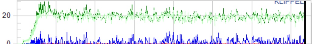

When you set up a klippel LSI test, you have protections that you set in place. Basically with these protections, you are telling the klippel "I do not want you to move the driver past this protection amount". The protections offered are: voice coil temp delta above ambient, BL, CMS, and power. You can set these to whatever you want. Say I have a driver that could bottom out easily, I will set the BL protection to 80% so the klippel will not move the driver past 80% BL. Whichever protection you set that the driver meets first, the machine does not move the driver past it. So, say I set CMS protection at 50% and BL protection at 80%, once the BL reaches 80% it will not move the driver further even if the CMS has not resolved to 50%.
The legend on the BL graph denotes "Xprot" in red; this means that the red part of the graph is just how much the driver moves past the protection limit that you set at the beginning of the test. Obviously the machine is not 100% precise at stopping the driver from moving past the protection you set, but that's why you see the red part of the graph.
What has likely happened, is the BL protection on the LSI run for the 18 was set more aggressive down to say 50% BL, while the 21 could have been set more conservative at 70%. For those who don't know how to read klippel graphs, this can be confusing, but I'm here to clear this up for you. When you get a full klippel report generated, there is a section called "table states" where you can view exactly what the protection amounts for each variable are set at and the amount that the test actually resolved to.
As for the slight asymmetry on the 21 curve, that just looks like the coil on that particular driver that was tested wasn't centered exactly and was built just a bit higher than the gap center. If you take the graph and scoot it to the right a little, it will bring back its symmetry. This amount is denoted in the "bl asymmetry" field of the "nonlinear parameters" section of a generated klippel report.
Heya. Thank you for education, sincerely.
I did not make any assumptions on this and the red line crossing is "accidental". It was precisely picked for the reason that on the 18DS115 driver, at 13mm of excursion, the far end of the voicecoil exactly meets the pole piece thickness, while the 21DS115 has its coil out by 2mm already. There is no side intentions and in between the lines again, these assumptions are moot. I am glad you poke to it so we actually diagnose and eliminate mistakes, but "no".
This does not add up very well:
The Xprot for that driver was set to 18.1mm by the LSI protocol. Whatever more possible protections might be activated at 16mm, it allowed the driver to fly well past 20mm one way during the whole long test, and the driver touched above 25mm few times too. If you know that driver, you would know it really does not want to go that far at all, and if we interpolate Bl and Kms for these excursions, we would understand that this poor thing was getting 6,5-8kW peaks.
So I have very hard time believing it was very restricted, and this is the reasoning why Bl falloff at x 13mm shows same or higher than it does on 21DS115.
On the other hand, the depicted 21DS115, arguably, got some kind of restriction or protection set at 13mm, 3mm sooner than the 18DS115 had, therefore it should have beem showing lesser values if anything was to affect it, no larger. It goes exactly against the issue I am pointing out.

On the 18DS115 graph, the red lining starts at ~16mm.The legend on the BL graph denotes "Xprot" in red;

So, I've klippel tested a lot of drivers.. and that slight asymmetry on the first curve is still a very good result. The vast majority of drivers measure out a whole lot worse on symmetry.
Where are you seeing 13mm vs 16mm vs. 18.1mm protections? Klippel protections are not set by distance, they are set by a percentage.

Oh they are:Klippel protections are not set by distance, they are set by a percentage.
The limit values might be reasoned by percentages, but the actual action of protection system measured by laser distance probe is set as distance. It has been even described somewhere, unfortunately I do not remember where. Maybe one of the Benett Prescott´s vids. Of course this system is slow, it can probably only apply some kind of amp limiting or momentary gain control, that´s why the 18DS115 was allowed to fly past 20mm:
Sorry for not including full view, the file was sent to me personally, so I cannot just openly share it...
But you can see that on the LSI graph provided before, the red lining starts at about 16mm for 18DS115, while simultaneously Xprot is set to 18.1mm.
Possibly different kind of protection than Xprot is in action, but it still does not stop the driver from moving as it should in that x.

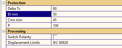

You specify the percentage of protection and the machine tries to figure out what that is in millimeters once it leaves enlargement mode and enters nonlinear mode. This changes with every result on the test. If you had the database file, you can scrub through the timeline and see this. This protection depends solely on what the test has resolved to at that point in time. Before the test resolves down to your protection percentages, and when it is in enlargement mode, it can be all over the place.
With all due respect, I have tested drivers weekly and sometimes daily for over a year, so I know how the machine works and how it gets its data. You are not going to tell me anything I don't already know about it. There is a lot more data to interpret in the database file than you can see on a generated report and trying to draw lines from the graphs it generates for the pdf file.
In the report you have, under the Table States section, what does it say in the BLmin% and Cmin% fields? It will have an entry that is formatted like: 70 (70) %. The first number is what the test has resolved to (unrelated to protection), and the number in parentheses is the protection percentage that you set at the beginning of the test.

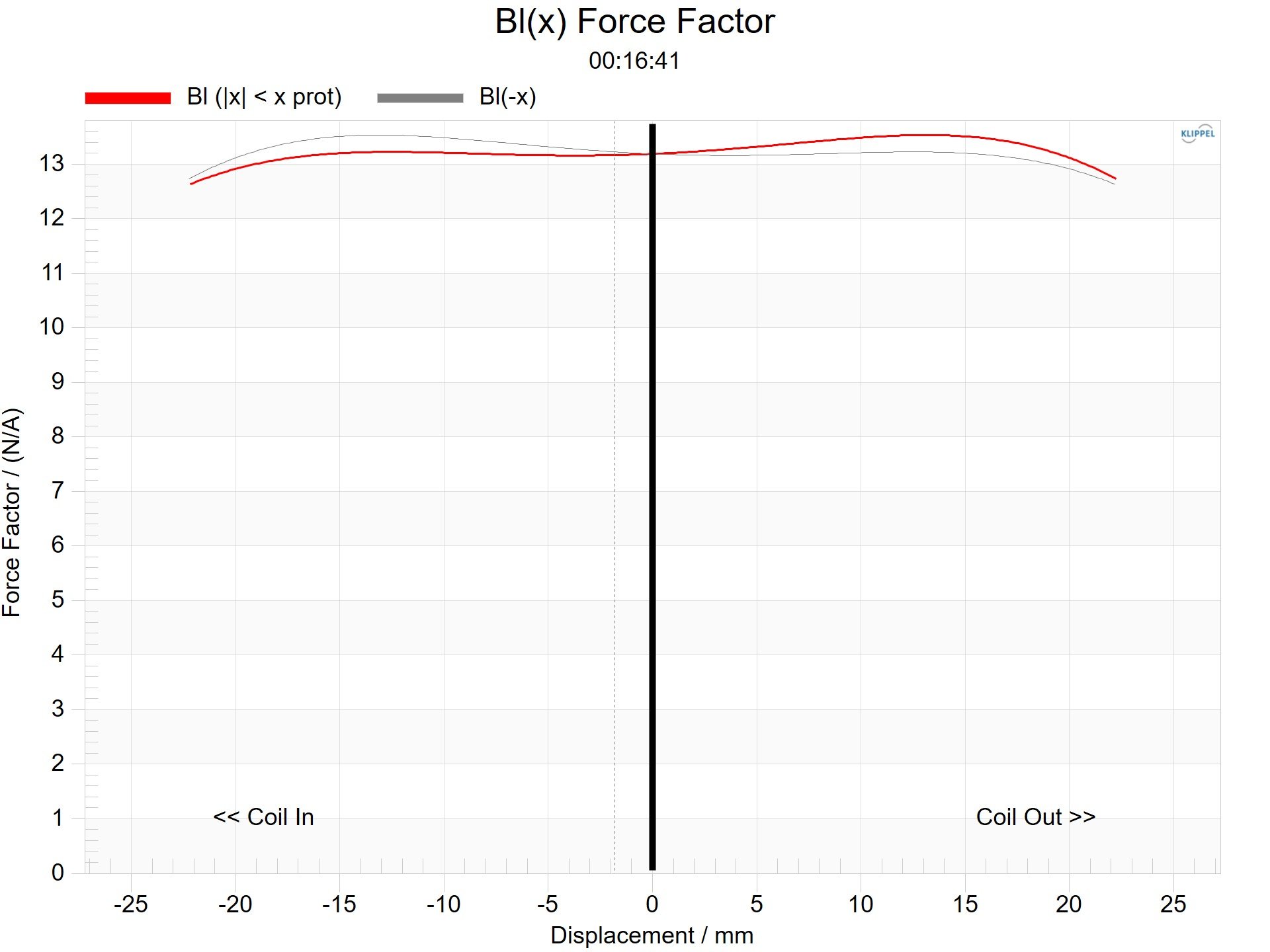

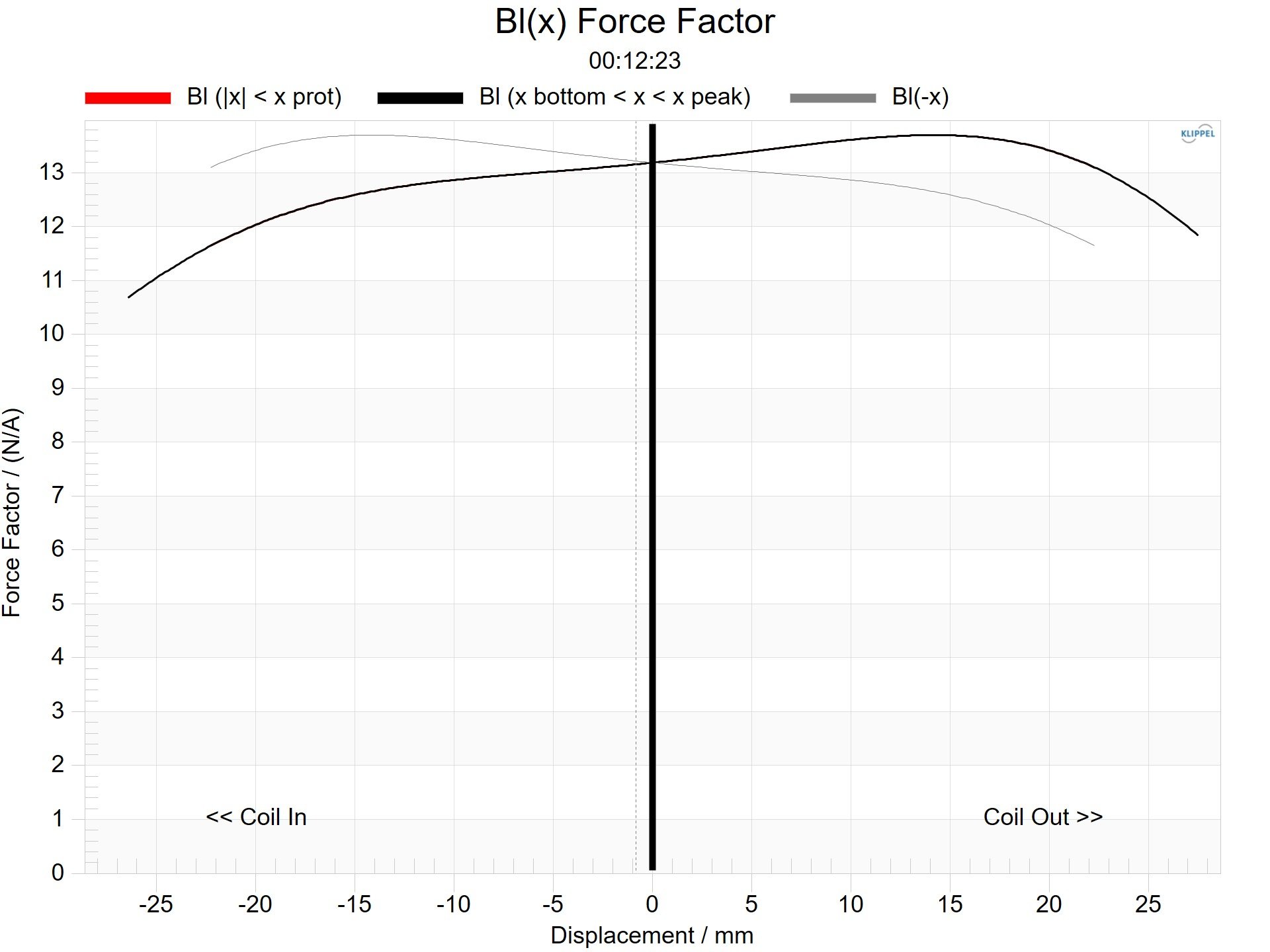

This is two different BL results from the same test on a driver I tested two days ago; one is good data and one is bad data.. what data in the database do we look at and how do we tell which result is good or not? 🧐🧐🧐🧐
