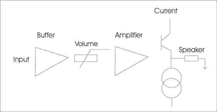

Here is the idea I’m working at:
A single end power amplifier with a volume control on the input. I use the two OP for the input stage, one as a buffer and the second as VAS.
Then I would like to take the VAS output directly to the Current stage.
This have an ordinary emitter follower and working against a current source.
I’m lifting the signal so the whole one is on the positive side of the ground. Then I don’t need to have any cap on the output.
I’m going to use battery supply for +/- 12V.
Please give me some hints on this.
