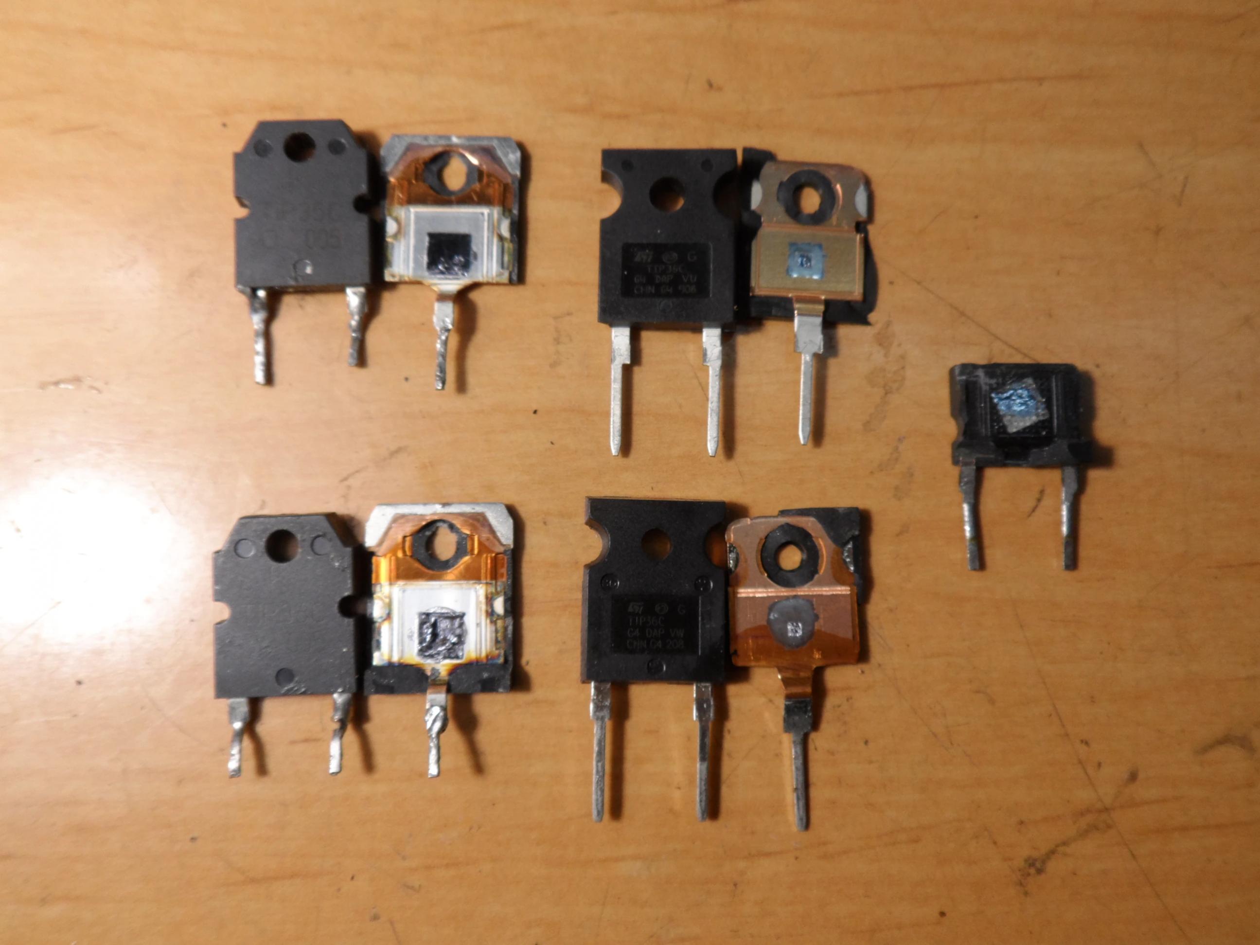

I bought some quantity TIP35C and TIP36C from Ali and local shop. And all transistors are fake! They are has nice look and laser marking "ST" on top face. I not use transistor tester, because she for low current components, and testing power transistors is not good idea.
I use power supply 12 volts 20 amps and check collector-emitter saturation voltage. In all tested transistors saturation voltage is about 2-6 (!!!) volts, when base current is 2A. It is not same parameter of datasheet spec.
I broke transistors, and founded inside small crystal, size is 2x2mm.
It's too small for 25A collector current, see attached file!
Now that is one tiny little die. In the same package, and same markings as post #1, which had a 100+ watt die in it. Probably the same fakers, but they obviously don’t always use the same stuff.

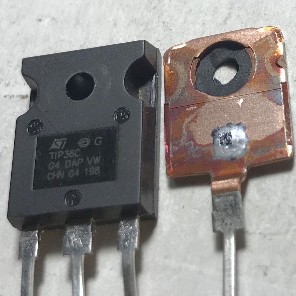

Someone else bought the same fake TIP35C and TIP36C that I had bought and took the attached picture. (Fakes in the middle.) Tiny die. But extremely good looking lead frame and marking. The lead frame might look so good because genuine lead frames are now made in the country that made/sold these fakes.
It may be a “good looking” lead frame, but the outline on the back is supposed to look like post #5. Those notches are probably only there because it’s an ST-proprietary lead frame that not just anyone can go buy without someone asking questions. The plain-Jane one is wrong, as it is probably available to anyone.
