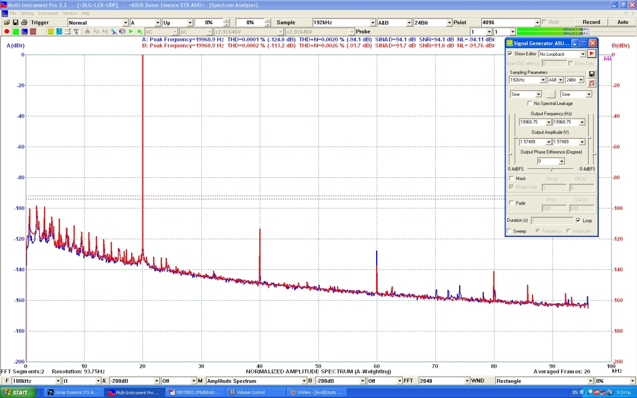

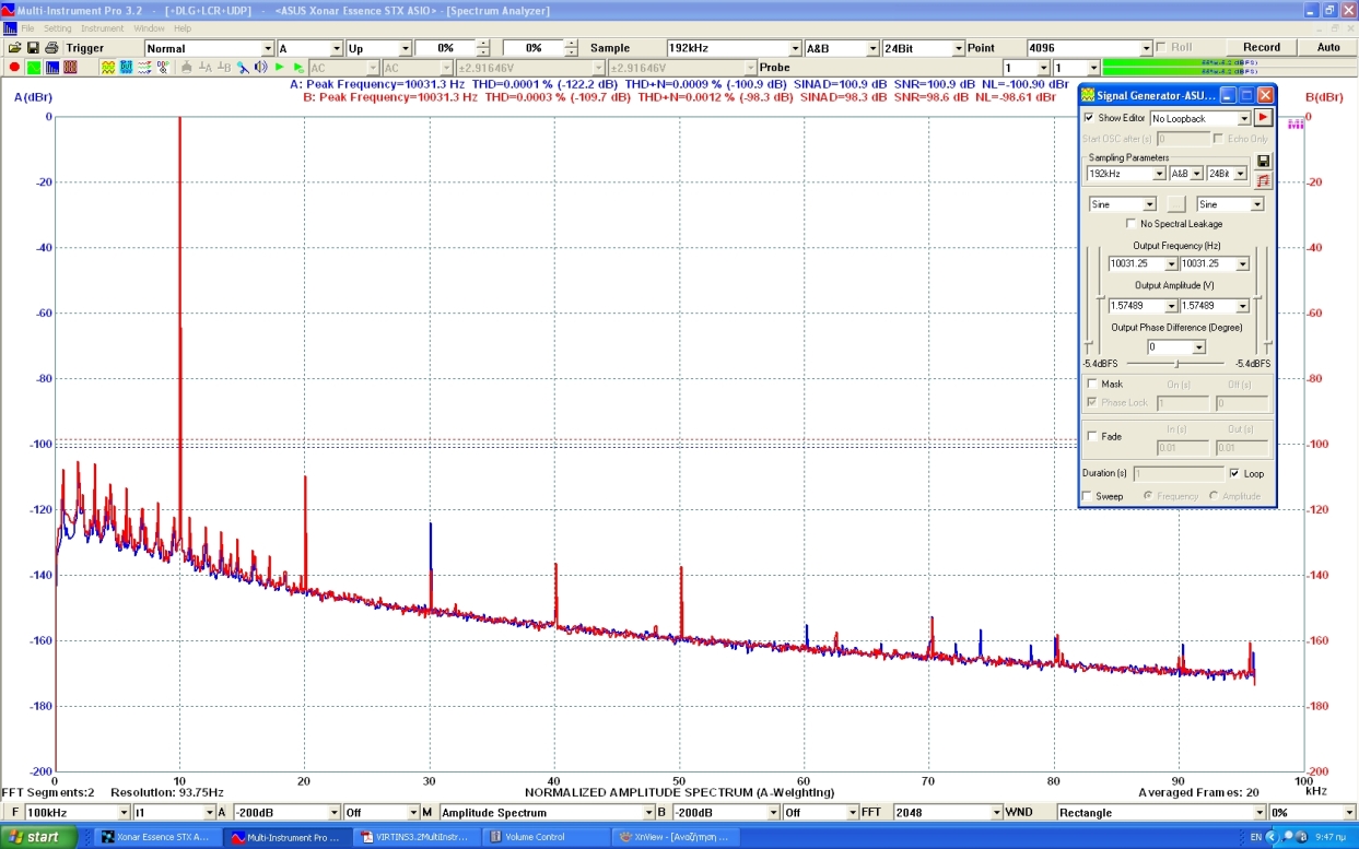

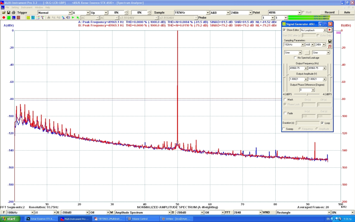

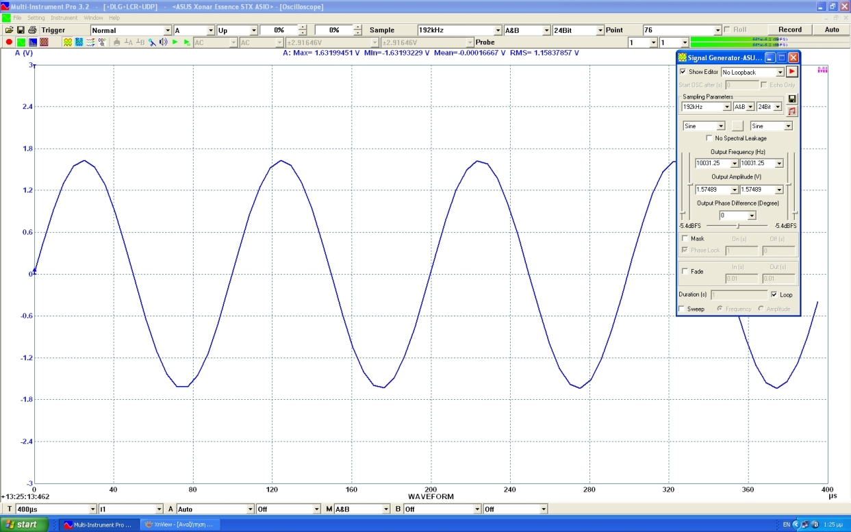

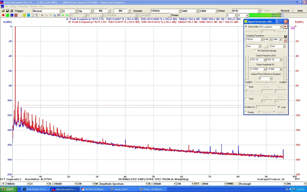

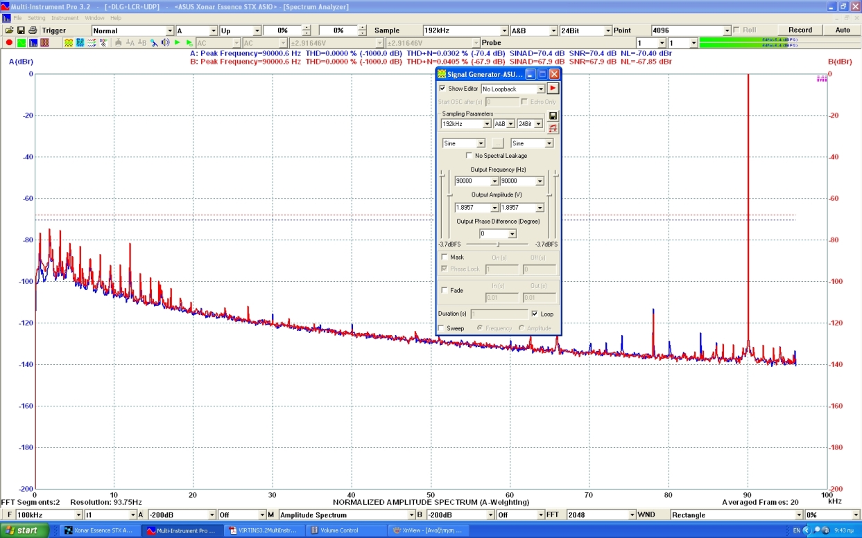

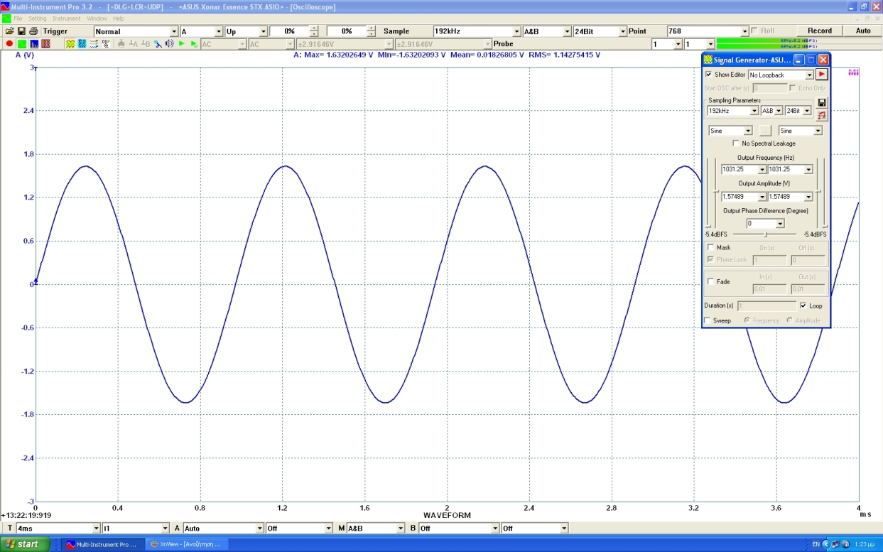

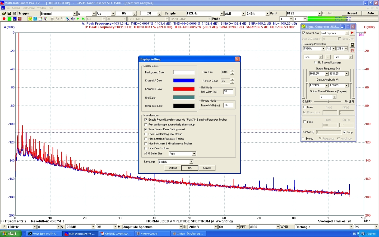

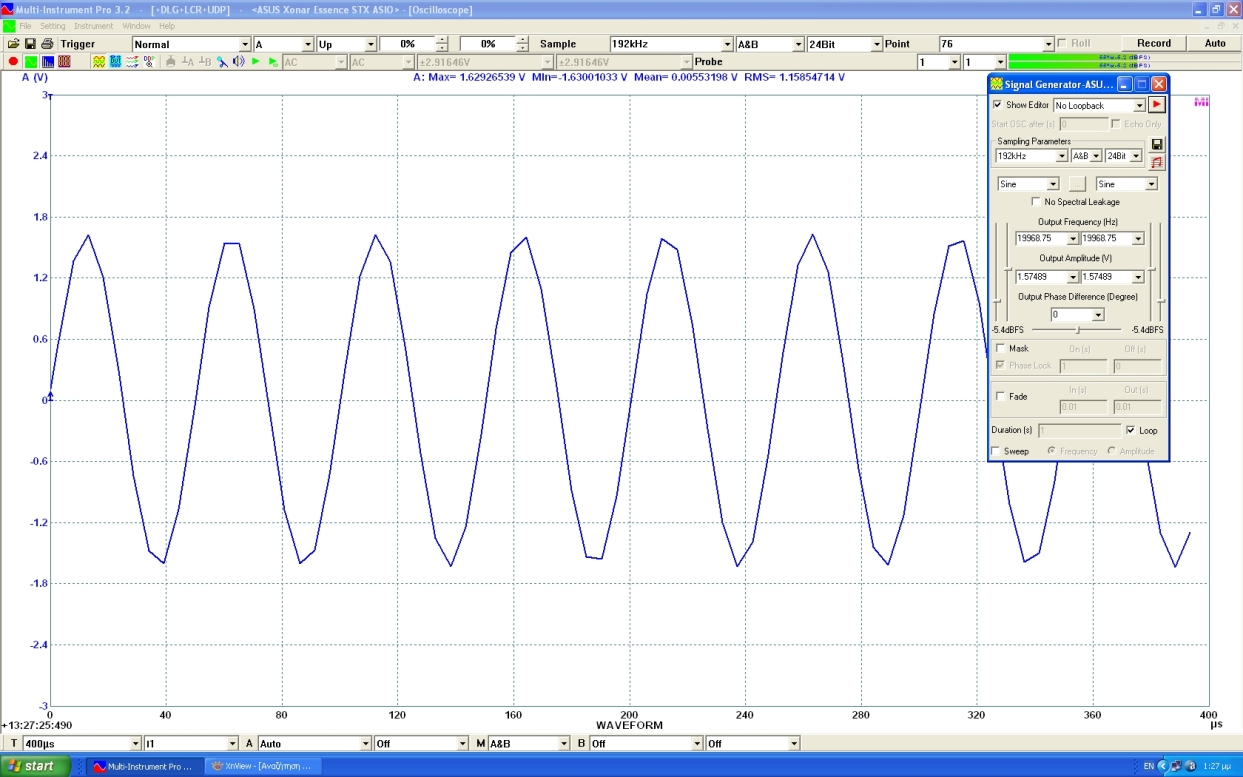

Jim, bellow are attached five FFT plots obtained from the ASUS Xonar Essence STX in external loopback mode at 192Ks/s - 24bit with different sinusoidal signals: 1K, 10K, 20K, 50K and 90K. Although are not from an EMU (i have sold my 0404 usb) i think you can get an idea for that you want. Because i did a such test for first time, i observed some new things: As the frequency of test signal is increased, the FFT analysis shows an increasing of the Noise Level. Very interesting... I think that i can perceive now your bothering.
Let's see the thing from a different optic angle. Attached are three curves obtained from the oscilloscope of Virtins MI with the same presets like in its FFT analyzer. The curves obtained from sinusoidal stimulus of 1KHz, 10KHz and 20KHz. We can observe that the 1KHz curve is almost perfect, instead the 10KHz is distorted and the 20KHz is inadmissible. Obviously this caused from the poor bandwidth of the ADC converter and not so much from the DAC of sound card. This proves that sound cards are not suitable for serious measurements of bandwidth.
fotios,
Very good work! You demonstrated the limits quite well. The poor 20 kHz sinewave is quite obvious. I have a laptop so I was planning on getting a USB external, but your results are much better than I was getting with the 0202. I will have to consider an "upgrade" to a desktop and the ASUS card. Hopefully ikoflexer is able to get similar tests to run on the 0404. It uses different chips than the 0202 so the results will be interesting. The ability to run the FFT so easily with soundcard and computer is quite appealing and I am still interested in using this method. It is important to understand it's limits.

@Jim, sorry to hear about the card. Well, Jim, if I were in position to get another interface for measurements I'm very much leaning towards the TI pcm4222evm. It's only an ADC eval board but it seems to have good specs and no doubt it would beat my 0404. The lack of a DAC doesn't bother me
since I'm not very thrilled with the DAC based signal generator at higher frequencies. I'd probably build a measurement box with a pcm4222evm board and a low distortion oscillator in it. Could do my own low noise power supply for it, and the total price might be below $250.
What I like about the pcm4222evm board is that you don't depend on any software. The sampling rate is chosen via jumpers.
For just doing 1kHz fft tests a card like the ASUS Xonar Essence STX seems to have very good price/performance ratio.
