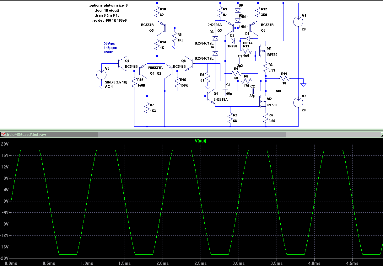

Very impressive work, Elvee, thank you! Can you do something with 50V rails?
Hugh
Hi AKSA,
I did all of the simulation at 20V, and most of the physical work at between 15 and 25V, approximately. Upgrading it to 50V shouldnt pose major difficulties, and I just made a quick test on the sim: I changed the 20V supplies to 50V ones, and nothing else (except the input level). As you can see, the result is rather encouraging: the linearity has degraded by just 2ppm, mainly second harmonic, probably caused by the onset of an asymetrical clipping.
The quiescent current has increased to ~300mA, which is too much obviously, but these are rather minor issues.
Of course, in the real world, the transistors would have to be upgraded to more powerful, 120V or 150V types, but this normal.
I will think about it, anyway.
The comment of Panomaniac also sparked me into thinking of a full-N, high voltage (+/-700V) version:
Originally Posted by panomaniac
As good as it is on difficult loads, wonder how it would do driving electrostatic panels? Should do well.
It should do well, but in this version, a transformer would still be necessary.
But it would also be possible to "unfold" the cascode, in order to use only high voltage/N devices in the driver and output stages. This should make a direct drive possible.
I think I'll be able to come up with something viable.

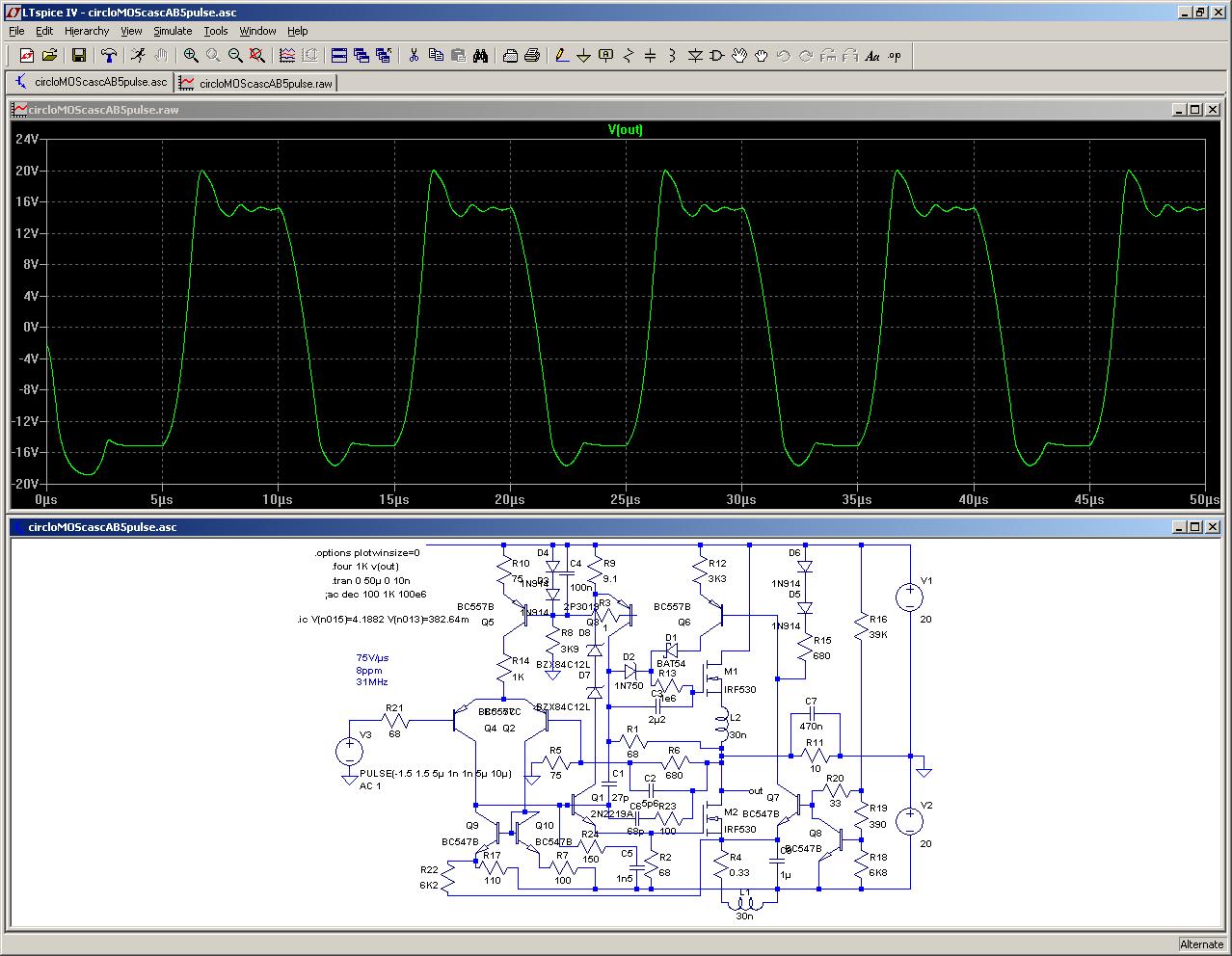

Hi Elvee
When you increase loop gain to reduce distortion, doesn't that hurt the stability margin? I remember thinking, when I saw your first circuit that it's stability into obscene loads was probably largely due to few gain stages and relatively low loop gain.
I would have thought that for heating screws, injecting noise into power lines etc, bullet-proof stability would be more important than ultra-low distortion? Or has this circuit gotten a wee bit side-tracked from strictly work-related uses?;)
On an unrelated note: what's with the 10k resistor connected to the emitter of Q9? Looks like it gives some semi-local positive feedback, but only when M2 is conducting.:confused:
Cheers - Godfrey
Hi Godfrey,
The higher gain version may not be as bullet-proof as the simple one, but it still does a decent job.
Here is an example, only slightly different from the AB6: it uses a bjt as a driver, and is shown driving a 470nF capacitor directly.
The schematic is a bit fuzzy, because parasitics are included.
As you can see, it it is relatively well-behaved (OK, not perfect, but it is a 100KHz square wave).
This test has been made for real, and the result is quite similar, but the amplifier blows after seconds, due to excessive dissipation in the MOS, not instability.
This version uses a nested compensation which improves stability.
And BTW, heating screws was not included in the original requirements: the idea came along the way.
The 10K resistor compensates for the slight asymetry caused by the current-sensing resistor R4, and it lifts the gain when M2 is conducting, restoring the symetry.
It also compensates for the unbalanced zero-signal circlo driver current, made necessary by the threshold shifting circuitry.

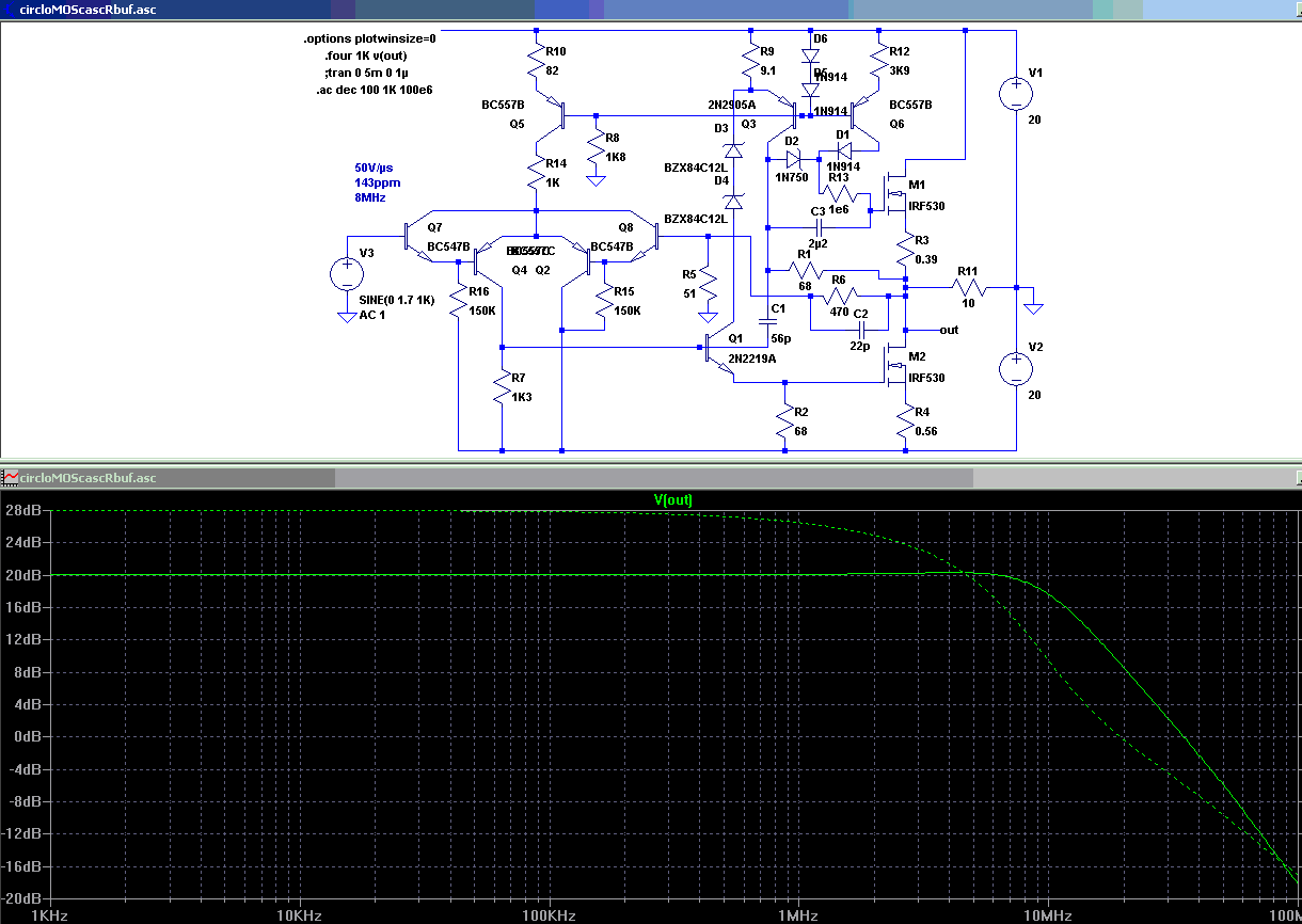

Here are some recommendations for those wanting to build an audio version of this amplifier.
As I said at the beginning of this thread, it was not initially intended for audio applications.
The main points requiring adaptation are:
-Input impedance (too low)/input current (too high)
-Frequency response extends to DC
-Bandwidth is too large
I will provide some hints at solving these problems. Remember however that unexpected problems might always appear if you carry out modifications. The original circuit works as advertised, but I cannot give a similar guarantee on circuits that have not been tried and tested.
I recommend you begin with the original design, and make incremental changes, to get the feel on how the circuit behaves. A prototype can be built for peanuts, as can be seen from the picture.
Or you start from scratch, and you redesign a purely audio amplifier based on the same basic principles.
The input impedance issue could be solved by using composites in the input LTP: see CircloBuf.
This has not been physically tested, just simulated.
Cutting the DC response can be achieved by the traditional solution of placing a (large) capacitor in series with R5. Alternatively, a coupling capacitor could be used in the input, but some form of offset adjustment would probably be required (unless monolithic pairs are used for Q2/4 and Q7/8).
The bandwidth problem is more difficult: I have just tried to make a simulation including gate stoppers, but this has the effect of degrading the stability margin to dangerous levels.
A more serious redesign would be required to cleanly limit the bandwidth.
I therefore recommend to limit the frequency at the input, using a small RC low-pass.
This means the PCB layout around the output transistors has to be clean and short.
Anyway, this version is a bit more limited already, with only 8MHz of small-signal bandwidth.

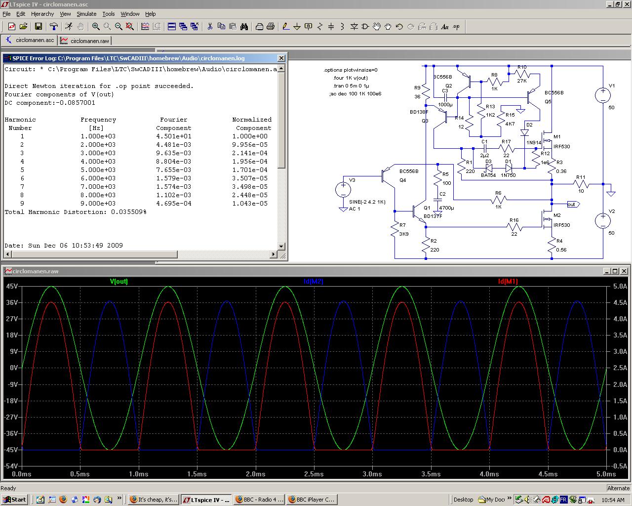

This is what i want to build. I dont know how to sim this amp, but i will try to learn LT-Spice in the near future..
Its only a rough first take on this amp. I have not included any stabilizing stuff at all.

Here is more or less what you want to achieve. It is simulated with symmetrical supplies to avoid DC conditions settling time issues, but it is single-supply-ready, you just have to include the input biasing divider.
Performances are not bad, considering the simplicity of the circuit.
Compensation might not be necessary, due the OL gain degeneration caused by R5. I didn't investigate this aspect.
I also include the LTspice file, it is a good starting point and a good opportunity if you want to initiate yourself to LTspice.
You will have to plug in the exact models of the devices you want to use, and make minor corrections to accommodate for different thresholds, etc. A good exercise. Good luck.
