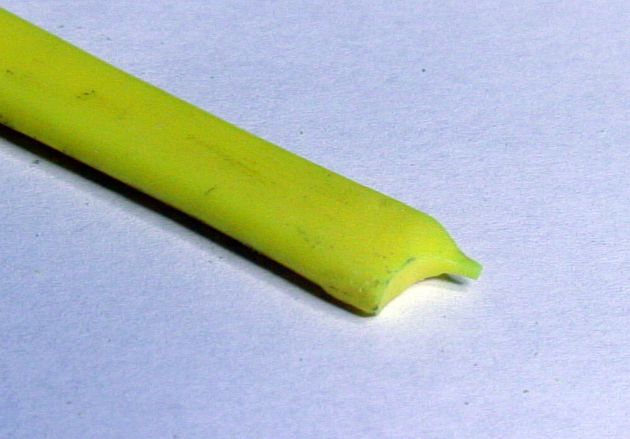

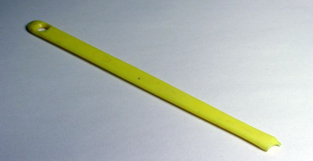

Thanks for the complement VT. A good clean up helps me see any mistakes. My process:
1. A toothbrush and denatured alcohol. Flux sticks to bristles, so avoid build-up.
2. Modified toothbrush handle as scraper. Fingernail when needed
3. Dow bathroom cleaner (Scrubbing Bubbles - certified for use in Nuke plants) and a soft back brush.
4. I use a wet-dry vac to remove cleaner as most fabrics and paper towels leave a lot of lint.
5. Repeat 3 and 4 as necessary.
6. Polish with a clean - dry shoe brush.
7. Convince yourself that your soldering skills are so good you actually didn't do steps 1-6. 😀
Component side clean up is pretty much limited to wet and dry Q-Tips.

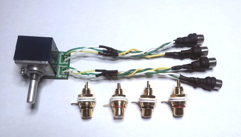

Be sure to follow Uriah's instructions on limiting the amount of heat on the LDRs. Use either good liquid or paste flux when you solder them. Put the solder on the tip of the iron and let it flow to the lead/pad. They will tolerate that but not much more. Cat-6 cable is great for connecting the pots. Post or PM me if I can be of any help.

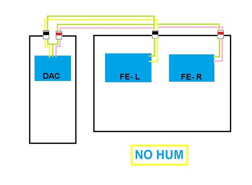

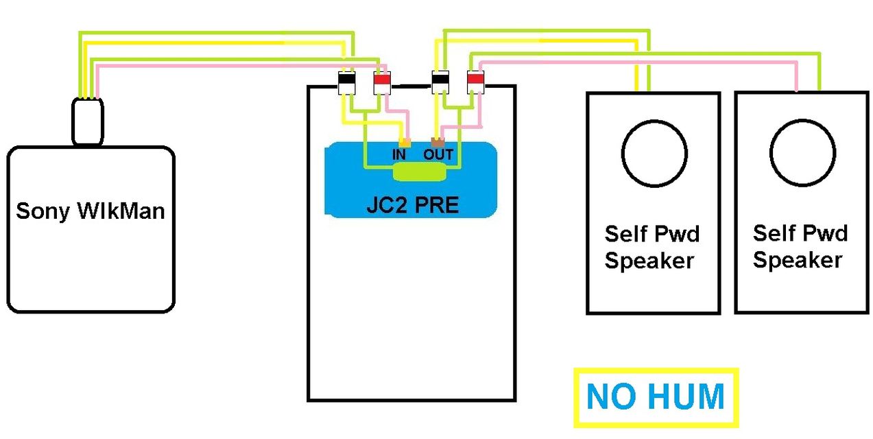

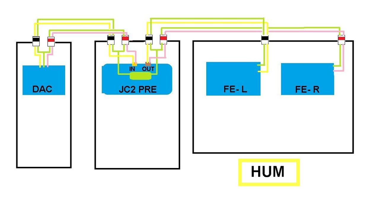

Before I could get to expanding this thread to include interconnects and speaker cabling, I ran up against a different problem. Pleas take a look at the diagrams and tell me what I am not seeing.

Bob,
Could you add the power supply paths to your diagrams, both hot and neutral (ground if applicable)? Also, use your ohm meter to show signal ground to neutral/ground continuity for each connection. Finally, do you have your dac, pre, and FE's all plugged into the same power plug strip or wall outlet? Sometimes separate power sources can have enough impedance between them to cause problems.
What you should be looking for is multiple paths to ground. I suspect the reason that the walkman as a source doesn't hum is because it is battery powered and isolated from ground. It is likely that you have a ground loop picking up hum between the dac and pre, but that is only a guess.
That said, I am not a expert in this. I won't be offended at all if someone with greater experience jumps in here.
