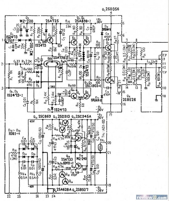

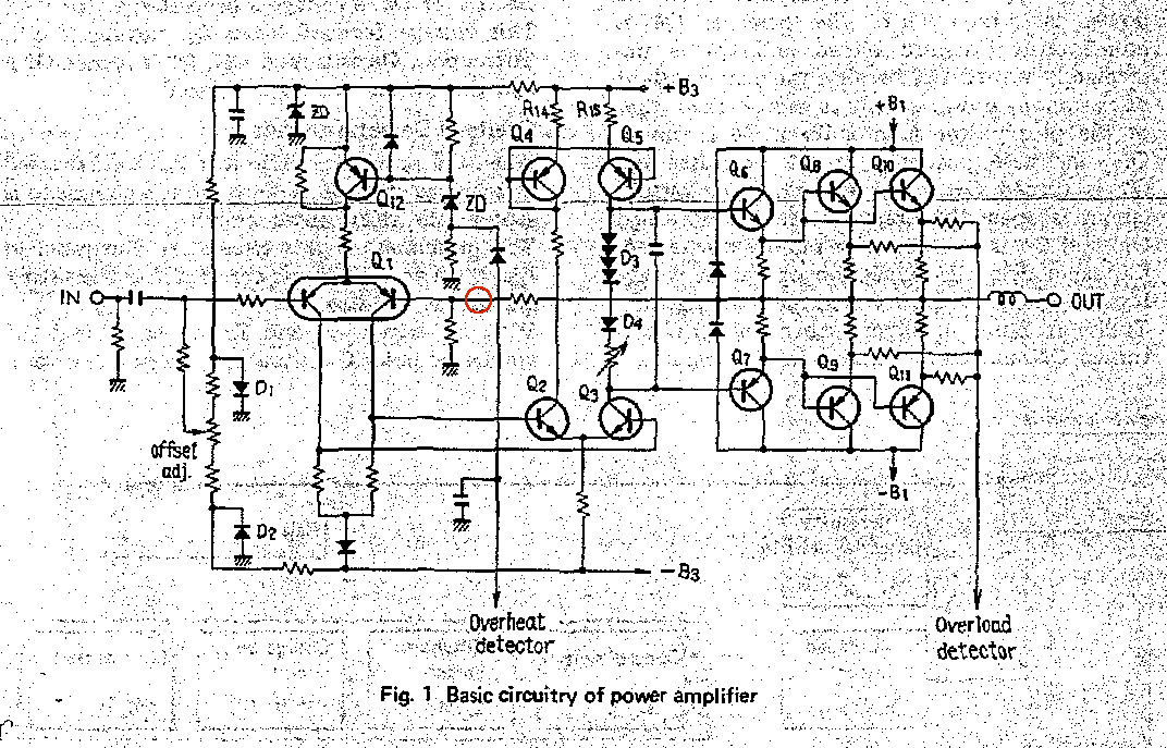

So I was helping a friend out with restoring his M22 and had to dig up a schematic. Lo and behold, it's the Hitachi topology with a BJT output stage.
That's the simplified schematic. Being a Japanese amp from the 70's, the full schematic sports another 32 transistors and a couple hundred associated passives.
Here's the front-end, just to give you an idea:
Good Star Grounding methodology. Input ground "3" is different from PSU bulk filter capacitor ground "23,24", which is different from PSU output ground "21", which is different from internal circuitry ground (schematic symbol ground).
Damned if I know why I/O terminal "1" at top left, is brought out to the outside world. It almost appears to be a logic gating signal that either runs the LTP at (36V/18K) = 2mA when pin I/O "1" is low, or else runs the LTP at (36V/168K) = 0.21mA when I/O "1" is high. Why is this good?
