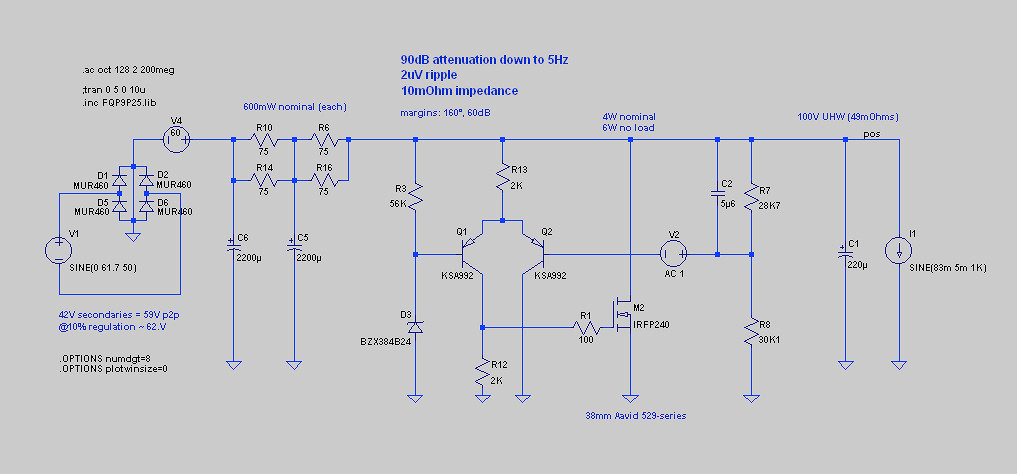

Oh man, I was proud of that regulator.
Let me defend it for one more round before I pull the plug.
I get a 100hZ ripple (from the rectifiers) of < 4uV, and a 20kHz ripple (from the varying load) of 57uV. Both those seem well beyond what is required, but perhaps SPICE isn't telling me the whole story?

Would I see this in SPICE? My model has the regulator feeding a current sink that draws 83mA +/- 4.5mA (at 20kHz).Jeff,
1) To correctly implement a shunt in this application requires a current source. Otherwise ripple can sometimes be an issue.
Yep, it's currently running at a no-load quiescent current of 118mA. The heatsink is spec'ed to allow the MOSFET to survive that, but the front-end's class A bias eats a lot of that which reduces the "normal" quiescent shunt current to 35mA.2) To get a shunt to work optimally you need to dissipate as much current through the shunt element as the circuit draws. In this case almost 100 mils. across 55 V.Otherwise the shunt will sound weird or drop out of regulation on peaks.
Yeah, I started out with just a Zener controlling the shunt, but I got goaded into doing something "better".3) The op-amp chosen has a high degree of influence on the sound. I also limits your ability to change it's characteristics (think black box). Same issue with the TL431.

Jeff,
Everything looks good but I beg your indulgence on one item, the regulator.
Jam
I generally go with at least double or even triple the quiescent current draw of the circuit through the shunt, depending on dissipation requirements.
Jeff,
Jam
A passive current source consisting of RCRCRC usually gives better filtering than a simple transistor based ccs. Either way it’s plenty good enough.
Maybe give an example of how this might occur.
Maybe the semiconductor ccs works better with AC mains fluctuation.
If you would consider discrete options we can work through something simple.
Absolutely. "Discrete" tickles my do-it-yourself fancy. (Well, at least until I get a fab line to do my own opamps....
I assume a 2-stage would be sufficient? In other words, a simple BJT LTP directly driving the shunting MOSFET?
Even a single gain stage driving the shunt maybe more than adequate.
At least start simple and only add gain stages where necessary.
We can look at something very basic to start with and see if that is adequate.
Anything better than 70 dB psrr and 10mOhms output impedance, should be adequate and achievable with a simple circuit.
Or we can consider other options.
For me all that matters is psrr, output impedance, and simplicity.
I like it as simple as possible.
My CRCRC opamp version was 130dB / 4mOhms. But I'm willing to sacrifice some performance for something that won't be squirrelly.

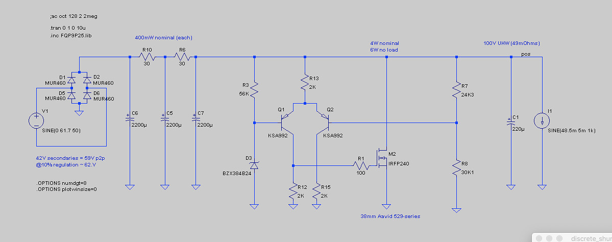

Here's my first shot across the bow. Performance isn't great yet (oddly it's better at high frequency than low).
Ignore the big TO-247. I didn't want to go digging up my IRF610 spice model....
[/IMG]
The audible difference between a power supply of 70dB reduction and 130dB reduction used to power a front end power amp circuit that will probably have a psrr better than 70dB will be inaudible.
The biggest Audible difference will be the differences in output impedance of the power supply, that's my opinion though.
