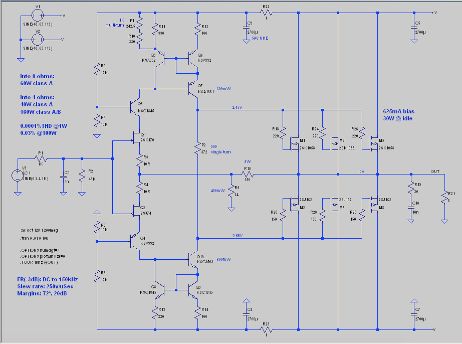

Anyway, back to JamJar. Next iteration of the current mirror version, with simplified bias and feedback:
attachment.php

Speaking of laterals not being terribly complementary, you'll notice that my gate stoppers are unbalanced to even out the phase response (due to unequal Ciss). But I note that many of the other circuits don't do this.
Unnecessary? Bad idea? Good idea?
