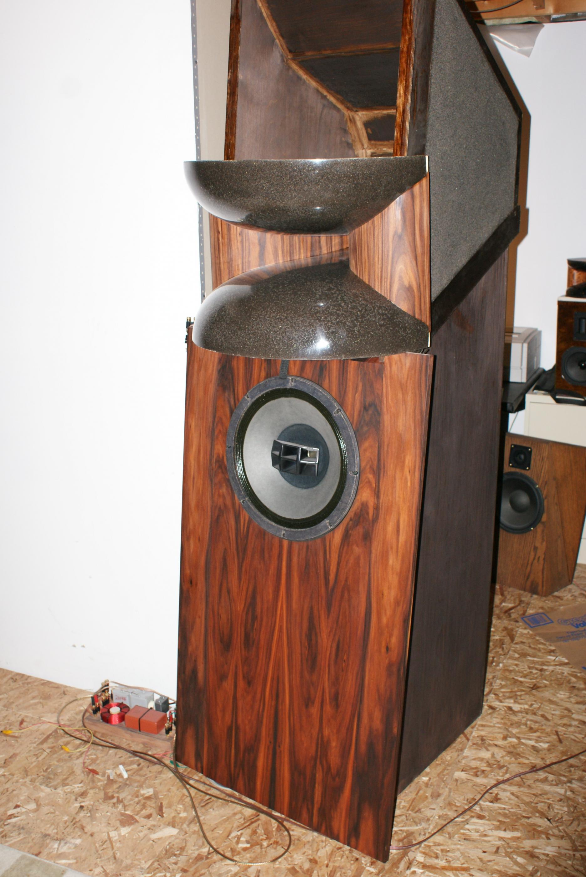

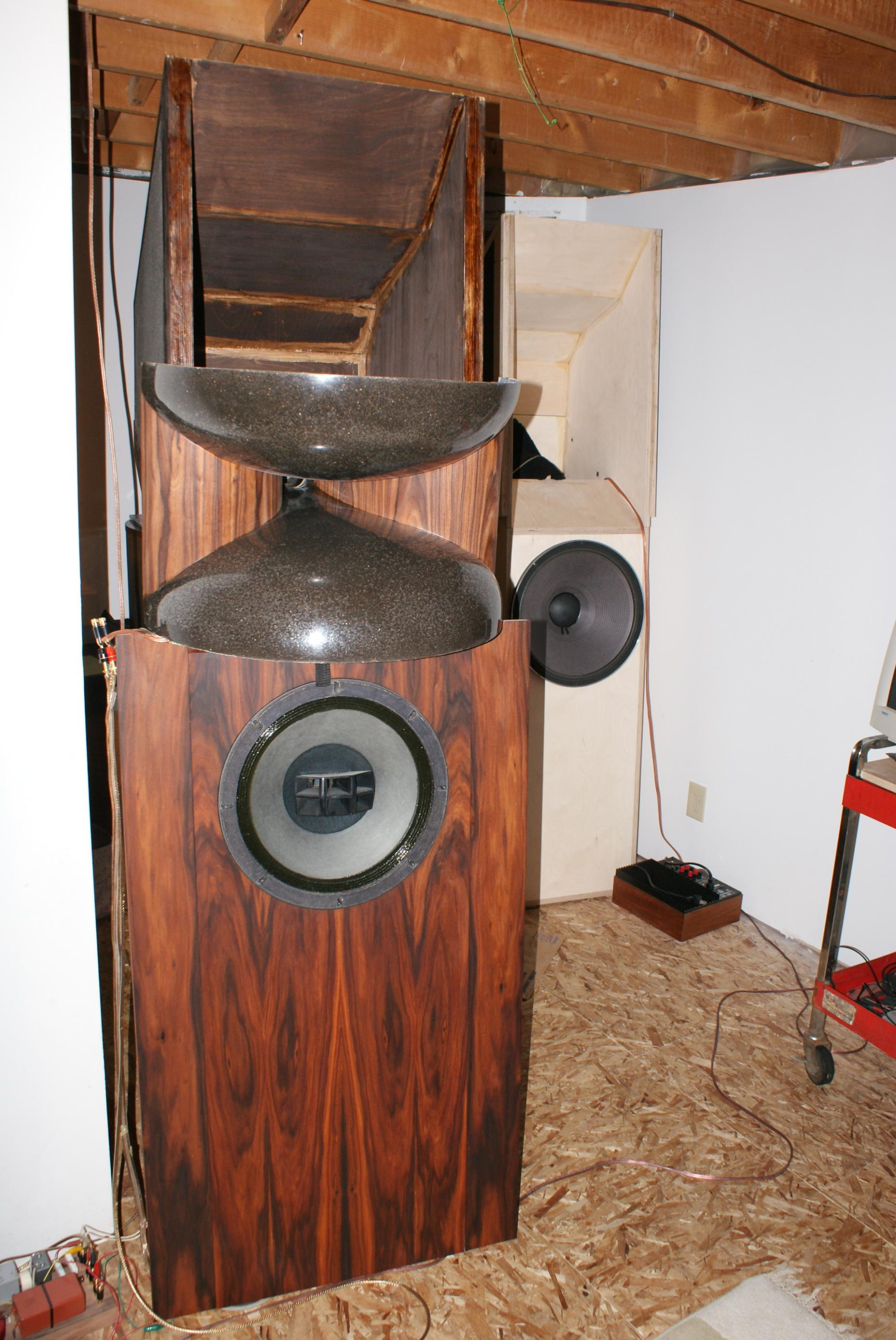

I did build one more and took more pictures. I dimentioned the panels with marker and took pictures of the parts with the dimentions. They are posted on photo bucket. Dieter said he would do a new cad drawing if needed,but I haven't asked. I have mine set up now crossover made and i traded one JBL 2245 out and put my pair of altec 604HPLN duplex 16inch for bass and tweeter and added 270hz mid horn for the two front main channels and one JBL is still used as sub,and one more to make. Picture, the 18 sub is set back on the right (not so visable) I put rosewood on the front and baffel extensions the back is stained birch, still ugly

Man, that's a beautiful looking speaker!
Thanks for kind words

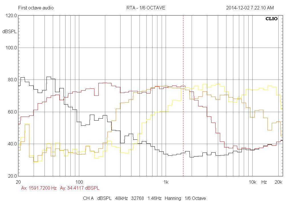

I love the sound of this,the sound is pure thearpy. i started the testing and working on the crossover. I did RTA of the seperate components through the crossover. here is the plot, white is the 2245 with sub plate amp turned to 40hz active cross, the others; red is the altec 604HPLN bass cone through 12db passive at 1000hz, (still going to 2000hz) the orange is the mid horn using JBL2440 overlaping the whole mid band, it is cut back 12db so not to overpower,yellow is tweeter component of the altec604
