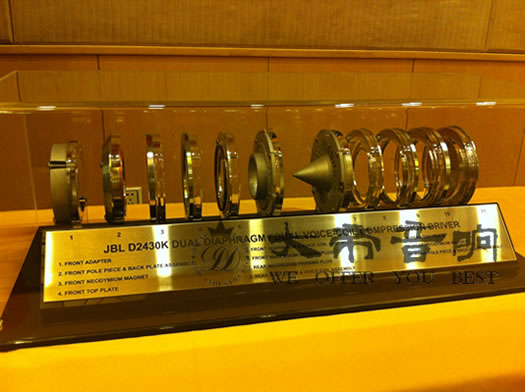

The compression driver in the M2 is very interesting. It's a dual ring radiator, very similar to the BMS compression drivers, except with two diaphragms instead of one. BMS sells some coaxial compression drivers, but the D2430K is different. In the D2430K the diaphragms face each other. (Not 100% sure if it's push-pull or push-push.)
![diaphragm.jpg](https://lh5.googleusercontent.com/-HGZaB6ncqzI/UqEfBZ_6eVI/AAAAAAAAHNc/vRuXxAmb22w/s800/diaphragm.jpg)
![magnet.jpg](https://lh3.googleusercontent.com/-SOd7ggcfxnc/UqEfBZXYDgI/AAAAAAAAHNY/jpI6KdhcY1E/s800/magnet.jpg)

Here's a quick look at the lineage of some of these drivers, based on some data from audioheritage and avsforum.
1) First came the BMS. This is a 4540ND, with a 1.5" voice coil. Output extends past 20khz and it's recommended to use a 1.9khz xover.
2) Then came the JBL 2407H, which looks suspiciously similar to the BMS 4540ND. Is it the same driver? See Ring Radiator Comparisons - Page 7
3) Next came the JBL 2408H. This one seems to be an evolution of the 2407H, but with a much different phase plug. Note how the area of the phase plug is much smaller than in the 2407H and the 4540ND.
Here's my 4540ND taken apart; see how the phase plug length is about the same, but the size is smaller?
4) After the 2408H came the 2408H-1. The phase plug in the 2408H-1 is *completely* different from the phase plug in the 2408H. (2408H is similar to the 2407H and 4540ND, but still a bit different.)
As far as I know, this is the first appearance of the new square phase plug documented in http://d27vj430nutdmd.cloudfront.net/19395/99548/99548-32.pdf. According to the literature, "The phasing plug’s slots have a unique pattern arranged diagonally with respect to the ring-diaphragm to provide averaging of the acoustic energy at varying positions to reduce chamber resonances."
Providing further evidence that the D2430K is an evolution of the JBL 2408H-1 which is an evolution of the JBL 2408H which is an evolution of the BMS 4540ND, the patent for the phase plug used in the 2408H is from the same designer that did the D2430K, Alexander Voishvillo, senior manager of transducer engineering at JBL.
