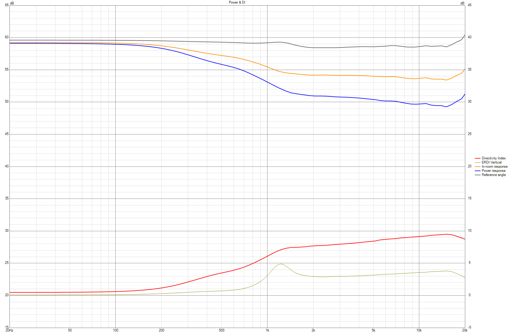

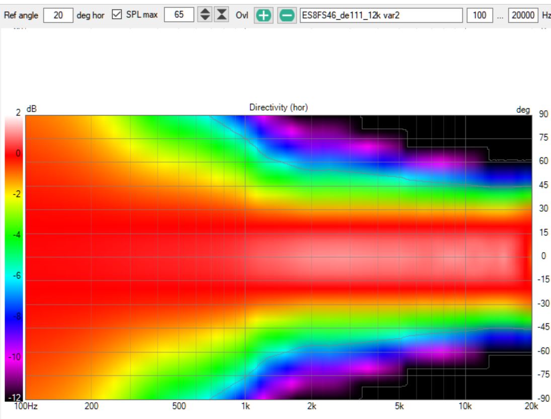

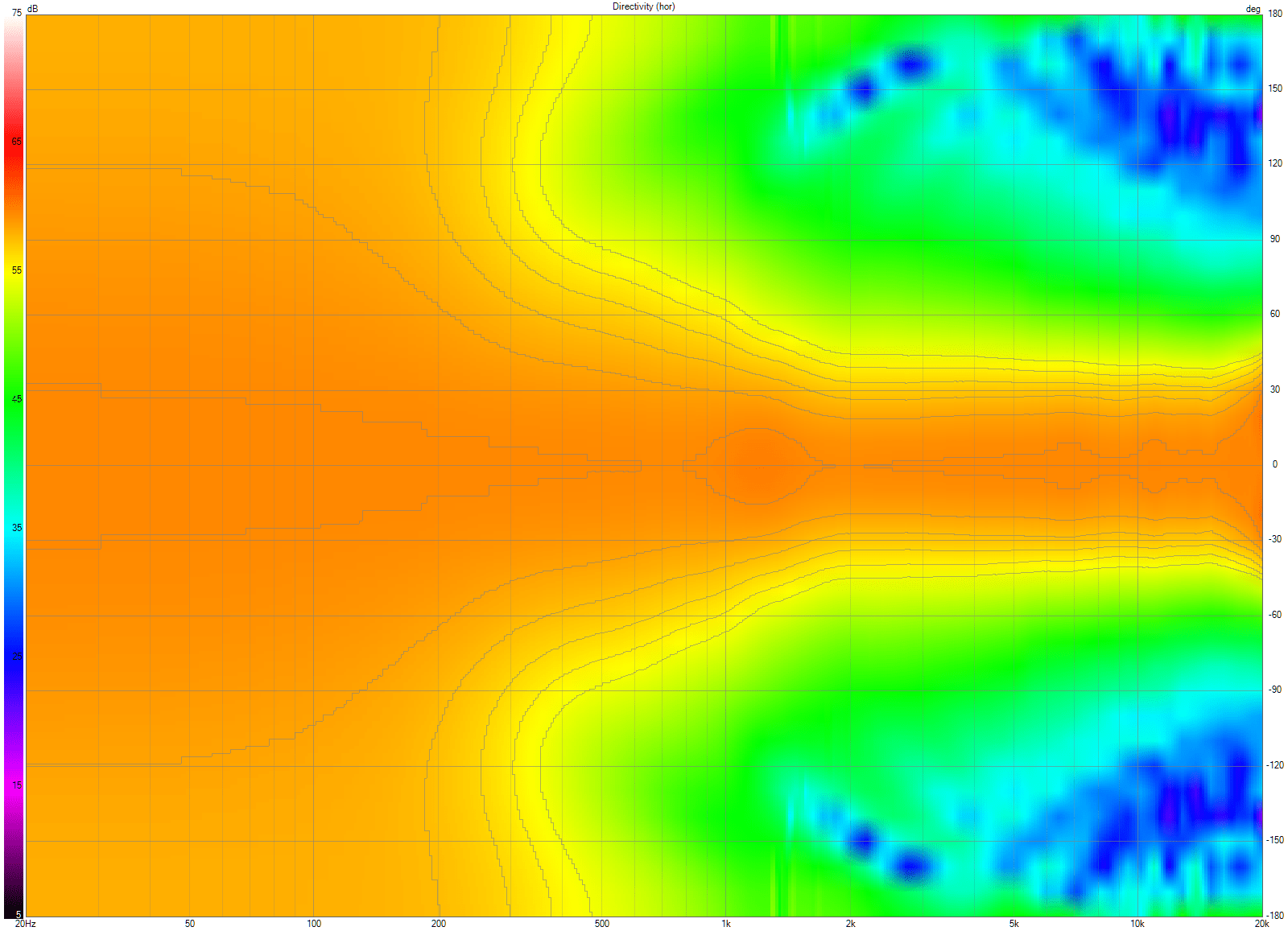

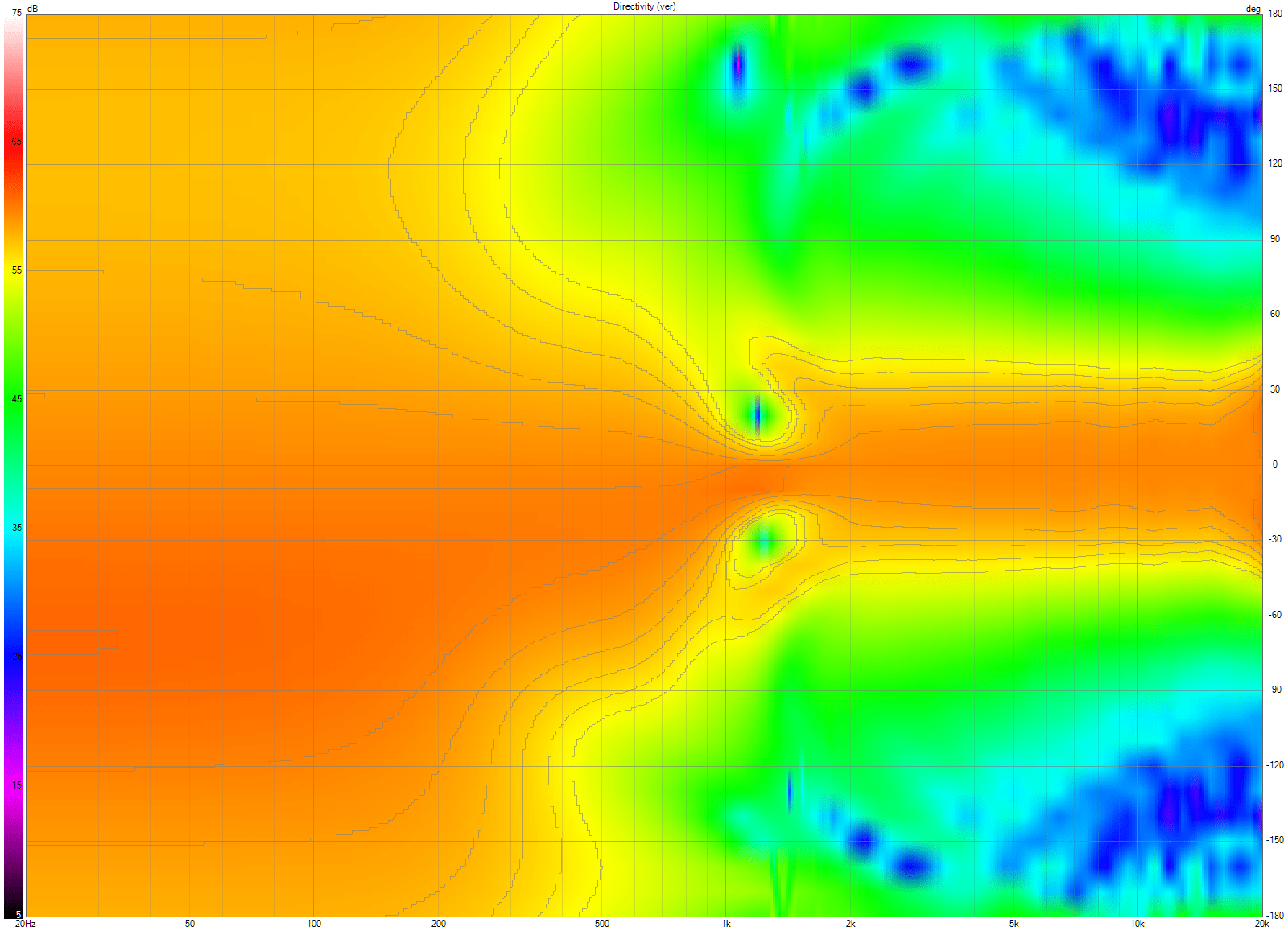

My speakers are smaller than the Summa but I wonder how close these sound compared to the full size Summa (minus the LF extension in the simulations). This is 8 inch freestanding over 8 inch woofer. They miss the mark on the polars by apprx 300Hz if I read the Summa polar data correctly. My simulations are also made at 20 degree listening axis/toe-in.
Something I've noticed is when the speakers are positioned on the long wall of a rectangular room (with unequal side wall distances) the soundstage is only as wide as the speakers. When the speakers are placed on the narrow wall with equal distance to side walls the soundstage is as large as the whole front wall. Yet neither imaging nor intelligibility seem to be damaged despite the larger soundstage width. I also toe them in like Geddes recommends for his speakers. Even though I have extremely limited listening experience I'm convinced Geddes' theories about waveguide sound and positioning are solid => if my speakers are close enough to his that I'm hearing what he gets to hear. This type of waveguide speaker set up the way Geddes describes sounds exceptionally good to my ear.
I have no doubt other designs and setups are good - possibly superior - but Geddes' waveguide way is extremely good when sitting at normal residential listening distances. Of all the choices people have when they setup a system I would recommend this as one of the good options among many good options.

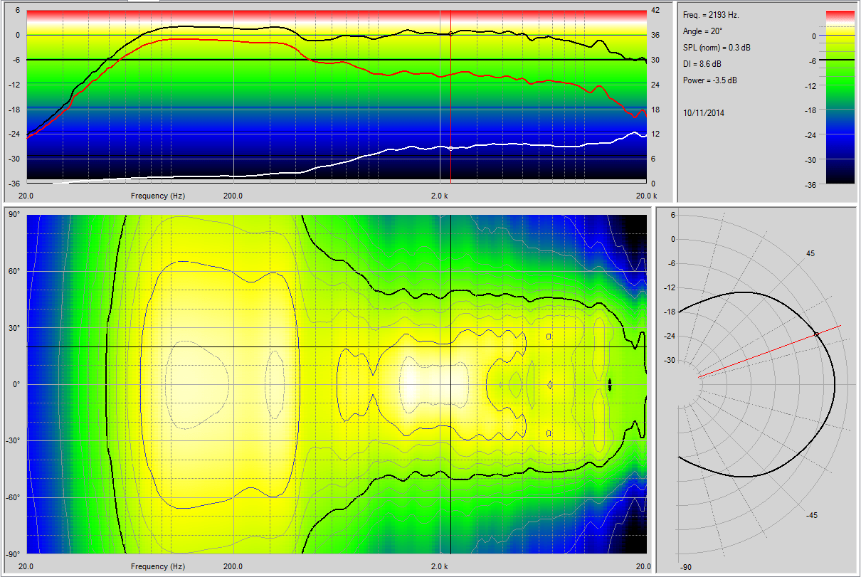

Here are the Summa 20 degree real life non-simulated measurements

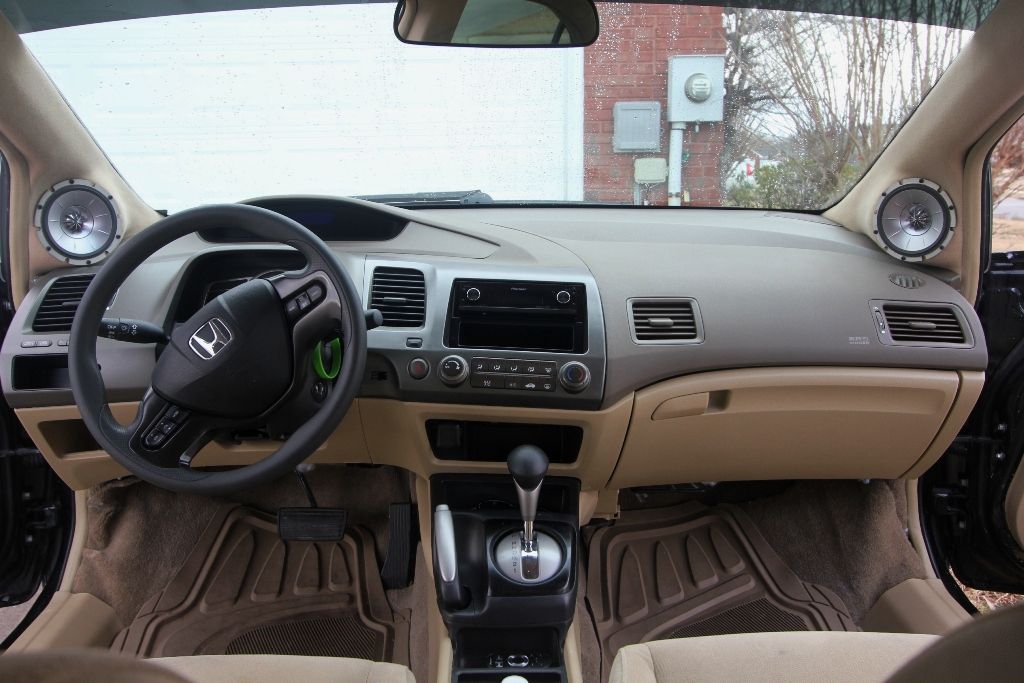

Of all the projects I've ever worked on, the 2nd time that I put Unity horns in a car was one of my projects that turned out particularly well. I did something somewhat radical, which was that I put the horns up on the dash, and I used the windshield itself to extend the horn mouth. The idea that I had was that if you got the first 8-12cm right, the rest of the horn could be less than perfect, but it would still (mostly) work like a horn.
This was quite a bit different than what most horn cars were doing in the 90s and in the 00s; in the 90s people were putting horns under the dash of cars, largely because it was a way to put the speakers as far away as humanly possible. In 1995, there were no affordable DSPs and the most famous horn car was owned by a multimillionaire who poured tons of money into his car. He'd literally sold his Ferrari Testarossa to build a car stereo: https://www.racingjunk.com/news/richard-clark-the-buick-grand-national-guru/
Maybe I'm daft, but I got the impression that nearly all of the horn cars were mostly focused on copying Clark's formula, and while it was a very good formula in 1988, by 2004 we had some other options available to us. Particularly because compression drivers were getting very small and DSP was getting very cheap.
So I took the first stab at it in 2006 or so, and then I did it again in 2008, and it was the second design that really shined. I really and truly think it's one of the most successful projects I've ever done.
And then Erin did basically the same thing with some Kef coaxes and my mind was blown.
He's super smart and there's a 99% chance that he came up with all of it on his own, but I got the impression that he was just about the only person that grasped the idea that you can take the entire windshield and turn it into a waveguide. One of these days, Ford or BMW or Mercedes might wake up to this idea, and it's kinda boggled my mind that we don't see this more often:
