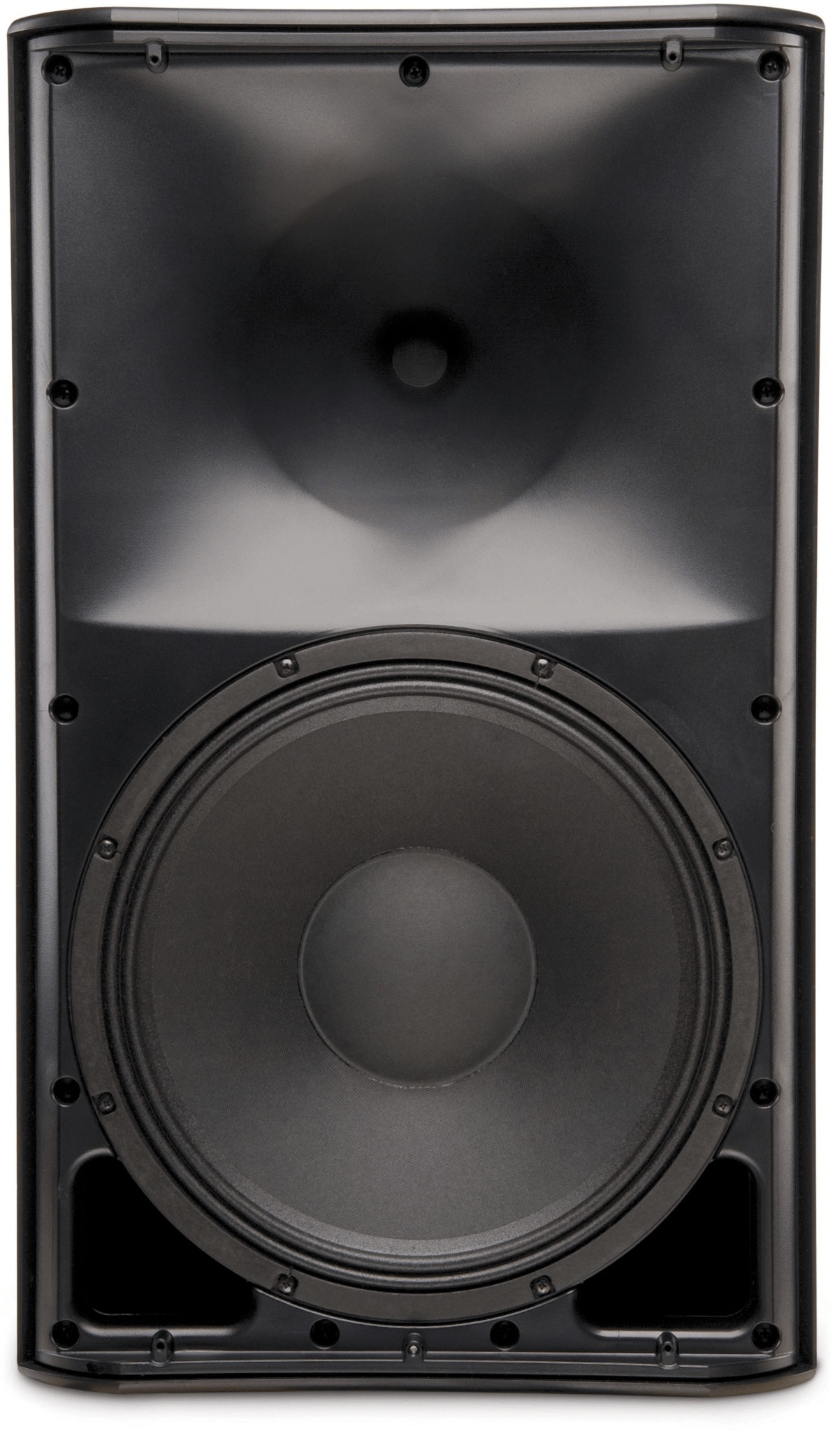

Current QSC waveguides are similar to OS waveguides. It's mentioned in this paper, which I don't have on hand at the moment.The QSC waveguide used here is previous gen.
The current QSC K12.2 are interesting....
They top the spinorama chart, even with the KEF Blade meta according to Pierre's site.
https://www.spinorama.org/
Of course it's too good to be true.... The data is heavily smoothed. And the pattern is of course quite narrow.
Nevertheless, you have to give credit to the effort made to smooth all the potential diffraction points.

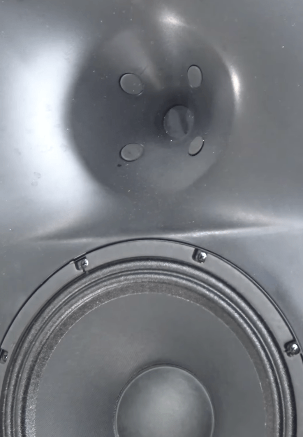

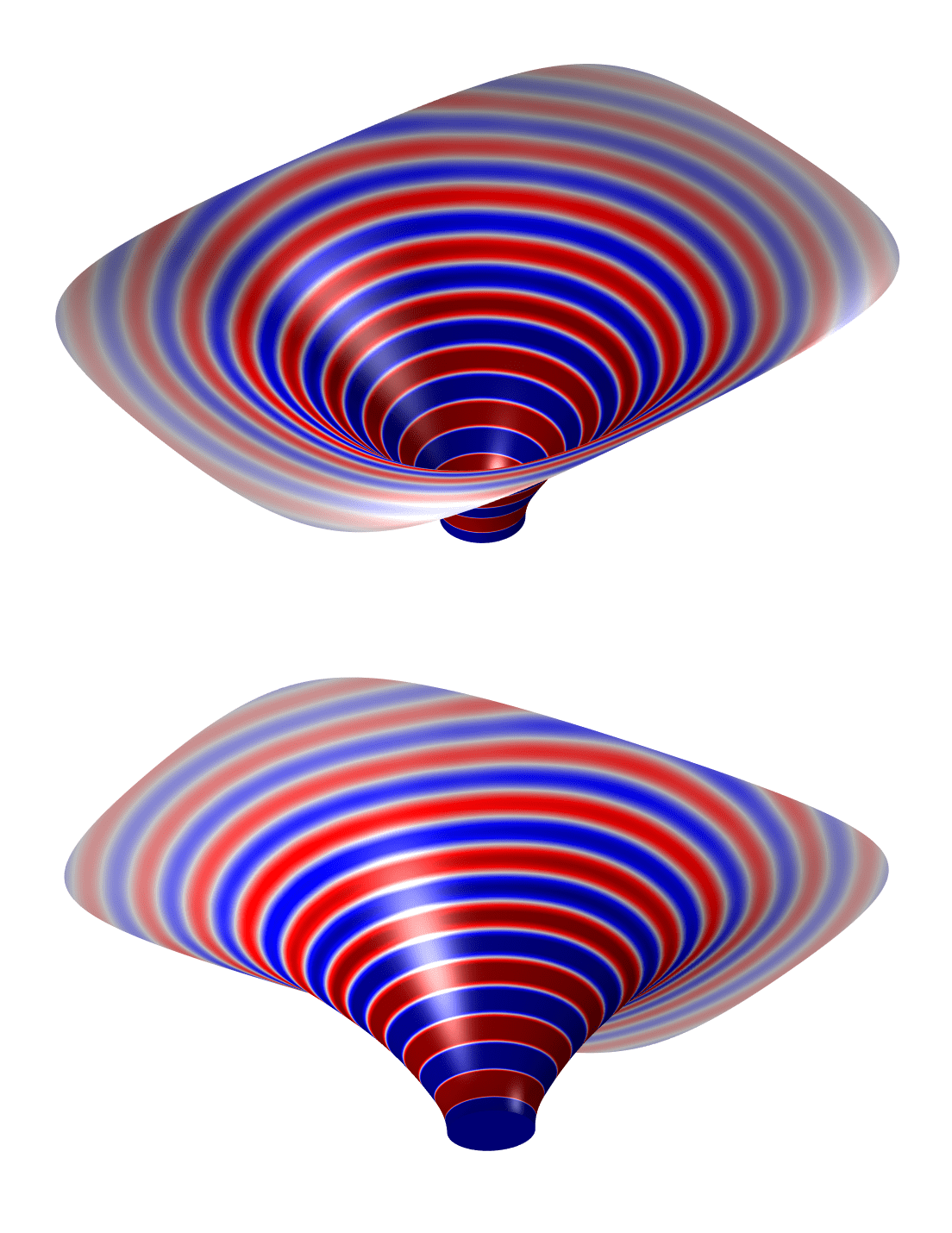

Also, the more that I've messed around with "M2-ish" waveguides, the less aggressive I've made the diffraction slot. Basically, if the surface of the waveguide gets too crazy, the frequency response suffers.
Attached is the latest waveguide that I've made, and it's similar to the one from post 508, but I think the new one should perform better. (The sims definitely look good.)
I've attached the 123D file, which you can open in 123D or Fusion. I've also attached the STL. The model is setup so that you can throw it on your printer, it basically has a raft and some supports built right into the STL file. Obviously, you'll want to cut away the raft and supports after you print it.
It's designed for the SB Acoustics SB19 tweeter, available at Madisound or Meniscus.
It's also a Unity horn; the midranges it's designed for are Tymphany TG9FD. I'm 90% certain that the Tymphany TC9FD should work also.
The file names for the Unity horn version is "Feb 2 2023 cardioid Unity Horn - TG9FD sliced"
I also found a version of the same waveguide that isn't a Unity horn; it's just a plain ol' waveguide.
The file names for that are "Feb 2 SB19 waveguide"
