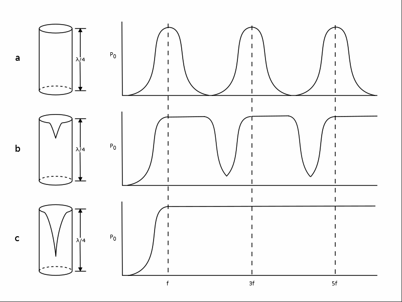

Hasn't anyone pointed out that the M2 waveguide diffraction slot is basically a Karlson waveguide? Which is basically a tube-to-space impedance coupler? And a dome tweeter would loosely be a transducer "for tubes" in it's pistonic range. Is the phase plug in compression horns then a "ring to tube" impedance coupler?
I suppose a dome tweeter could also be a spherical radiator, maybe a ring tweeter would be more suitable for Karlson waveguides? Possibly a compression driver can have optimal coupling to a tube geometry by the design of it's phase plug?
The comparison with a Karlson coupler has been made before, I think.
The phaseplug in a compression driver (traditional dome or annular diaphragm) does indeed 'shape' the wavefront.
For more or less the same reasons a ringradiator-tweeter (like the XT25) not only works very well with waveguides but also with long horns.

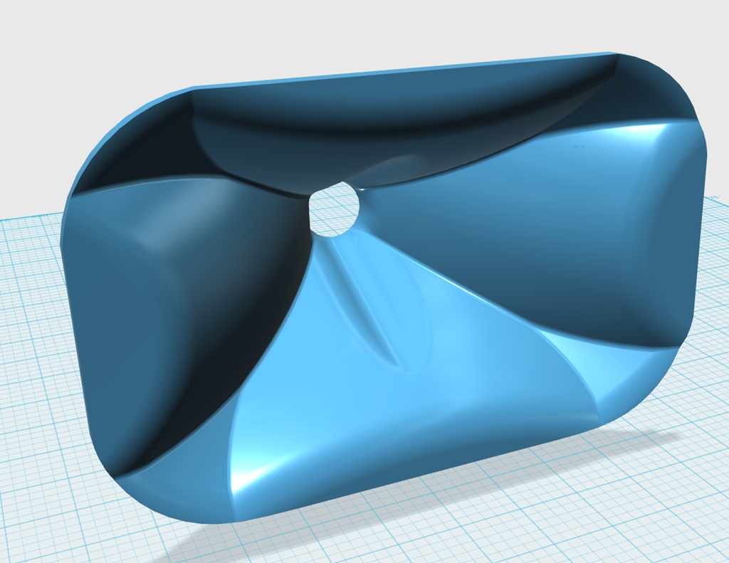

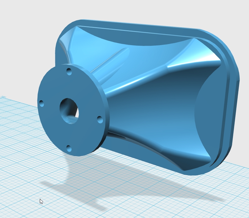

MEGA Here's a link to the 123D model, which you can open and modify in 123D. I believe you can also open this in Autodesk Fusion.
MEGA Here's a link to the model in STL. You can open this with just about anything. You can print this directly to your 3D printer.

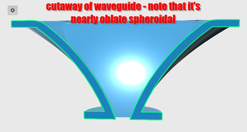

The spherical parts of the waveguide make it look like it's narrow, but it's actually quite wide. Here's a cutaway. The exit angle of the BMS 4552 is matched to the entrance angle of the waveguide. This isn't an OS waveguide but it shares some of the design ideals: there's a slooooow transition from the exit of the compression driver to the mouth of the horn.

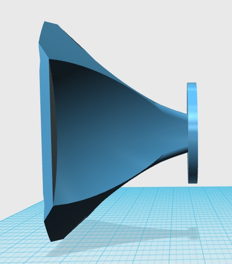

Overhead view.

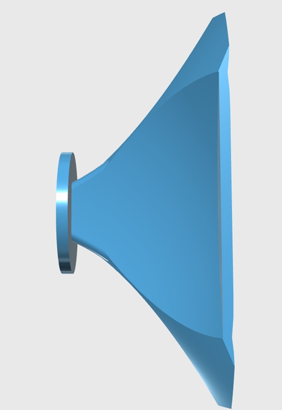

Side view.
This is what the waveguide looked like before I added the 4367's vertical diffraction slot.
The waveguide measures 16.2cm x 23.4cm x 10.9cm. For comparison's sake, the PT waveguide used in the econowave measures 16.3cm x 30.23cm x 11.2cm

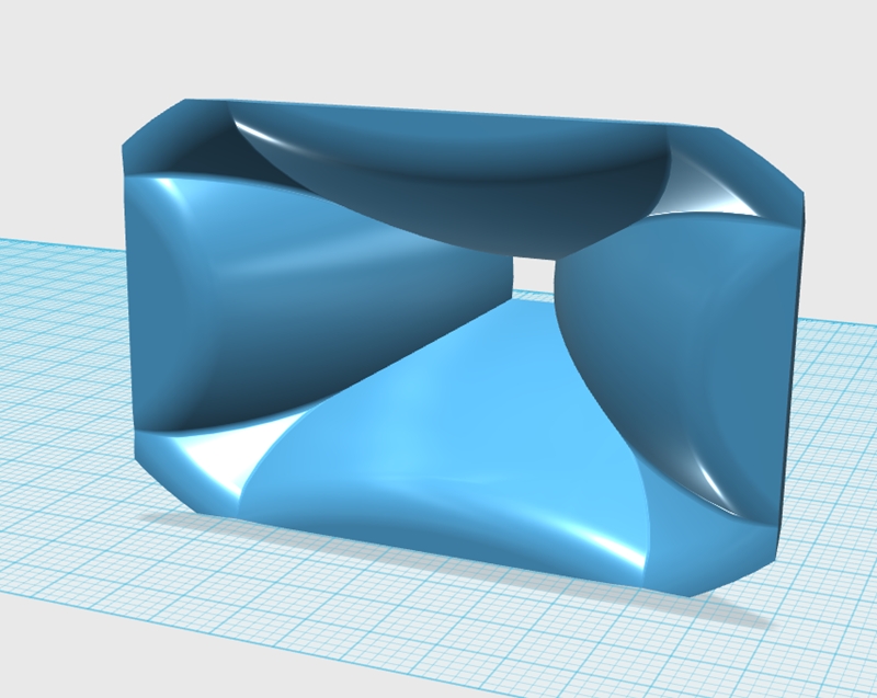

Attached is the latest waveguide that I've made, and it's similar to the one from post 508, but I think the new one should perform better. (The sims definitely look good.)
I've attached the 123D file, which you can open in 123D or Fusion. I've also attached the STL. The model is setup so that you can throw it on your printer, it basically has a raft and some supports built right into the STL file. Obviously, you'll want to cut away the raft and supports after you print it.
It's designed for the SB Acoustics SB19 tweeter, available at Madisound or Meniscus.
It's also a Unity horn; the midranges it's designed for are Tymphany TG9FD. I'm 90% certain that the Tymphany TC9FD should work also.
The file names for the Unity horn version is "Feb 2 2023 cardioid Unity Horn - TG9FD sliced"
I also found a version of the same waveguide that isn't a Unity horn; it's just a plain ol' waveguide.
The file names for that are "Feb 2 SB19 waveguide"

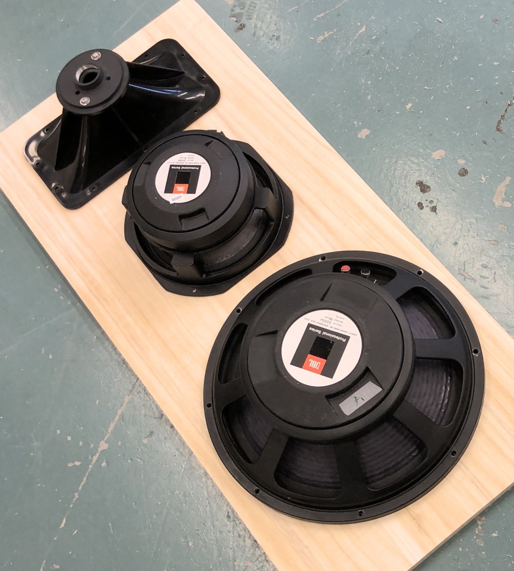

I have also been interested in this but did put a JBL 2123 10" in between the 15" and the horn. But I'm still searching for the 2 way solution.

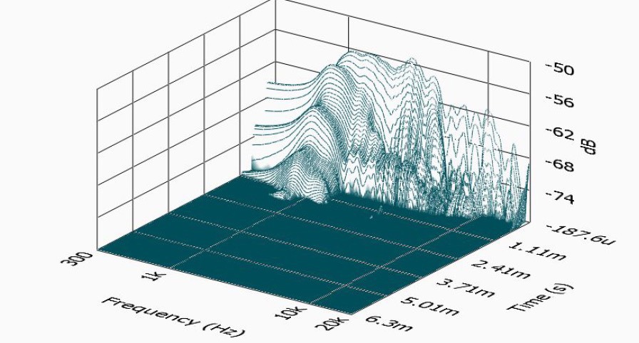

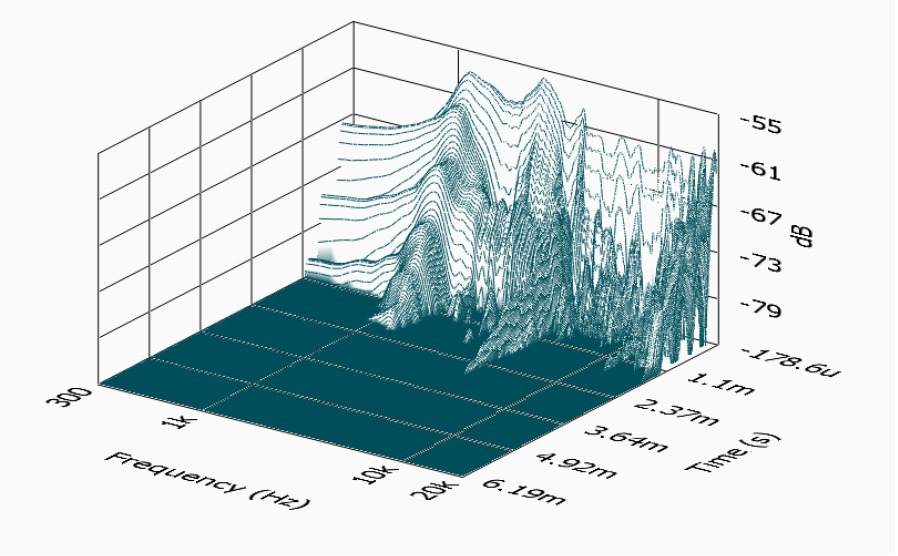

I've attached two waterfall plots from Vance Dickason at Audioxpress. One is of the B&C DE550, which is a conventional (dome) compression driver. The other is of an Eminence N151M (ring) compression driver. Note how the Eminence is cleaner, despite costing $95 vs $214 for the B&C.
This isn't to say the DE550 is "bad", just saying the Eminence is cleaner, if you can live with a higher xover point.

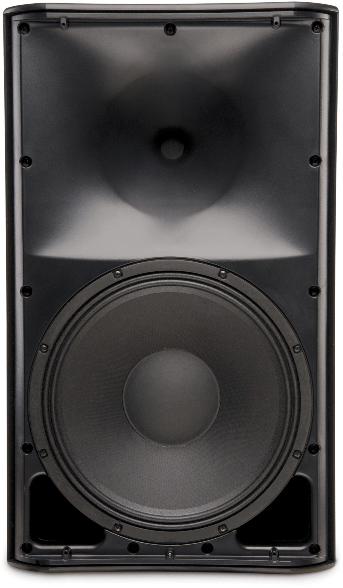

So I took an Eminence N151M and a QSC waveguide, put them in a box that's fairly similar in dimensions to the 4329P, and measured the polar response and distortion:
Here's a nearfield distortion measurement with no high pass and no EQ. Note that the vertical scale is much larger than normal. If I'd used the typical distortion scale, it doesn't even show up on the graph!
Here's the polar response with no EQ and no smoothing
Same as above, but with twelfth octave smoothing
Here's the polar response with equalization. I was trying to equalize it flat, but missed the mark and basically ran out of time to clean up that EQ. You can see from the measurement that the N151M/QSC combo is VERY amenable to equalization. Basically all the curves follow each other in shape, there's no weird wiggles or discontinuities off-axis
To add some context of how good the QSC/Eminence combo is, here are the measurements published by Vance Dickason at Audioxpress, using the horn provided by Eminence. You can see that the QSC waveguide is a much better match than Eminence's own waveguide. Which is no surprise really, considering the Eminence horn is an old-school diffraction horn.
All in all, I still think this combo is about as good as it gets at this price point. I measured this same combo years ago, but wanted to repeat the measurement a second time before making any sawdust. The original measurements I made are here: https://www.diyaudio.com/community/threads/improved-saw-lens.350889/page-2
