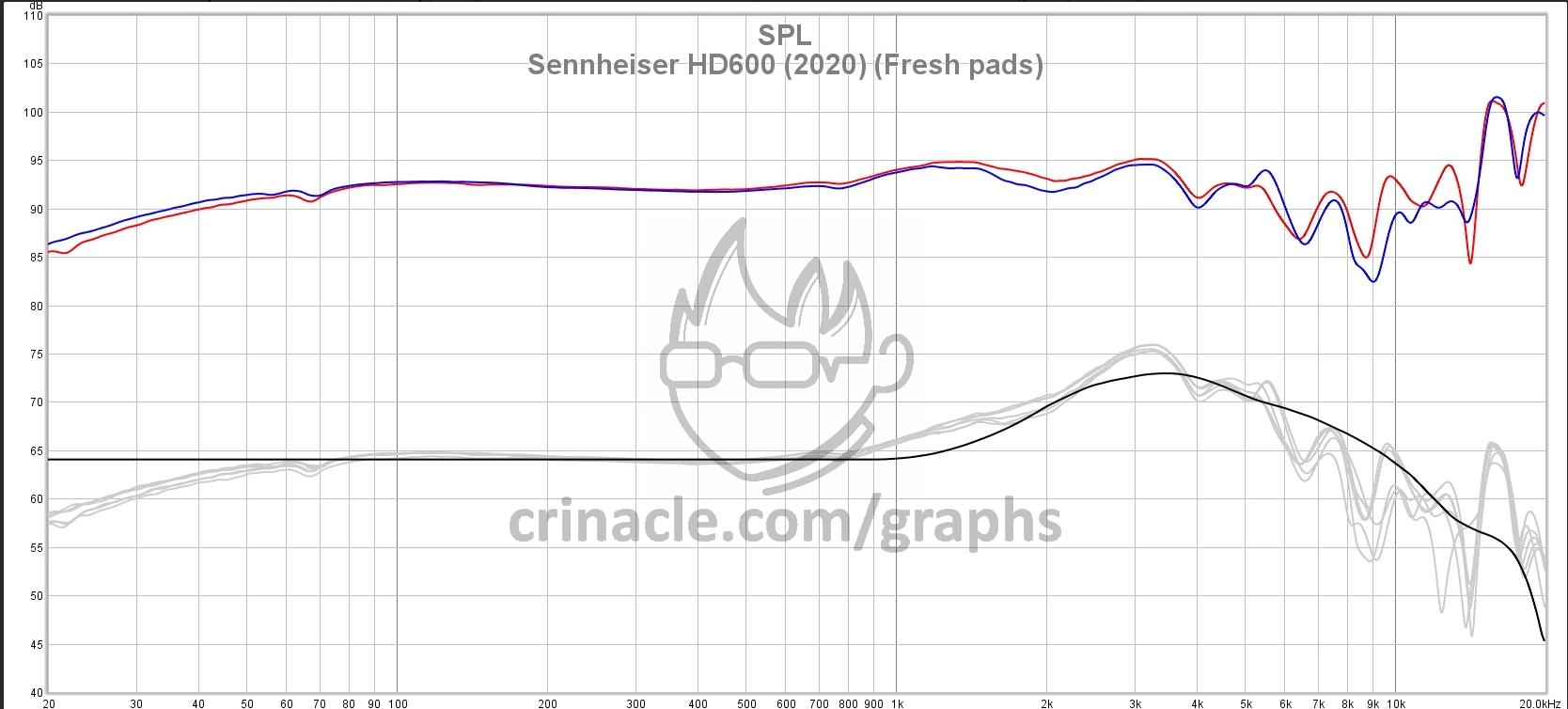

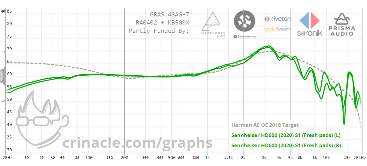

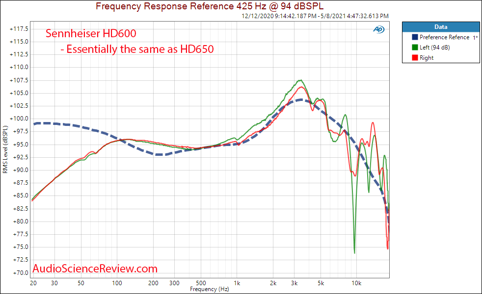

HD600 is one of the flattest headphones you can buy.....I know what I'm hearing is my HD600 and not the JBL

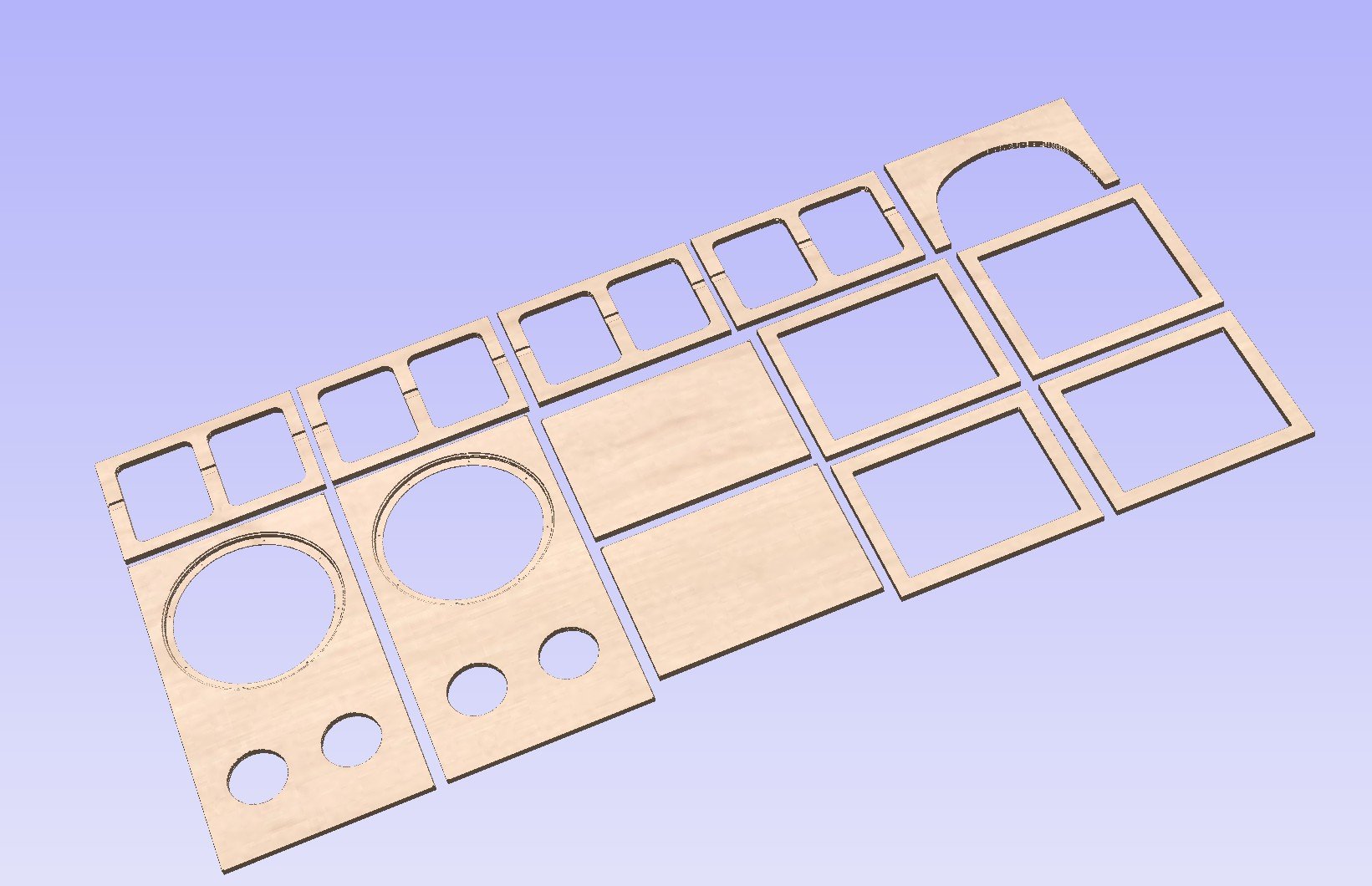

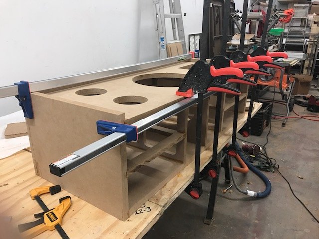

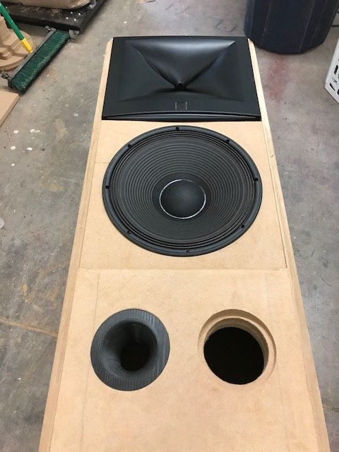

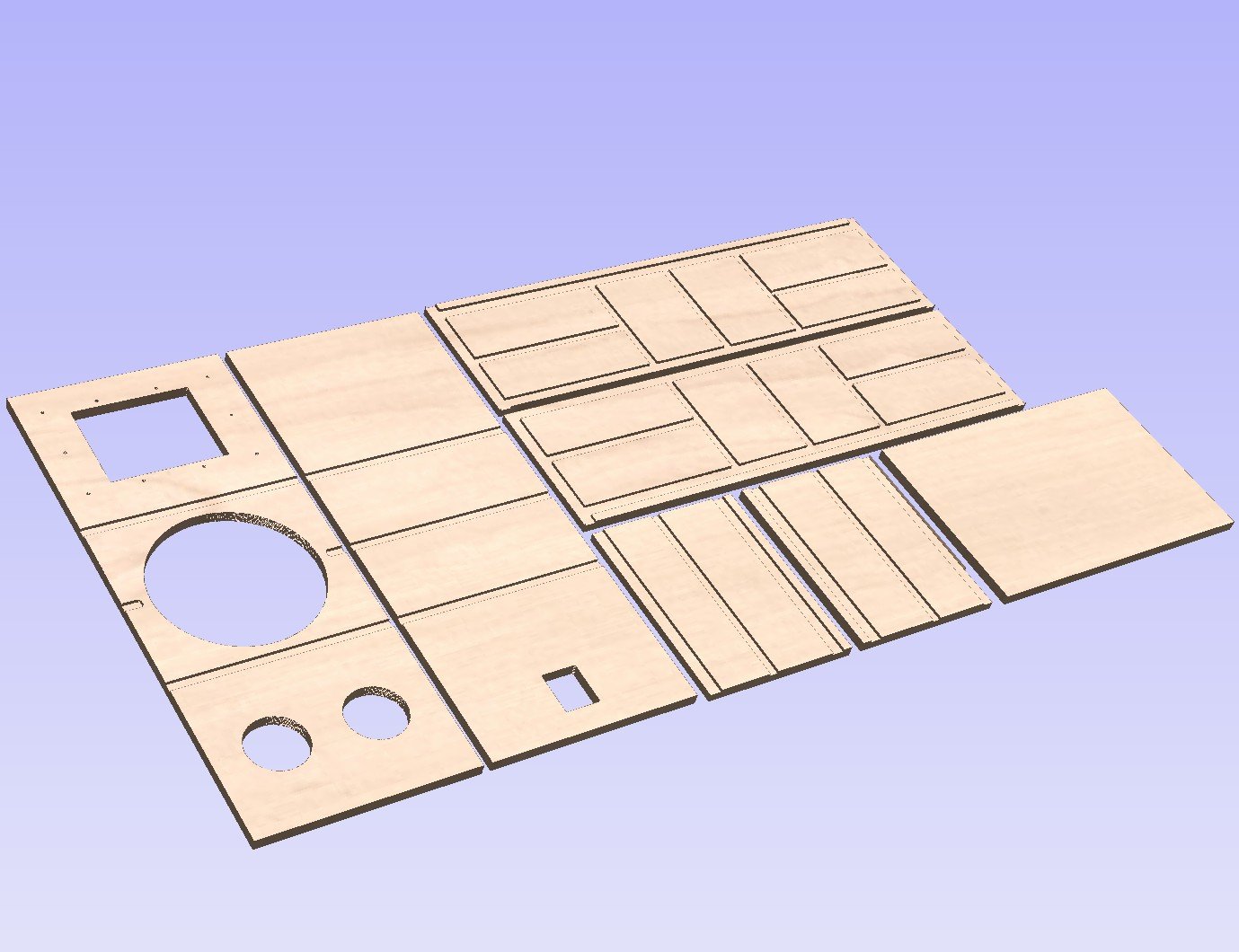

This is the closest thing to a build thread.🟡 Hello Friend! How do I run this project? I searched the fórum audioheritage but it's all very confusing, there's no cut project, speaker suppliers, step-by-step assembly scheme, etc.
Perhaps this guy is willing to share his drawings.
That FR is based around a curve that is meant to be nuetral to the ear for the case of headphones and in ear monitors ... Im not sure why exactly they do this but it is on purpose, that I do know
How this translates to concept of O transfer function and loudspeakers, I don't know

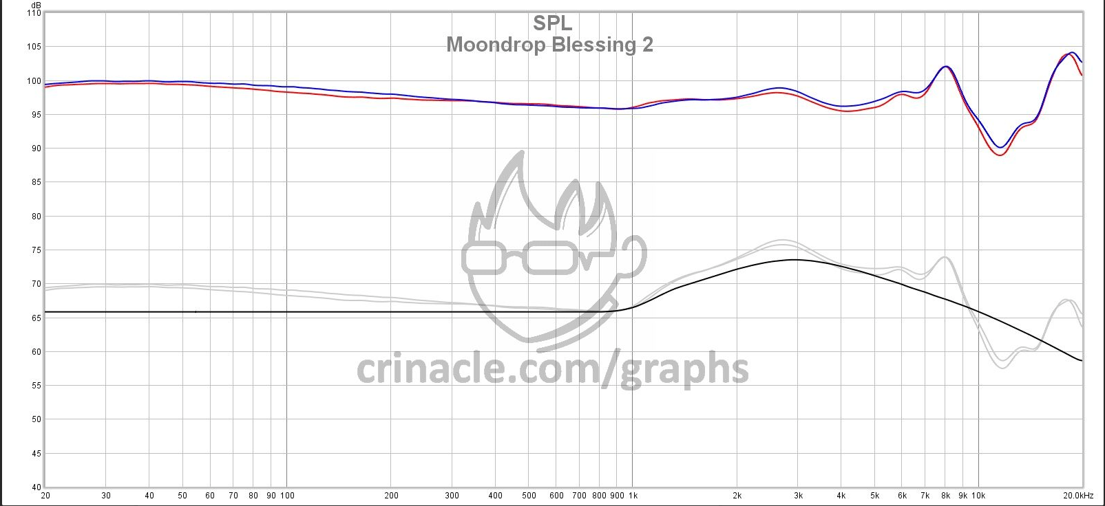

Lol you and me both...I was just researching headphones and was reminded which is why at least some of this if fresh in my mind....I wanted some quality IEM's and settle on the MoonBlessings2
The top red and blue are "normalized" but the black solid line below represents the Target Curve for "neutral" for headphones and IEM apparently....It really doesn't make sense to me at first glance but once upon a time I did read why exactly this is the neutral transfer function for said products, at this time the background information evades me lol
IEM's have a different target to over the ear headphones. As with speakers before much work has been done by Sean OliveIt really doesn't make sense to me at first glance but once upon a time I did read why exactly this is the neutral transfer function for said products, at this time the background information evades me lol

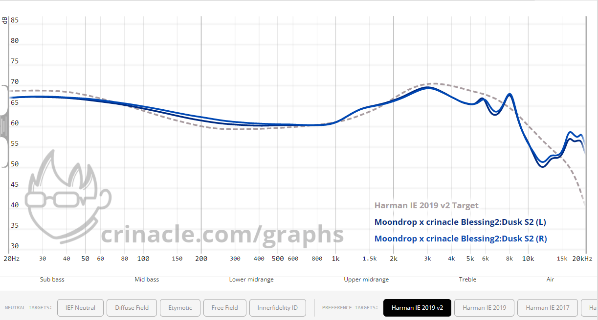

That is the crinacle target, the Harman one has more of a bass boost.
This comparison tool allows you to select all of the different target curves compared against measurements.
https://crinacle.com/graphs/iems/graphtool/?share=Harman_IE_2019_v2_Target,Dusk_S2

That would make the HD600 curve what then? I once thought that the IEM had a specific target curve to reach a 0 transfer function that looked similar to the these curves that have the peak at ~3khz but now I am not so sure... Now that I see that Etymotic has its own idea of the correct curve.
"To keep things short and sweet: what was originally known as the “Crinacle Target” will now be replaced with the “IEF Neutral Target”, which adds on a little extra ear gain at 2-6kHz (creating a peak centred at 3kHz that is roughly +8dB relative to 800Hz) so as to keep it more in line with what I find to be “perceptibly neutral”.
"3. Flat on the graph DOES NOT MEAN flat in real life. The fact that IEMs bypass the outer ear structure necessitates higher SPL in the 2-5k regions as compensation (see: Diffuse Field, Head Related Transfer Function, Harman Target)"
and finally
"3. Flat on the graph DOES NOT MEAN flat in real life. The fact that headphones bypass the head necessitates higher SPL in the 2-5k regions as compensation (see: Diffuse Field, Head Related Transfer Function, Harman Target)."
OK so headphones and IEM both should not aim for Neutral FR due to the same ideas. IEM and Headphones won't have the same curve but neither should be aiming for dead flat like a loudspeaker would if aiming for neutral playback
I'm now noticing that the target curves for the IEM and Headphone above are slightly different.

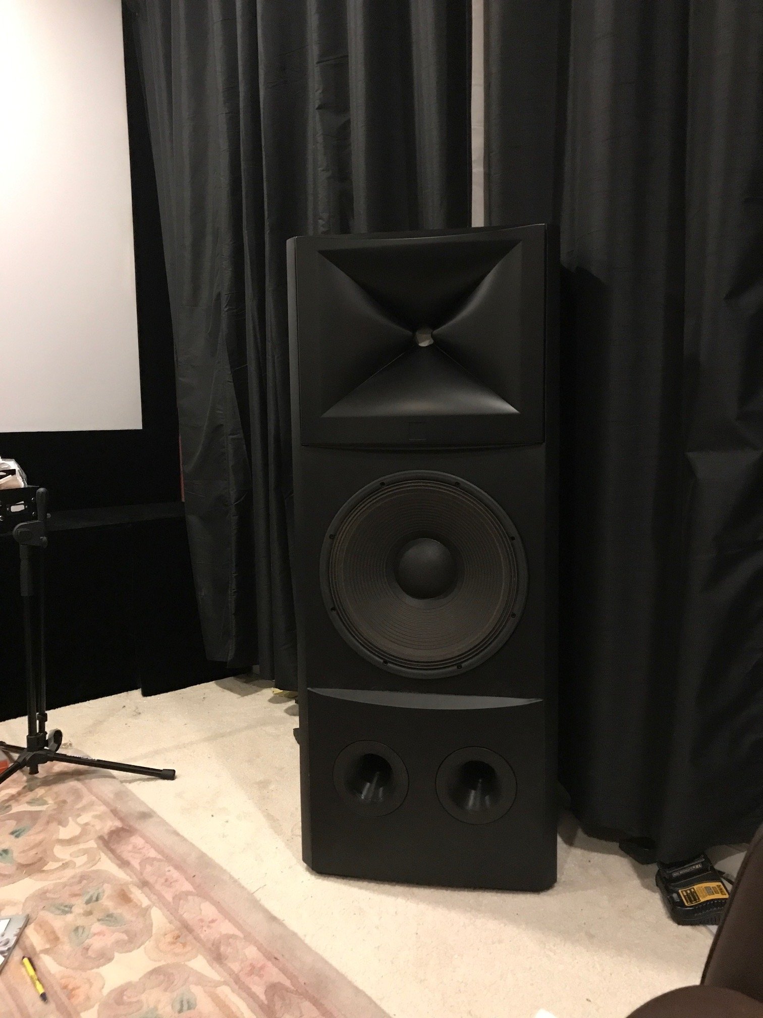

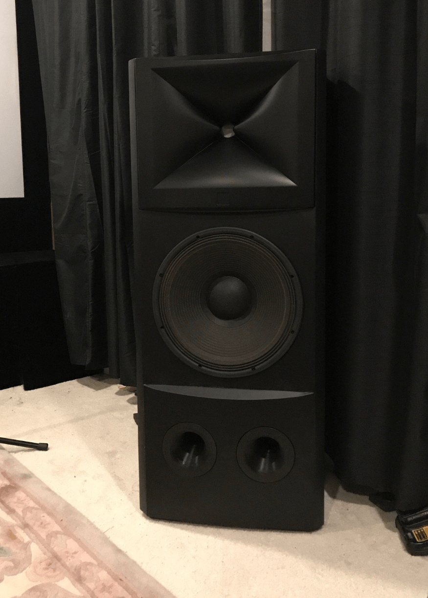

The M2 is an archetypal large format 2 way, isn't it?
It's been almost 10 years since it was announced.
However, the best, most thorough review is less than a year old
