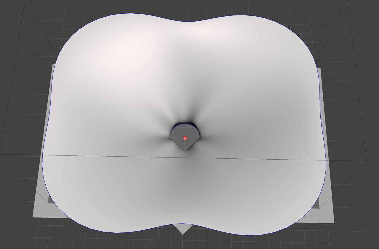

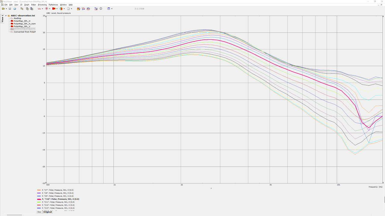

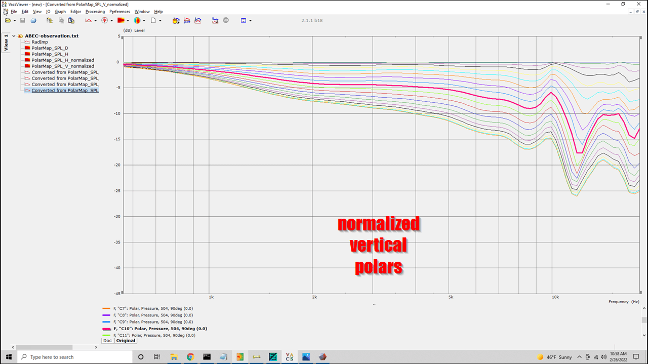

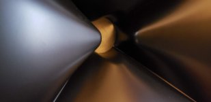

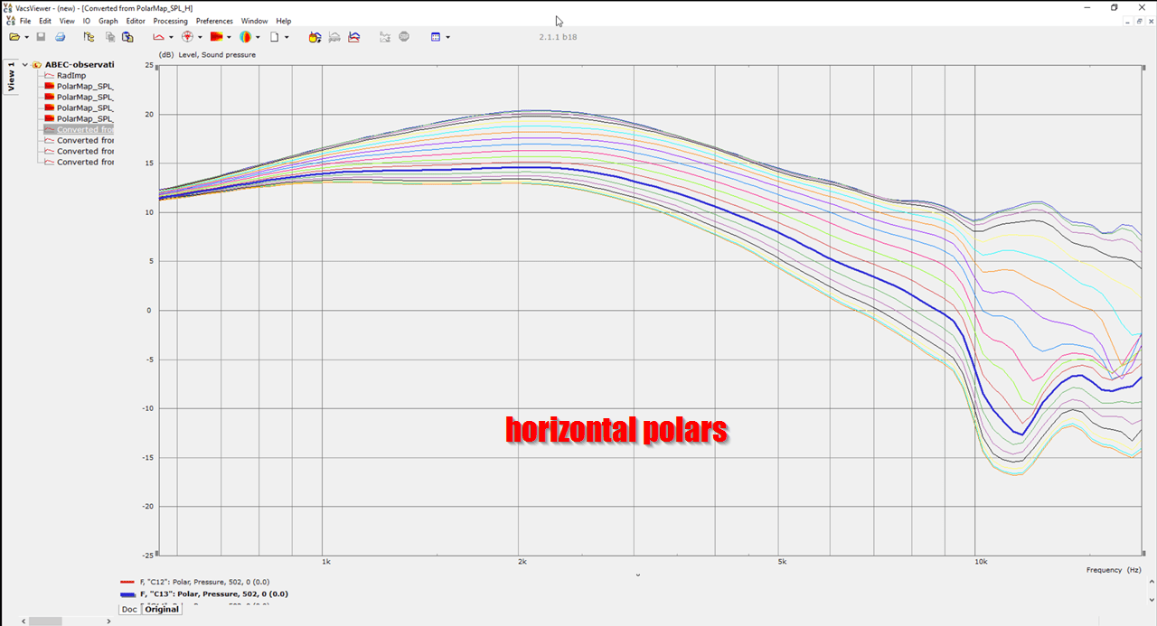

Here's a waveguide that's a bit of an "homage" to the JBL Image Control waveguides. This one uses a SB Acoustics SB26ADC tweeter.
The high frequency dip is a bit intentional; basically I wanted to widen the beamwidth at high frequency, and that came at the expensive of an off-axis dip. I doubt a narrow dip at 15khz will be audible.
The beamwidth on this waveguide is exceptionally wide, about 130 degrees of beamwidth in the lower two octaves. Beamwidth narrows in the top octave, which is why I added a diffraction slot.
The reports look strange because for some reason it's drawing two traces for every line. Not sure why. Here's my ATH script:

Here's what happens if you take the diffraction slot and you rotate it 45 degrees.
The beamwidth of the waveguide is a little bit narrower, and the high frequency dip is 'pushed' up in frequency by about 10%.
I think the previous way of doing it (like JBL does) is probably superior. But I had to check.

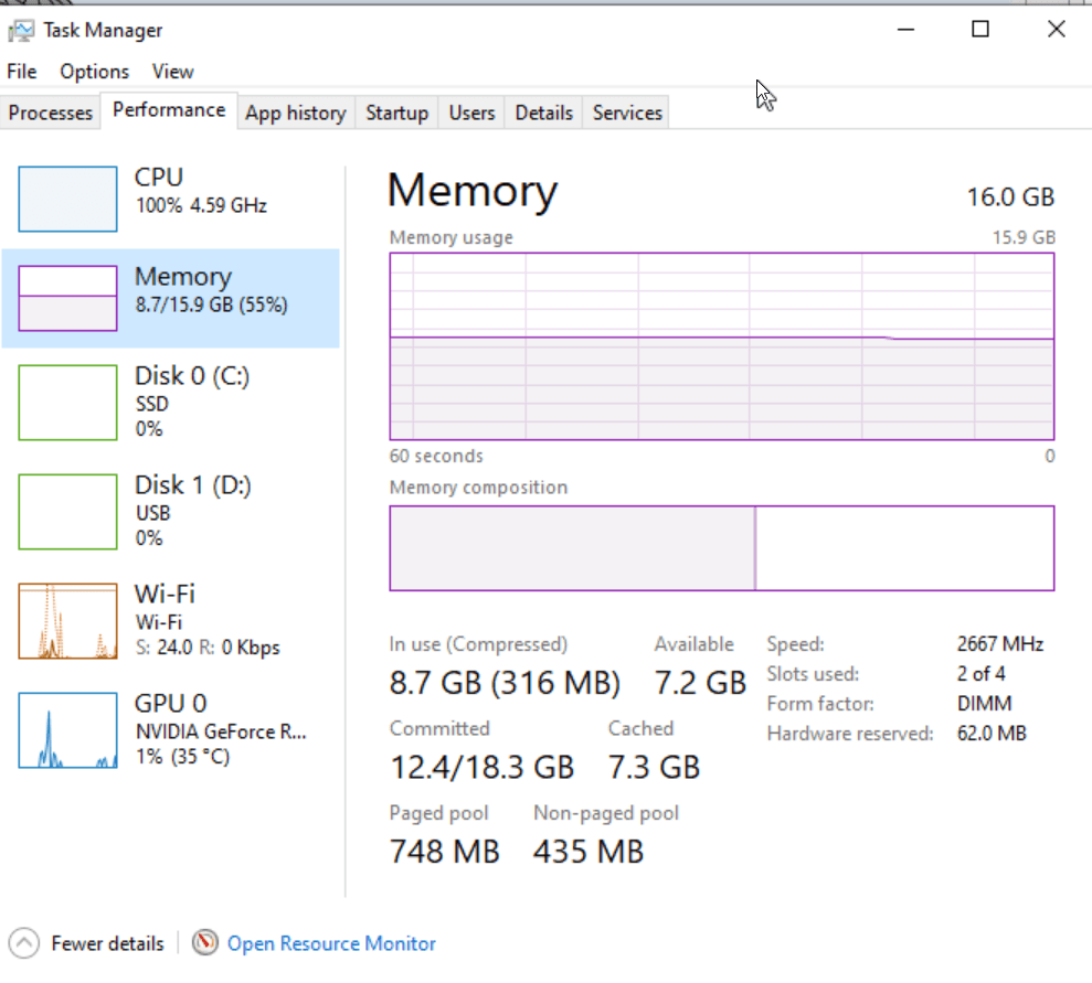

If anyone's curious, I simulated the above model using two different systems:
* On an I7 10700F desktop computer, it took 48 minutes to calculate
* on an I7 10750H laptop computer, it took 96 minutes (yes, exactly twice as long)
The I7 10700F has an MSRP of $298-$308, 8 cores and a turbo clock of 4.8ghz
The I7 10750H has an MSRP of $395, 6 cores and a turbo clock that's identical
I increased the throat resolution from 2mm to 3mm for the desktop simulation, so that definitely impacted processing time.
Did you limit the cores used in ABEC / Akabak? You need to have enough RAM per process to prevent the solving being restricted by moving data in and out of the swap file on your HDD or SSD. I had to upgrade my desktop to >48 GB of RAM to use all 12 threads available, without increasing the solving time versus smaller numbers of threads.
I'll stick some more ram in there, looks like I only have 16GbDid you limit the cores used in ABEC / Akabak? You need to have enough RAM per process to prevent the solving being restricted by moving data in and out of the swap file on your HDD or SSD. I had to upgrade my desktop to >48 GB of RAM to use all 12 threads available, without increasing the solving time versus smaller numbers of threads.

Would you like to expand in ath technical termini how you implemented the JBL approach to a wide top octave?
The polar map looks quite messy, do you see room for optimization?
The polar response above 12khz is a mess, but everything else is really smooth.
The main thing I'm trying to figure out, is if it's possible to "have our cake and eat it too."
Basically:
1) If I want really smooth polar response, from 1khz to 10khz, that's easy. Just use a shallow ATH waveguide, similar to what augerpro is doing in his thread.
2) If I want increased output, a diffraction slot can accomplish that. Even a slot with a depth of 13-25mm will raise your output on the low end by 3dB, minimum.
What I'm trying to figure out, is if some of these "x-shaped" diffraction slots can allow me to increase output on the low end, while keeping the beamwidth wide. It's a game of juggling, basically tweaking the depth of the slot to try to 'push' the dip higher and higher. I could use a diffraction slot that's 6mm in depth and that would certainly move the dip to a frequency where it's inaudible, but at that point the entire point of the diffraction slot becomes questionable.
Complicating all of this is that I'm using a dome tweeter.

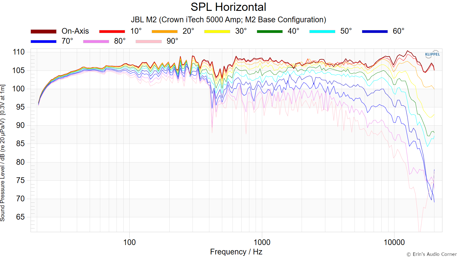

If you look at the polar response of the JBL M2, you can see they faced similar challenges. Basically the beamwidth is super wide from 8khz and down, but above 8khz it narrows and by 12khz the beamwidth of the M2 is getting EXTREMELY narrow.
Attached measurement is courtesy of Erin's Audio Corner.

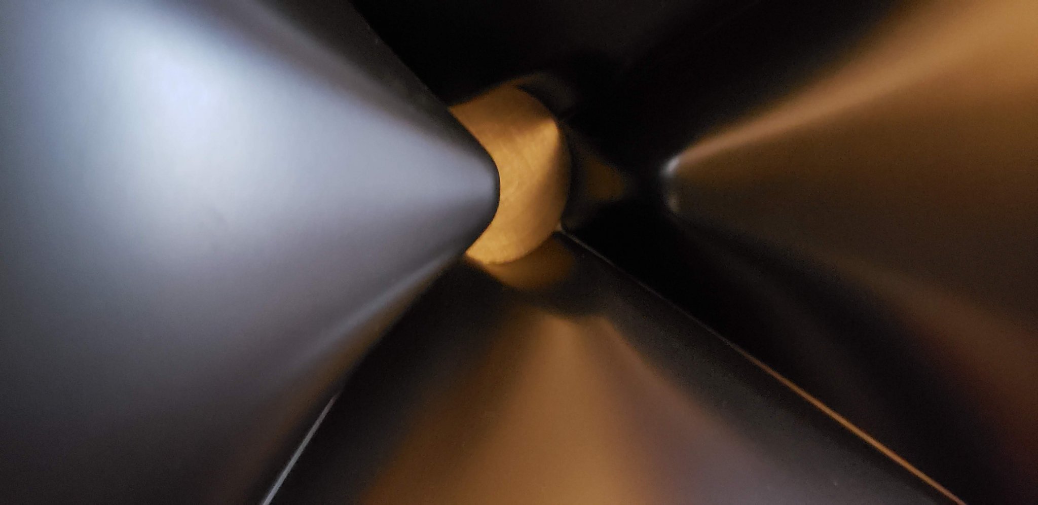

The super-deep diffraction slot seems to trash the response above 10khz, particularly if you're using a dome tweeter instead of a compression driver. JBL seems to have discovered this as well, and many of their consumer speakers are now using compression drivers, while the ones that use dome tweeters barely have a diffraction slot at all:
![waveguide-1-1024x557.jpg](https://cmi.com.au/wp-content/uploads/2020/06/waveguide-1-1024x557.jpg)

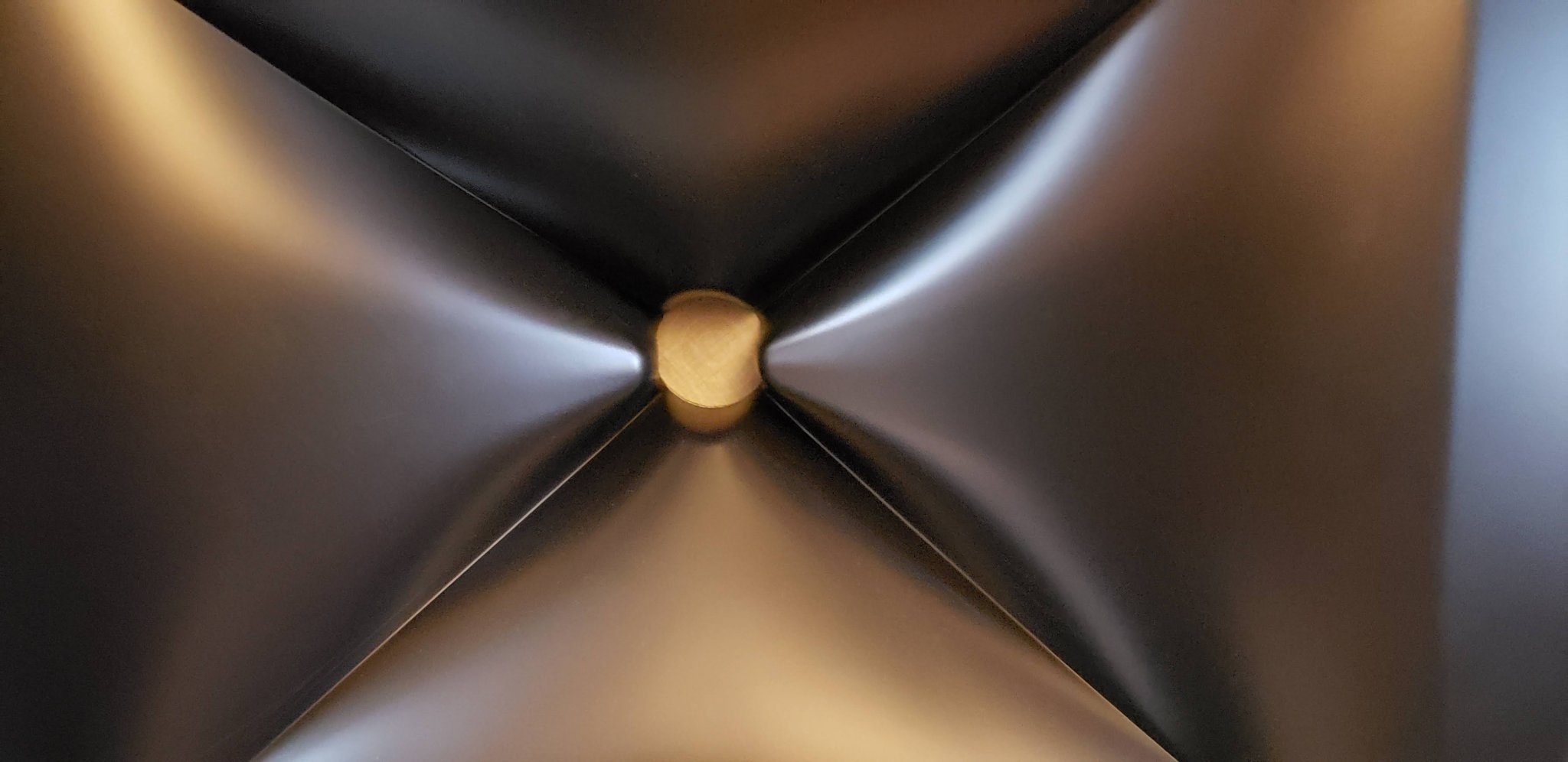

Part of the reason that I started this journey of making waveguides again, was because I bought a pair of the JBL Studio 520c speakers, and though they measure fantastic the tweeter sounds horrendous.
I think the issue is that the waveguide suffers from tons of HOMs, due to the high compression ratio and crummy termination:

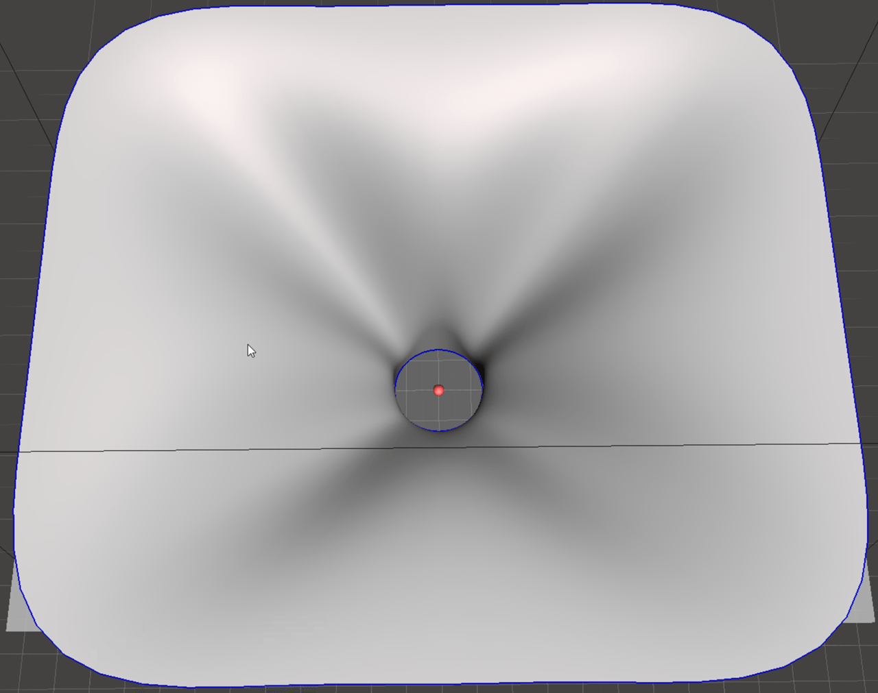

I thought this iteration of the waveguide was going to be "the winner" but it suffers from two issues:
1) At 15khz the horizontal beamwidth is only about 40 degrees. I was really hoping to get that higher. I know I'm limited by the diameter of the dome tweeter but I thought I might be able to improve that. The blue line in the second graph represents the SPL at 60 degrees off axis.
2) Oddly enough, the vertical beamwidth is too wide. I was hoping to use this waveguide in an MTM. At the xover point, the vertical beamwidth of the waveguide is about 120 degrees and that's way too wide. The red line in the 1st graph represents 45 degrees off axis.
I'm beginning to think that a plain ol' vertical diffraction slot might be the way to go here. I could make this into a Unity horn and solve all the issues but I'd really like to make this speaker a two-way not a three way.
