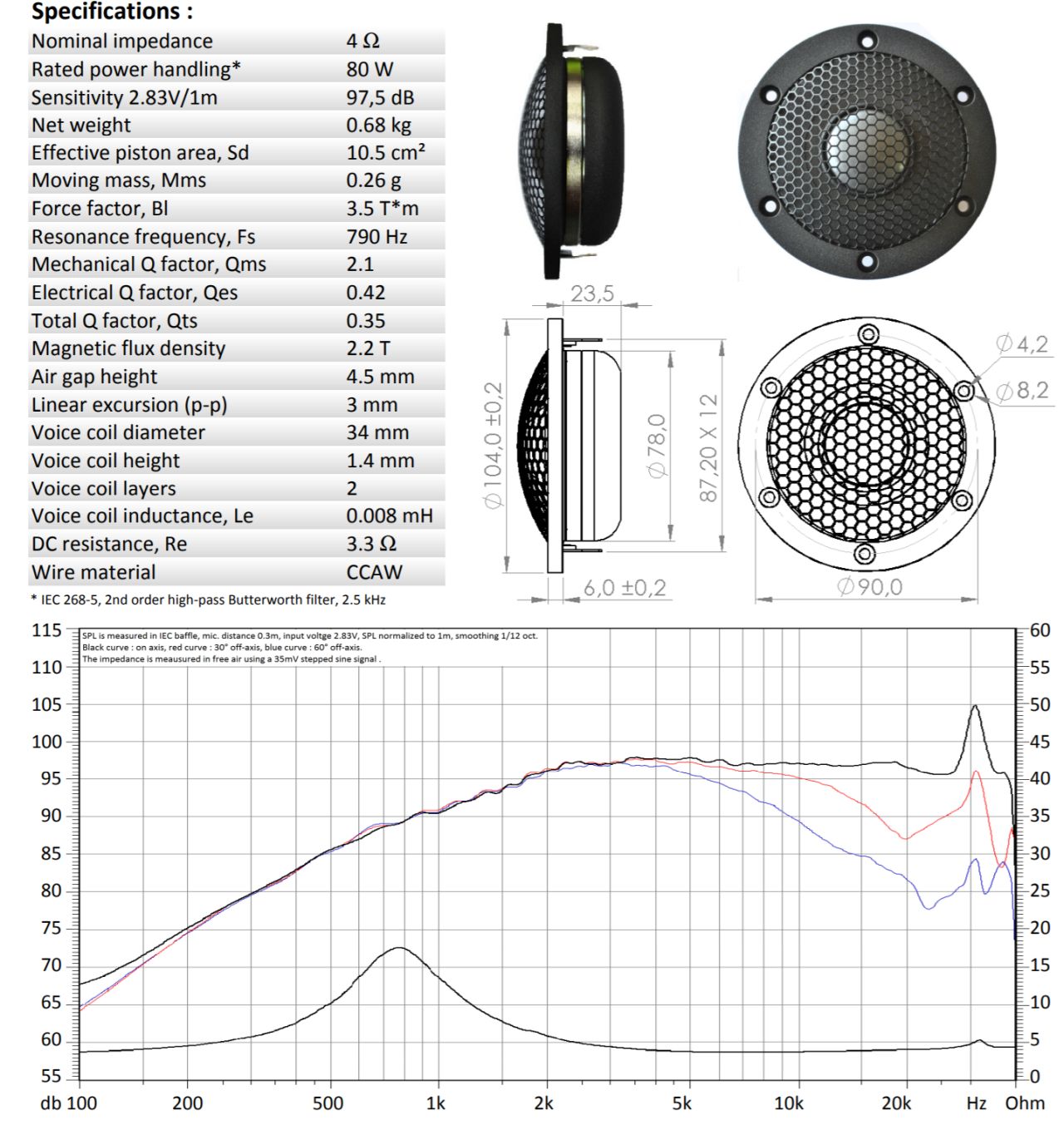

But one interesting thing to consider, is that a beryllium tweeter should be able to offer better dynamics than aluminum. For instance, the Bliesma 34mm beryllium tweeter is about 6dB more efficient than the SB Acoustics SB26ADC.

The actual benefit of beryllium on the efficiency is small.
The benefit of $700 is not small, however.
The Bliesma has more "Force Factor", probably from more magnet, it's a heavier speaker, diameter is more so it moves more air and Mms is smaller.
Obviously a more expensive speaker can afford to use better components and I assume that that's where most of the improvement comes from.
And beryllium speaker tend to be more expensive so it's classic "correlation not causation".
Beryllium can potentially reduce Mms but can't help reduce the voice coil mass, which is typically about half or more.
So it doesn't help much for an otherwise similar speaker.

I don't completely agree with that since the voice coil weight is proportionally rising with diameter. But the dome area is rising with the square of the diameter. Therefore you can gain in terms of Sd/Mms with materials that show a good stiffnes/weight ratio.

Yes, better materials can help improve Sd/Mms.
But my point was that it doesn't help all that much because a lot of the mass is in the voice coil, coil former and the movable part of the suspension.
And beryllium is still two thirds the density of aluminium.
Stiffer too, but if we make the dome much thinner than we lose the benefit of the increased break-up frequency.
And if we increase the diameter to exploit the scale factor, as you posted, then the speaker becomes more directional and beams at lower frequency.
Much of the improvement in "Patrick"s example is just because the more expensive speaker has almost double the flux density and better BL, not from the beryllium dome.
When I did the maths for beryllium domes in my compression drivers I found the improvement smaller than I had hoped.

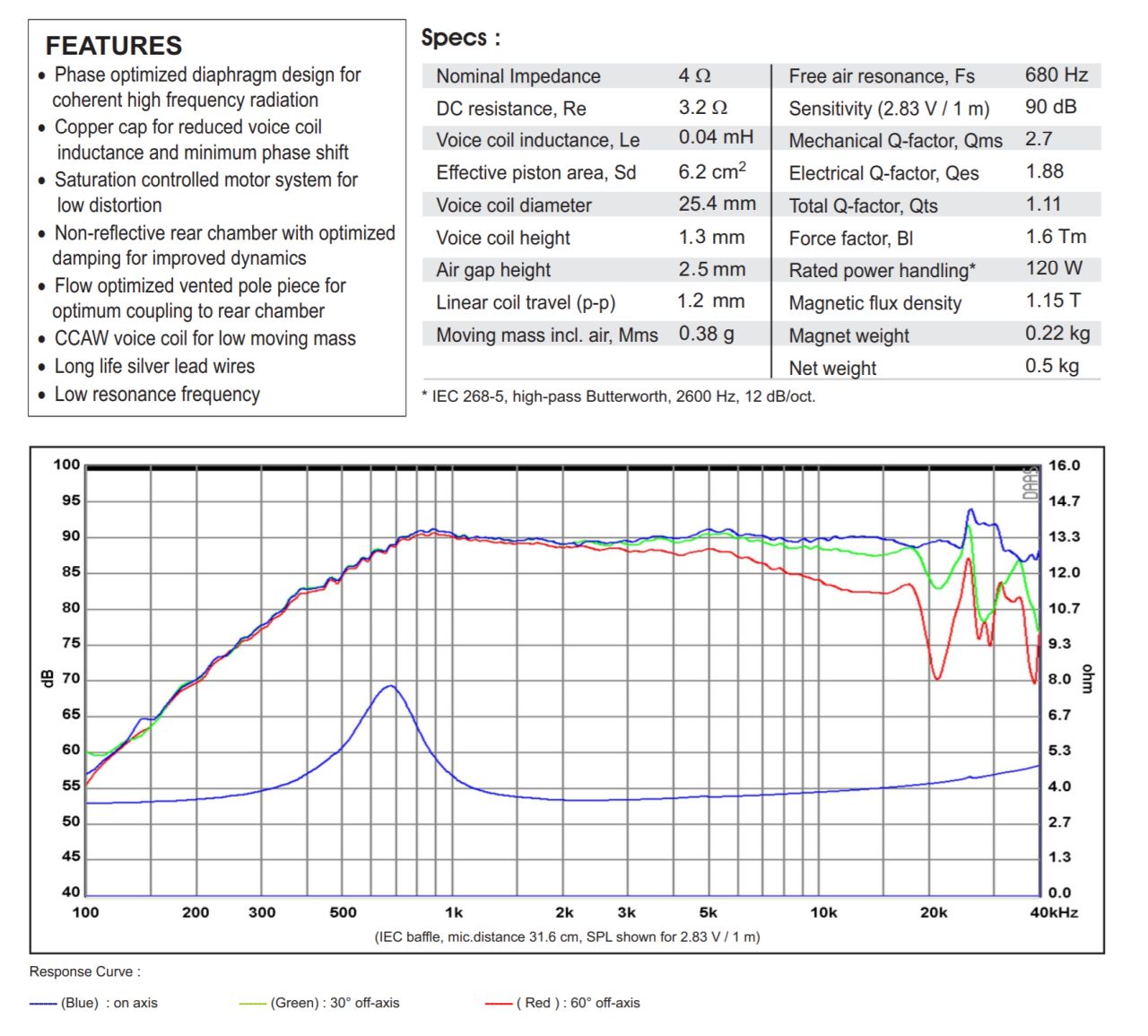

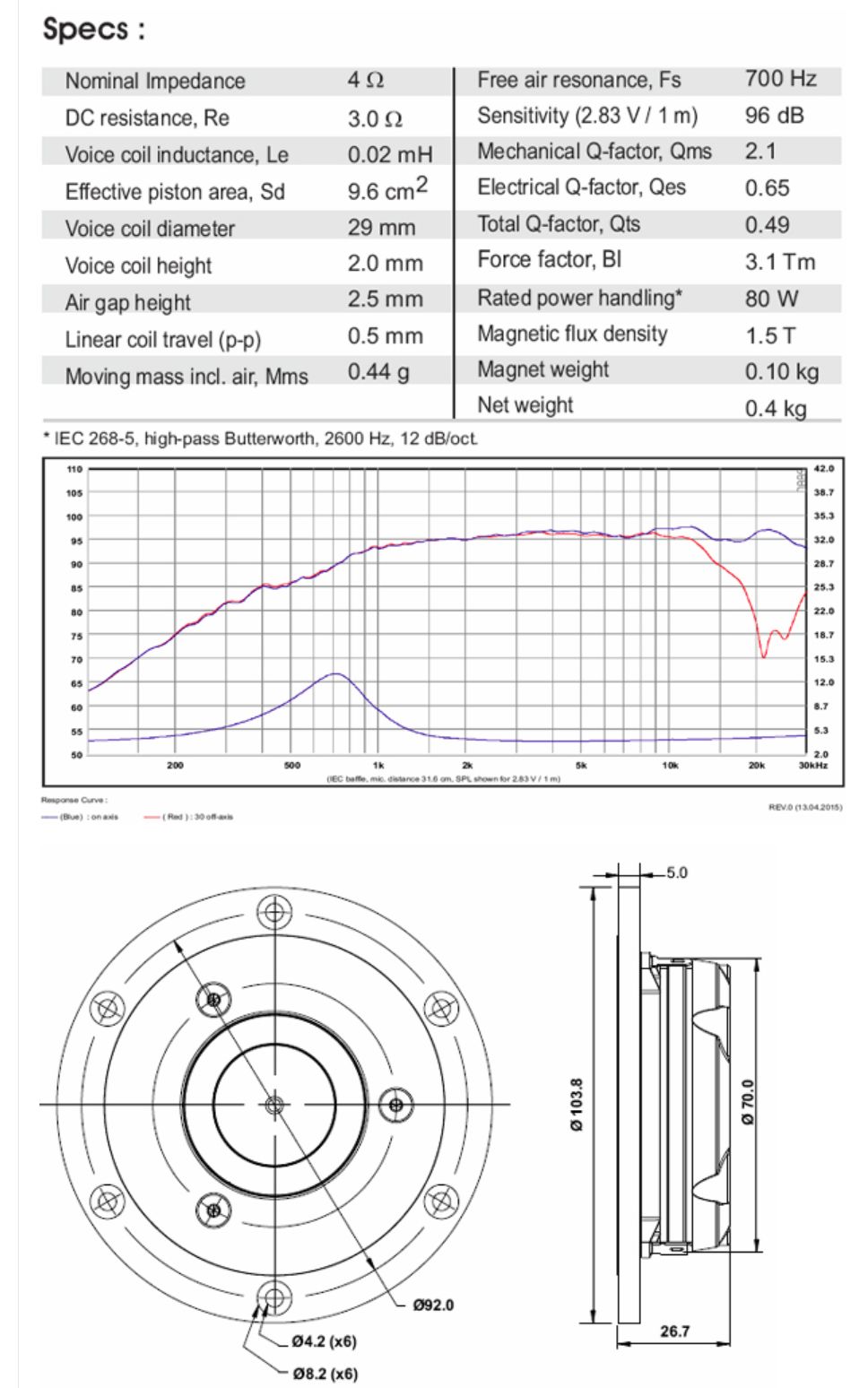

I went looking at tweeters based on BL instead of diaphragm material, and found that there a $150 Satori tweeter with an efficiency of 95dB that uses silk, not beryllium. In the attached spec sheets, note how the Satori tweeter has twice as much BL as the less expensive ($50) option, and is 5dB more efficient.

Just be aware that the parameter that matters is actually BL squared divided by Re.
So you can only directly compare BL for speakers with the same impedance, as your two examples conveniently were.
