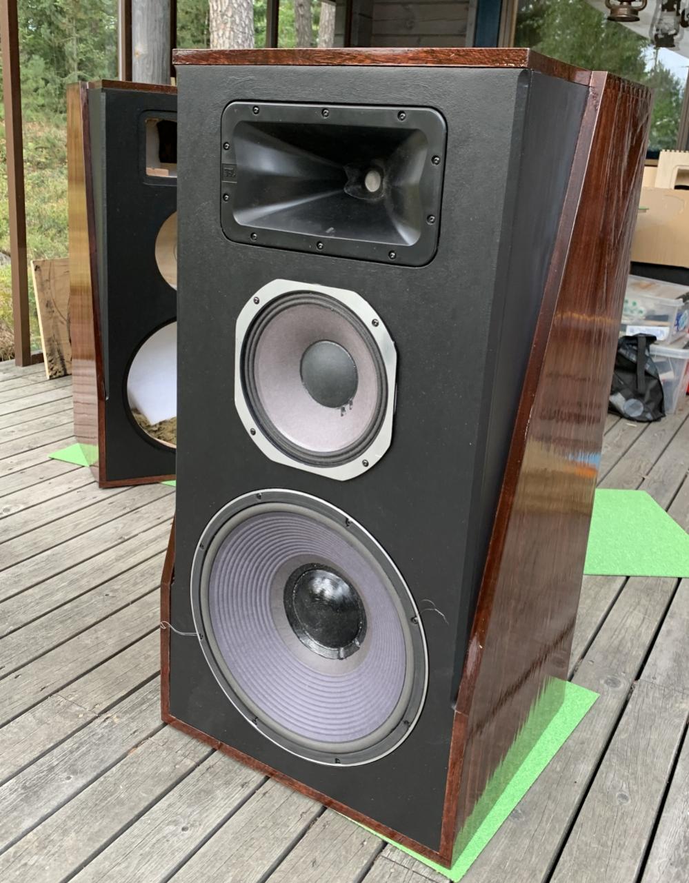

jmpsmash, don't compare closely our measurements as we might have different smoothing. The room is of course also doing its own to the curve.
XO hi-pass for STX is 1000Hz and low-pass for JBL 2123 is 1200Hz. Both LW 48db.
XO between 15"woofer and 2123 is 200Hz LW 48db.
My FIR processor (Najda) is running only 1000 taps so I don't get what I design. So I seek the best solution by iterating and measuring the result.
So my XO point is working but can seem odd if you have not done digital filter tuning. I mean that when you can try whatever you want and confirm by measuring then you can find solutions that many would not have thought of.
My speakers are sounding absolutely great at the moment. But it is a very small adjustment that makes a speaker sound good.
I don't think you make the speaker sound nice by switching drivers. At least not when using professional products like JBL.
The drivers and the box are the foundation to build on. Then you tune it by first timealign, then do the driver linearization, then seek XQ points and after this the real effort starts when EQing.
So I think that if you can solve how to fill the hole between the horn and the woofer then that is a solution that takes out a lot of effort from the project.
And this is probably why the M2 is a 2-way.
Is the M2 horn imaging better than the VTX. I don't know, maybe probably.
But whatever horn you choose will benefit from tuning. And the imaging is also changing when tuning as it alter also the frequency balance of the reflections in the room.
One more point. My 2x 15" 2235 (2225 recon to 2235 with the ring) are playing down to 30Hz in the closed box. But I did feel that there was not that kick drum and deep bass guitar I wanted. So I did add two 12" subwoofers that play about as low as the 15" speakers.
There was some gain but not much. So I did work to get all four speakers' time aligned.
Did three sessions. Measure -> adjust timing -> measure -> adjust and so on. Still no improvement. Then once more and it completely changed the whole system.
So one must enjoy the ride and not wonder when the trip is coming to an end as there is always something that can be done better.
