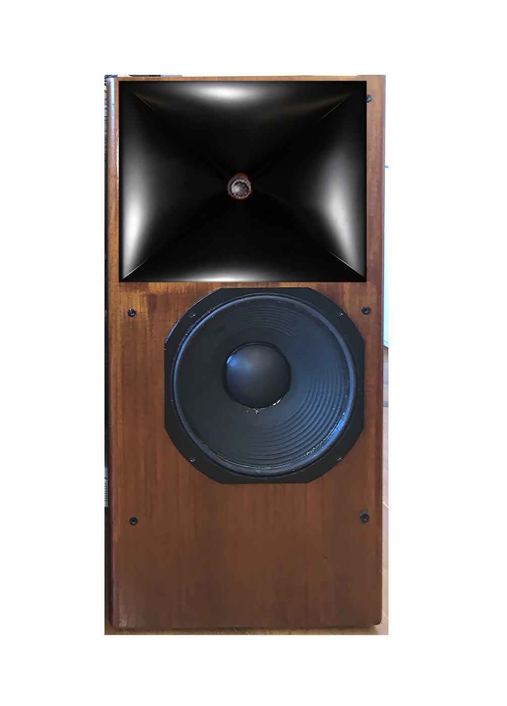

Ok, I've been wondering about the crossover frequency. How high could the LE14-H cross, I wonder?Pth horn (i use older but had the newer), wouldn't cross it below 1.2khz
12" wide and 3" deep, both of them.
Horn in 821 looks like it (pth square horns).
I've read quite a bit of your trials too, very grateful to read your experiences!
"Horn in 821 looks like it (pth square horns)" - don't follow you here?
Around 1kHz ±a wee bit if you want to match up with a 90° waveguide.
The venerable QSC/B52 14"x10" waveguide would work nicely, if you can find one. There are many 1" CDs that can cross at 1kHz for home hifi applications (and Radian model, B&C DE250, either of the 2 Peerless models, many others I'm sure).

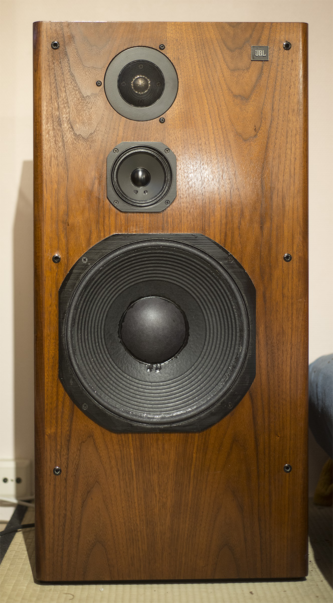

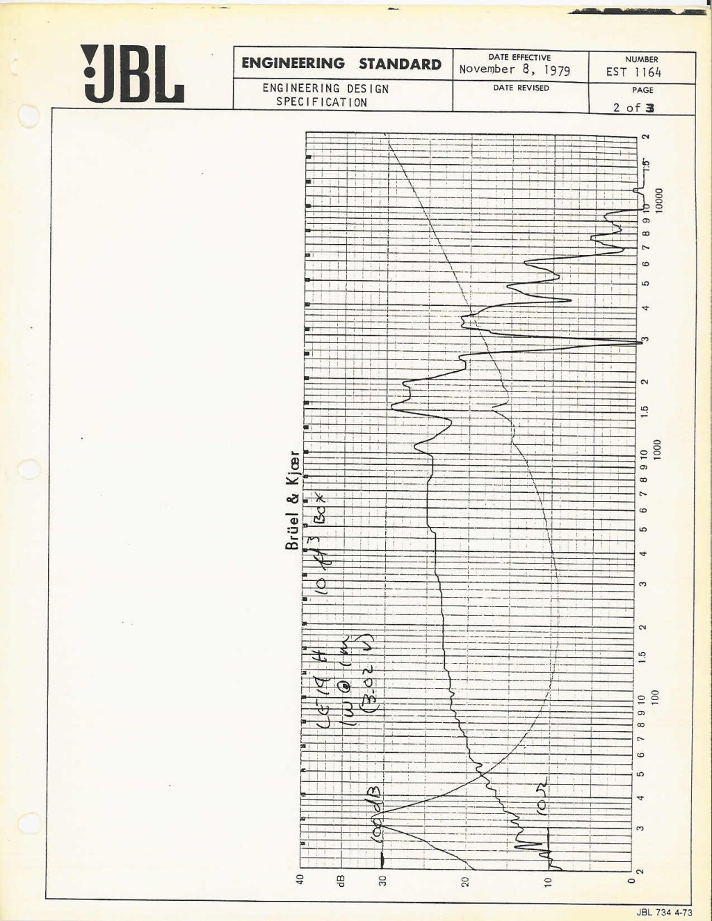

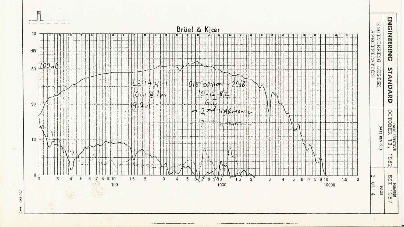

Yes, the LE14H was used in the 240Ti and more known 250Ti. The 240Ti network crosses at 900hz, so I guess the rule works. Of course, the question I should have asked was: how high can they play? I happily found some documentation on them at audioheritage, and it seems 1.2khz is within capabilties of this woofer? In it's original state the 240Ti is three-way, with 104h mid and 044Ti tweeter.
The 044Ti has a foam damping plug behind the titanium dome (as many know), and it deteriorates over time, crumbling and shrinking. There is no replacement driver, but there is a DIY fix. Risky, (but maybe mostly from an inexperienced POV). Dismantling and reassembly is difficult, and if I break it, replacement will be hard to come by and will also need service. The LE14H woofers are blowing me away on a daily basis, and was refoamed last year so are in excellent condition. I love the wooden finish and size is good. That's why a rebuild is tempting to consider carefully.

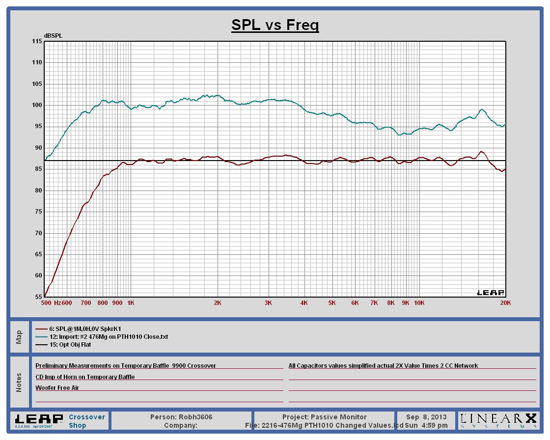

I also saw the attached FR plot from Rob, which looks impressive to me... I took the liberty of reposting, hope it's ok by you Rob
. Also a picture the 240Ti in current, original state.

So this leaves us with the question of which driver and horn to mate with the LE14-H woofer. And where to put the crossover frequency.
Here is a link to LE14H-3 driver tech info.
Here is information that shows that 240Ti has a crossover point at 900Hz.
So now the easy answer to witch horn would be the M2 horn. But it will not fit in the box.
So maybe one solution would be the JBL VTX F12/F15/STX825 horn that I have used. I however don't have a driver that can cross below 1000Hz. But there is forum writing to find where this horn has been used down to 800Hz with some of the 245X drivers.

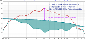

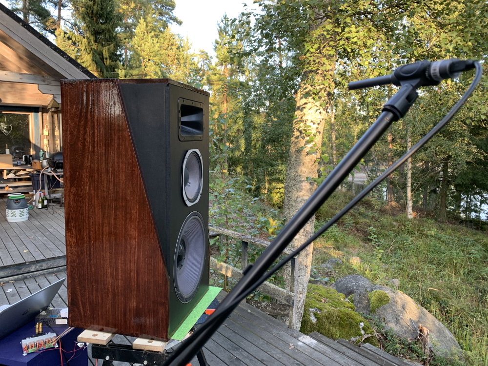

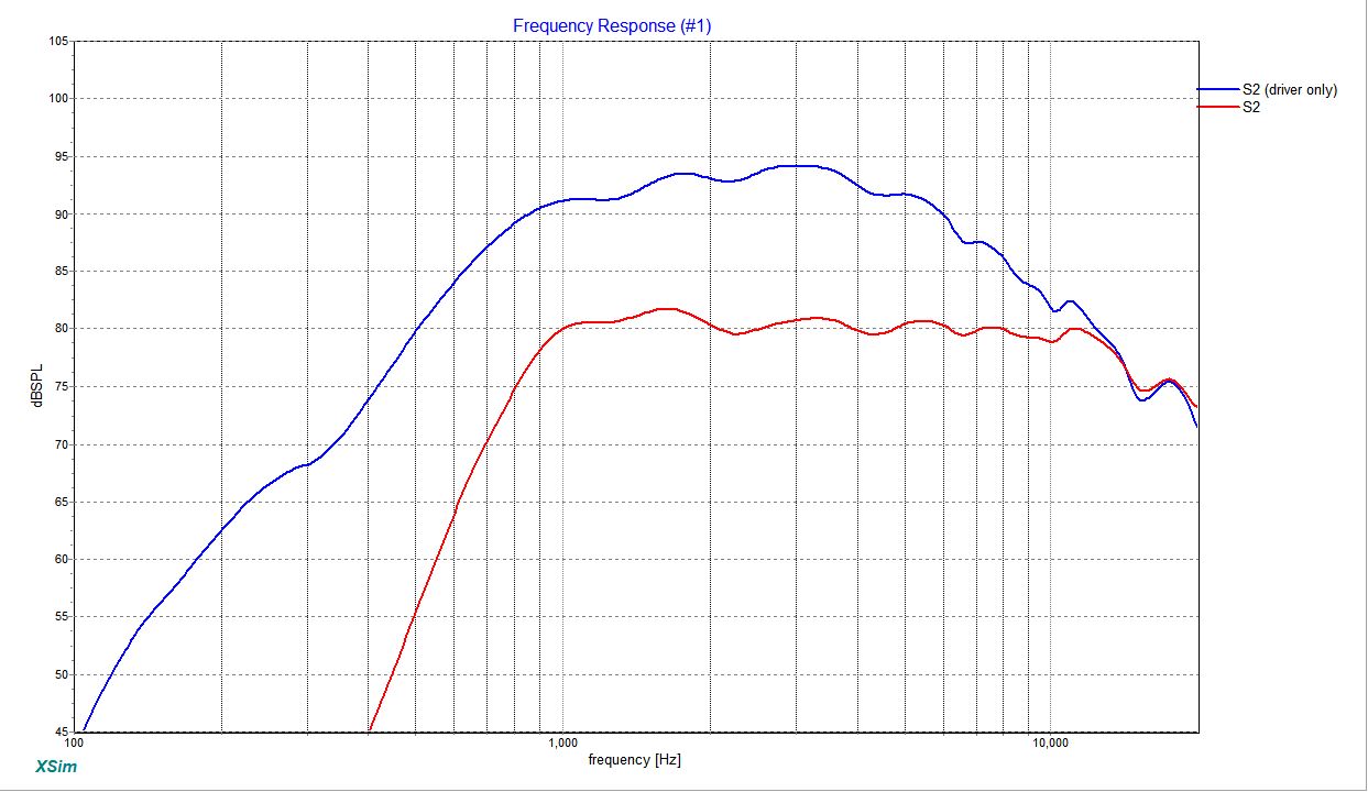

I tried the D2430K driver + STX825 horn. It has a gradual drop on the highend from around 3.5kHz onwards. This will require either massive amount of EQ from active crossover, or an elaborate passive like the one in the JBL 4367.
Here is the measurement. Blue is the raw D2430K+STX825. Red is simulated via Xsim using a tweaked version of the 4367 passive crossover.

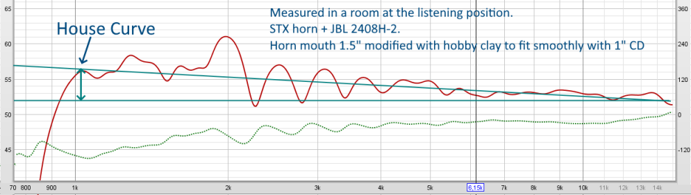

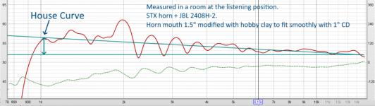

Here is the measurements I have done with the STX horn.

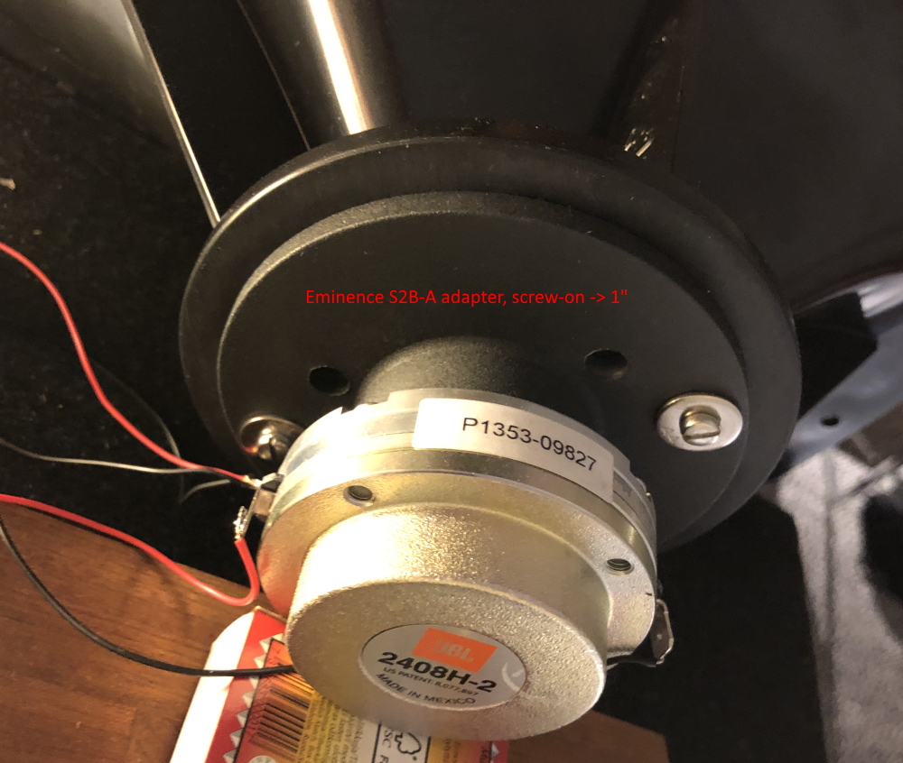

I'm using the 2408H-2 1" driver. It can not go as low as the D2430K. But it works well in my setup when I'm using the mid-woofer JBL 2123.

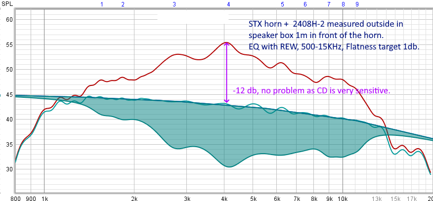

Look at the pictures that show that you can get very good performance by EQing, This is standard procedure when tuning professional sound systems.
I'm using FIR digital filters but you can get good results with IIR filters also.
I use REW EQ to produce IIR filters. Then I import these into rePhase where I can finetune frequency and phase response. rePahse will produce the final FIR filter.
When tuning I iterate 20 to 100 times -> EQ measure -> REW QE -> rePhase ->filter uppload into EQ prosessor -> EQ measure -> REW QE -> rePhase ->filter uppload into EQ prosessor ->->->->
It is not that you can not get a good result quite fast. But when you realize all the possibilities you have you will get the HiFi tuner bug.
Many thanks for posting this measurement. It is obvious that the D2430K is the driver that I shall order and use with the STX horn in my next speaker project.
Looking at the measurement I think that you can after EQing easily cross over at 800Hz.
Anything higher will mean that you get an uneven dispersion curve to the sides. The VTX horn has an almost even curve 90 degrees to the side. So you don't want that the woofer starts beaming.
