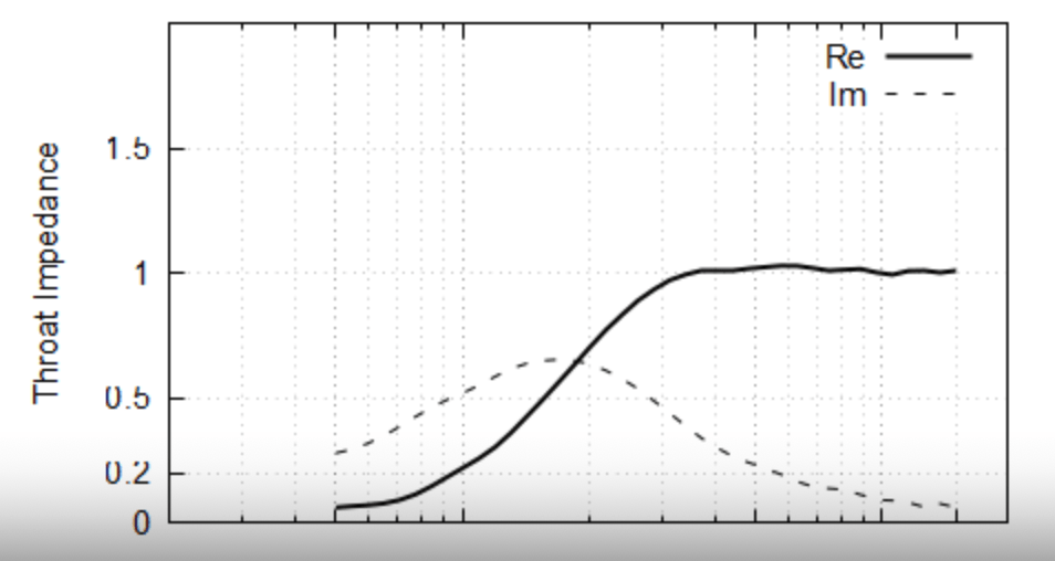

Bjorn Kolbrek can provide someFluid, would you mind to share some more of your insight around the impedance graph and its impact on the contraption, please? The real and maybe in particular the reactive part and how they effect things.
"Both exponential and hyperbolic horns have a property called cutoff. Below this frequency, the horn transmits nothing, and its throat impedance is purely reactive. But what happens at this frequency? What separates the exponential and hyperbolic horns from the conical horn that does not have a cutoff frequency? To understand this, you first must look at the difference between plane and spherical waves. A plane wave propagating in a uniform tube will not have any expansion of the wave-front. The normalized acoustical impedance is uniform and equal to unity through the entire tube. A propagating spherical wave, on the other hand, has an acoustical impedance that changes with frequency and distance from the source. At low frequencies and small radii, the acoustical impedance is dominated by reactance. When kr = 1—i.e., when the distance from the source is 2 λ π —the reactive and resistive parts of the impedance are equal, and above this frequency, resistance dominates. The difference between the two cases is that the air particles in the spherical wave move apart as the wave propagates; the wave-front becomes stretched. This introduces reactance into the system, because you have two components in the propagating wave: the pressure that propagates outward, and the pressure that stretches the wave-front. The propagating pressure is the same as in the non-expanding plane wave, and gives the resistive component of the impedance. The stretching pressure steals energy from the propagating wave and stores it, introducing a reactive component where no power is dissipated. You can say that below kr = 1, there is reactively dominated propagation, and above kr = 1 there is resistive dominated propagation. If you apply this concept to the conical and exponential horns by looking at how the wave-fronts expand in these two horns, you will see why the cutoff phenomenon occurs in the exponential horn. You must consider the flare rate of the horn, which is defined as (rate of change of wave-front area with distance)/(wave-front area). In a conical horn, the flare rate changes throughout the horn, and the point where propagation changes from reactive to resistive changes with frequency throughout the horn. In an exponential horn, the flare rate is constant. Here the transition from reactive to resistive wave propagation happens at the same frequency throughout the entire horn. This is the cutoff frequency. There is no gradual transition, no frequency dependent change in propagation type, and that’s why the change is so abrupt."
"The OS waveguide does not have a sharp cutoff like the exponential or hyperbolic horns, but it is useful to be able to predict at what frequency the throat impedance of the waveguide becomes too low to be useful. If you set this frequency at the point where the throat resistance is 0.2 times its asymptotic value30, so that the meaning of the cutoff frequency becomes similar to the meaning of the term as used with exponential horns, you get 0 c t 0.2c sin f r θ = π (24) You see that the cutoff of the waveguide depends on both the angle and the throat radius. For a low cutoff, a larger throat and/or a smaller angle is required. For example, for a 1″ driver and 60° included angle (θ0 = 30), the cutoff is about 862Hz. The advantages of the OS waveguide are that it offers improved loading over a conical horn of the same coverage angle, and has about the same directional properties. It also offers a very smooth transition from plane to spherical wave-fronts, which is a good thing, because most drivers produce plane wave-fronts."

Thanks a bunch fluid!
That answers quite a few questions that have been debated many times on the forum. I'm not sure I can completely and fully understand all aspects of it but it helped me quite a lot (I hope).
Would it be fair to say that as a horn/wg gets reactive, the driver is moving but the pressure energy gets produced and consumed within the horn/wg and nothing gets out of the system? That a wg with Re 0 and Im=1 would be silent?
Looking at one of these:
Is it possible to read out the CO freq?
Below the CO, it would be like the driver was without a WG and no directivity control can be offered by the WG?

No, not really. It depends a lot on the capabilities of a particular driver and the power requirements, whether is it for a home use or not.[...]
And it's not possible to tell what the directivity is based on the throat impedance alone - that's virtually unrelated.
Think of a woofer and how many times you looked at the acoustic resistance it radiates into - it's almost nil at the very low frequencies as well. That doesn't mean it can't reproduce those frequencies at high enough level, if it has the volume displacement capabilities needed. The real part of the impedance is never zero.
You're welcome.Thanks a bunch fluid!
I don't know that it would be a yes or no answer but horns with defined cutoff's become problematic at or below cutoff due to the rapid phase and frequency change.Would it be fair to say that as a horn/wg gets reactive, the driver is moving but the pressure energy gets produced and consumed within the horn/wg and nothing gets out of the system? That a wg with Re 0 and Im=1 would be silent?
According to Bjorn when the real drops to 0.2 from an asymptotic 1.0 that is the point where an OS throat impedance is too low to be useful. If the driver itself is still capable of producing the required SPL then that becomes a moot point.Is it possible to read out the CO freq?
In loading or output terms maybe but as mabat says directivity is not linked directly.Below the CO, it would be like the driver was without a WG and no directivity control can be offered by the WG?
