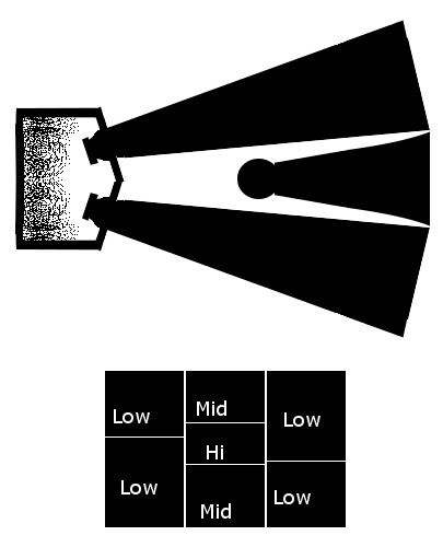

I have an alternative idea that I've been kicking around in my head a while. It is also quasi single point with multiple drivers. The engineering would be less fiddly than trying to get many drivers into a tiny throat, or trying to clone a Unity.
Simply do this: DIY a multicell, but use 1 driver per cell.
Middle cell: driven by a small compression driver selected for good HF performance.
Flanking cells: use conventional drivers, to cover 300-3kHz (ish).
The main criticisms of traditional multicells* seem to be comb filtering (lobing) and cost (difficulty) of construction.
My idea would reduce these problems: less lobing by only having one cell do HF. Construction could be much simpler** than a 'normal' multicell, as all the flanking horns could be very basic, conicals with rectangular cross section.
*Based on the writings / comments of others. I have not experienced a good multicell.
**I'd be tempted to make the actual construction as simple as possible, but layout more complex.
  1. use an off the shelf horn for the HF
  2. DIY conical horns for the rest
  3. use fewer horns, but more drivers (push-pull loading) for the lows
  4. vary the size / orientation of the flanking horn mouths, so their artifacts don't all pile up at the same frequency
I've attached a roughly done but hopefully clear picture. Yes, it would need HF delay, if built as pictured. Mini DSP to the rescue 🙂
I would say thew main advantage of the driver everyone is intending to copy here is that it offers wide bandwidth and good power handling without having to resort to things like multiway arrangements and any sort of delay for proper integration etc.
If it can really be had for the price that is shown on Speaker Exchange then the only reaon to try to DIY something similar with a different topology is curiosity IMHO.
If it weren't for that seldom used throut exit size I would have ordered a pair for a three way right away.
Regards
Charles
