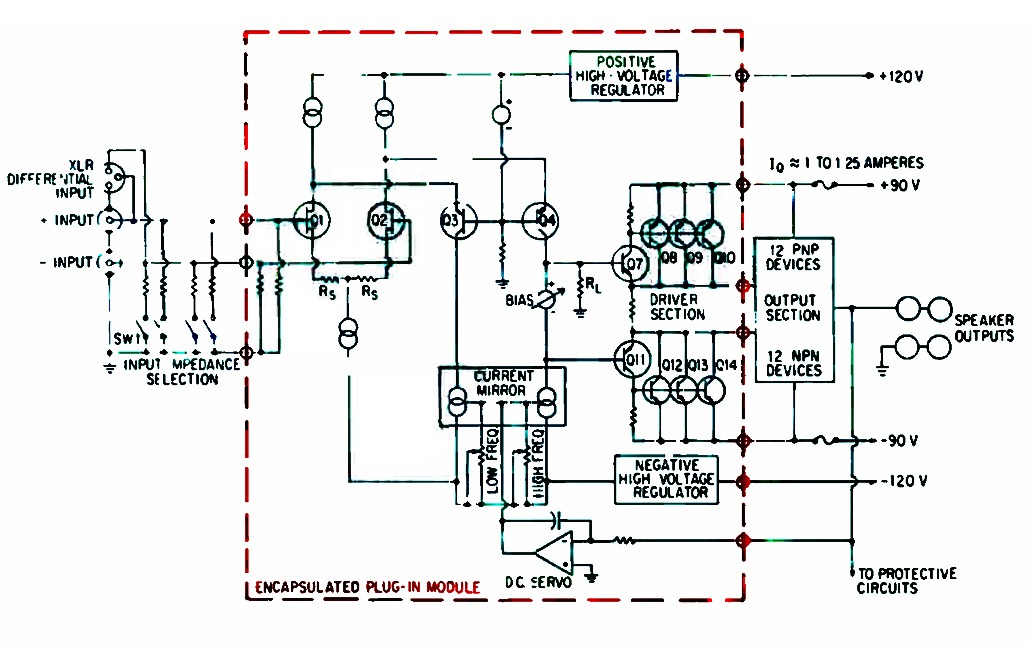

Why can't we find anything about the Model 1 regarding the schematic or service manual while it is possible to find schematics of other Rowland amplifiers?
perhaps nobody is willing to sacrifice a working amp to (very likely) destroy the module by opening it, displaying its contents and tracing out a schematic.
also, maybe Rowland wants the alleged faulty module returned if someone claims they need a new replacement to fix an amp.
no facts; just guessing at possibilities ....
maybe....but it is not the content of the module that can arouse curiosity, but the electrical diagram or at least the correct polarization values of the bias that not possible he cannot know or find anywhere on the web.
From what I have read or what is hypothesized (but the source of information is not certain) it seems that from the beginning to the end of the production of Model 1 there were so many changes that never an released and was never made official and definitive the version of the schematic diagram.
