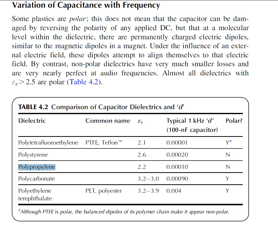

Mr. Morgan Jones's book is also a very good reference. The differences between PTFE and Polypropylene are really small. I tried them before and they are very good but more costly and they tend to be larger than polypropylene film caps.
From Valve Amplifiers, 4th edition, page 267:
"As can be seen, the use of paper or polyester capacitors in valve amplifiers can only be justified in areas such as power supply decoupling where their capacitance deviation with frequency is irrelevant. Although not shown on the graph, electrolytic capacitors are even worse, and their 1 kHz capacitance is typically -10% compared to their DC capacitance."
I highly recommend Morgan's book.
