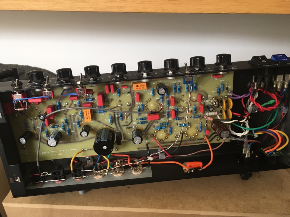

Actually I am pretty upset with Tube Depot. I got all new tubes for the head, 2 Tung sol 12ax7 for first two tubes in the preamp as I remember I used to like them before, 3 rest are JJ and 2x JJ el84. I already commented on matching of el84, but what is most upsetting that it looks one of the tung sol tubes is bad. I had this fizz and weird foreign sounds coming of the amp and I've checked everything. So neighbor of mine had two old tung sol in his closed. I swapped mine pair and weird sounds went away. I swapped JJ into same place and sound I good again (more gain and compression with JJ, but with no fizz or foreign sounds). I guess not buying from them anymore...
Just to bring up to this discussion (monologue mostly, but whatever hehe). I finished with my amp. Re-did some chassis wiring as it was a bit messy, changed poly caps to Wima(most I end up having in my stash), brought all values in the preamp section to the ones in SLO and added some switches from SLO schematics.
Amp sounded great! Next I what I did I increased those caps in PSU filtering. First 47uF —> 150uF and two 22uF —> 47uF. The result was controversial I must say. The bottom end and overall sound became more tight, even. I absolutely love it on hi-gain settings, so great. However, in lower gain/crunch-clean sound amp lost some of the dynamic range and that tube character to react to how hard you pick. I does lack some of the sponginess on crunch channel now. Do you think it is possible to have both? 🙂 what if I change values of those 47uf back to 22? Or anything else?

From too-long PM> 300-320 would be a sweet spot for the power tubes. However, slo100 preamp need 360V

thank you! I do not quite get it yet, but I will read about it.
Another thing, I see that I was mistaken and the amp is actually fixed bias, right? So I can just drop the voltage of B+ and screens "manually"
