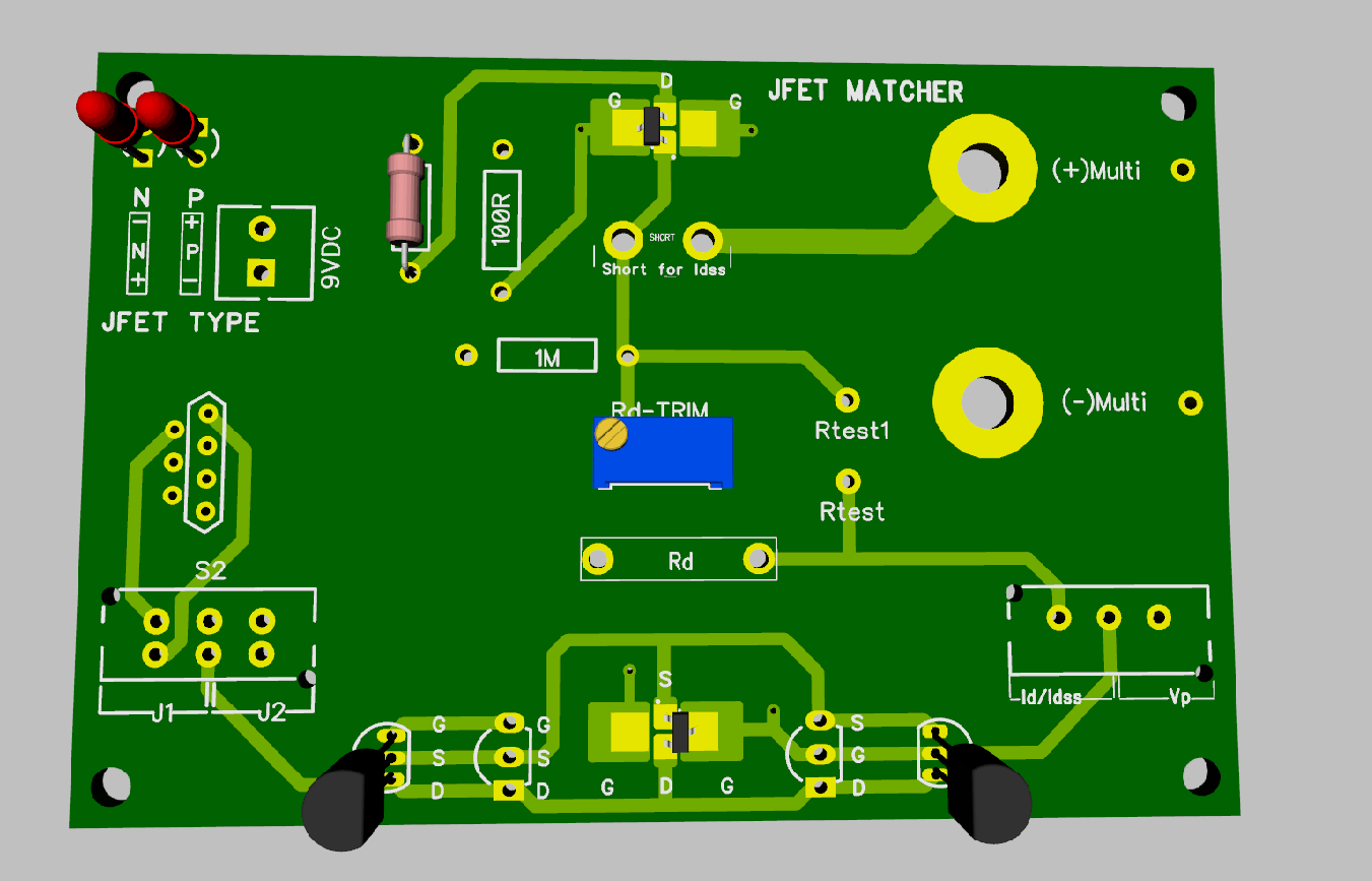

here is the new design.
It includes through hole straight pin Jfets and dual jet matching ability,in case you find some.
Option for banana clip for multimeter.
option for trimmer resistor and if used can skip the jumper altogether.
