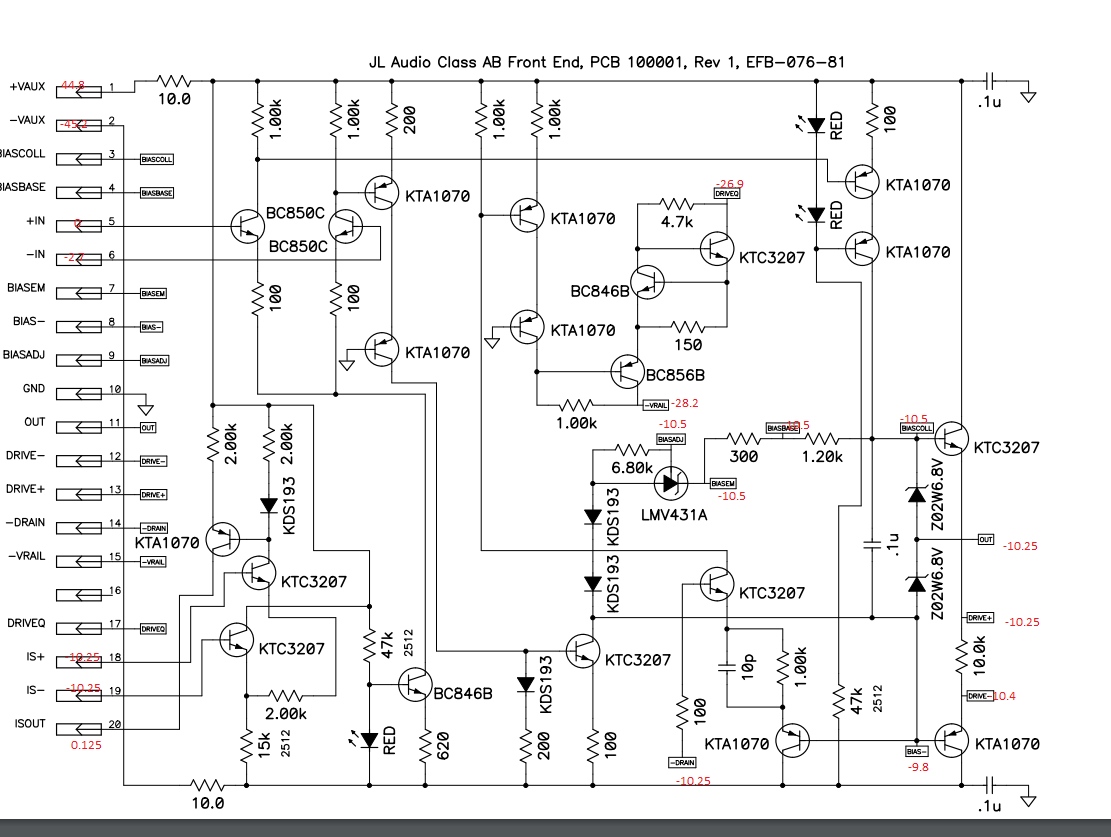

Yes I checked all junctions and none of both transistors was leaking.
By desoldering the LEDs the voltage did not changed.
I decide to reflow all transistors and replace the LEDs again, and now all 3 LEDs lit up, and nothing getting abnormally hot but i'm still having 11 DC volt at speakers terminal and voltage to those 2 transistor changed.

Did you confirm the connections of those two transistors with your meter to confirm that they were the two 1070s next to the series connected LEDs?
That would mean that the collector of the top 1070 would have its collector directly connected to the emitter of the bottom transistor. If so, their voltage would have to be identical. They are not for the numbers you posted.
Also, the bottom 1070 has a Vbe of 10v. That means that the b-e junction is damaged.
Top transistor collector : 31.10VThat would mean that the collector of the top 1070 would have its collector directly connected to the emitter of the bottom transistor. If so, their voltage would have to be identical. They are not for the numbers you posted.
Bottom transistor emitter : 31.19V
If I mesure both quick enough, I mesure the exact same voltage across both,
As amp heating up the voltage changes a little bit and by the time I measure and note each voltage the voltage has slightly changed but, top collector and bottom emiter are at same voltage.

I just found that 100 ohm resistor for the top transistor has blown open when I have powered the amp on
That might be me writing it wrong for you. I was writing voltage with the pin layout of the "transistor facing to me"The pin configuration os ECB. That's C-B, not C-E as the diagram shows.

The resistance of pin 2 top transistor and pin 1 bottom transistor are 0.001 ohm at my multimeter, so it's connected together.
Sorry about that. Does it make more Sense?
You need to look at the face of the transistor, legs down, post left to right.

I was wondering why pin 6 (in - ) was at -11V since it has no input, so I tested both transistors BC850B who tested ok, but I found that at the 620 ohm resistor, one side of the resistor was at -45V and the other -35V and varying a little bit. I tested the transistor BC846B which was ok, tested the resistor and it was okay too. I decided to reflow that resistor and I saw that it was broken in haft, I wonder why I was still reading 620ohm at my multimeter. I replaced that resistor and that was it. No more -11V at speaker terminal and the amp working perfecly fine now.
Thank you Perry and Moer for the diagram, that was helpful.
I have a last question, while replacing the resistor, I did melt the plastic casing the 0.1uf cap, it still work fine but I will replace it for peace of mind. Do you know the size / lead spacing for it? I don't have anything to mesure it right now.
Pin 6 is feedback from the speaker output and will have approximately the same voltage as you see on the speaker terminal.
